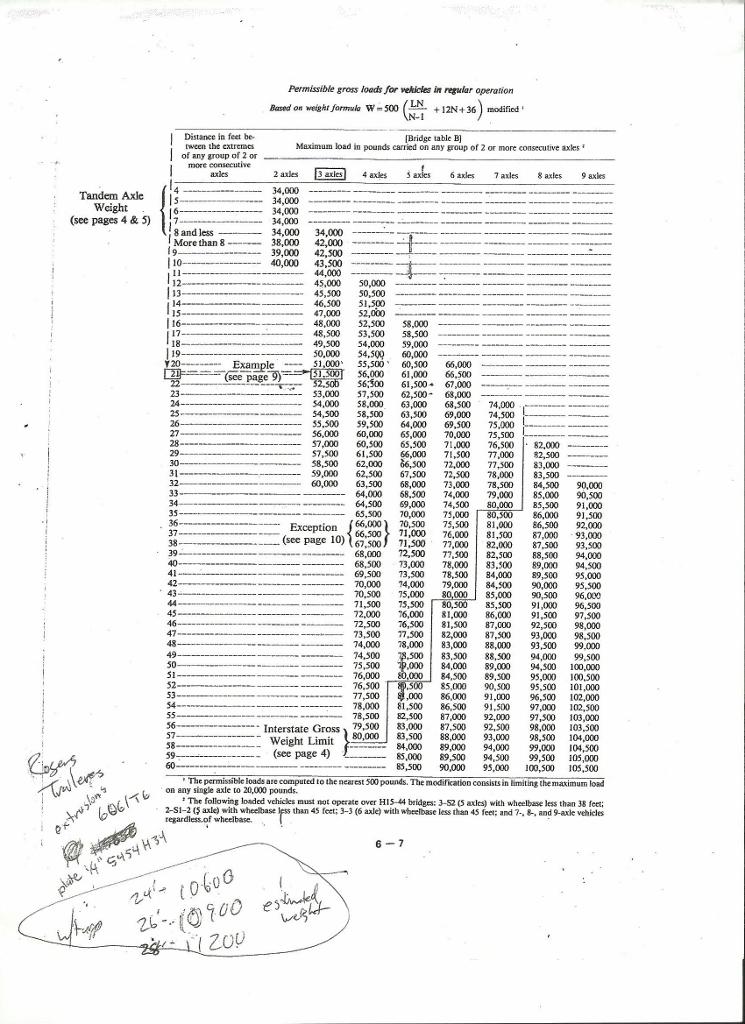

Dont paint the spokes a different color than the frame they are supposed to match, the wheels I always painted gray or white, gray is easier to keep clean silver isnt bad but not kentucky chrome silver more like medium silver mettalic car paint would be ok. as far as RB, you need length for bridge law to get your payload on the interstate, you have to have 51 feet from the center of your steer to the center of the rear axle to make 80,000 on 5 axles it takes 41 feet to make 73,500 so using a setback axle tractor kills your profit. I know there are some guys here that have 26' aluminum dumps and daycab T800's, they were trying to get more payload and decided to add two tag axles to their trailers to get to 80,000 but everybody told them the weight of the axles would cancel it out just haul 73 and be done with it. I am sure you see where this is going, they added two steer tags to each trailer and aluminum wheels and tires and guess what, they could gross 80,000 but they added 5,000 lbs to their trucks so now they haul half a ton more and run at 80,000 instead of running at 73 and getting better fuel mileage and being easier on the trucks, oh well live and learn. heres a bridge law chart use it wisely......

Its a little differnt here in illinois. You can leagally haul 72000 on a short tractor/trailer combination. You could add axles to your tractor or trailer and it will not make a damn bit of difference. You also need a SHV sticker from the state to do it, otherwise they take you down to the federal bridge formula which would only give you 66K or 68K (dont have the Illinois chart here). This would be why you need your truck to as light as it can be with out it working against you. 500# every load on a tonnage run really adds up. -Brad
The bridge law formula above is federal its for any federal highway,in tn on secondary roads we can run 74000 on a Tri axle dump and 80000 on a quad or dump trailer regardless of length. The r model above was legal for 56500 on federal highways but 74000 everywhere else. I know 500 adds up I've been around dump trucks for 18 years, sometimes the benefit doesn't outweigh the cost, if you found a truck with all the parts needed to swap for cheap its not that bad but when you get into, hubs,bearings,races,brake shoes,drums,wheels,etc, it gets expensive.

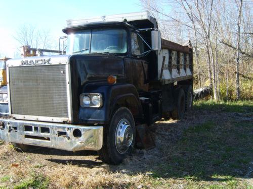

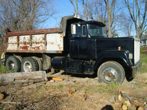

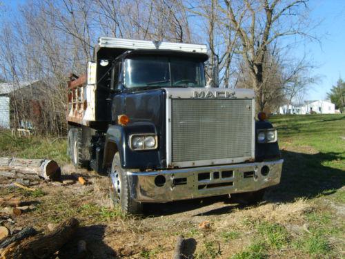

Here are some pics of an older R converted to a sort of a mini Super-Liner.I like to call it a R C RWS (in B C R fashion):post-510-0-53783600-1356797040.jpgpost-510-0-04769600-1356797079.jpgpost-510-0-37302300-1356797113.jpg Different strokes,for different folks!
