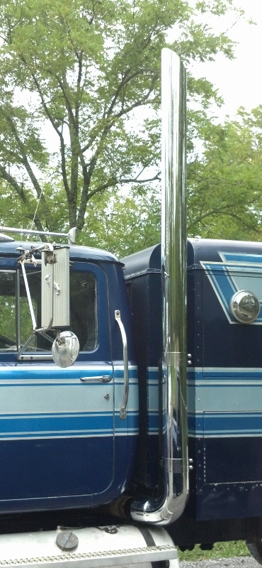

post-8009-0-48361800-1352771278_thumb.jppost-8009-0-87742200-1352771381_thumb.jppost-8009-0-04351500-1352771485_thumb.jppost-8009-0-30151800-1352771610_thumb.jpI neede all new exhaust for my Superliner.It had dual 4', I wanted 5".This wasn't availible thru Mack.The original was in bad shape, pieces missing etc.I sent the old pieces with sketches and dimensions to Grand Rock in Painesville,Ohio. In 2 weeks I had everything I needed. Everything fit like factory.
I wish I had seen this earlier, the E9 trucks had 5" exhaust the E6/E7 trucks had 4", I had a time finding the parts for mine so I just used a generic y pipe and some elbows and made it myself, but you could have used the E9 p/n's to get your y pipe and elbows then you would just have had to get the downpipe off the turbo for the E6/7 since the E9 makes a 90 towards the drivers side to go to the turbo mounted behind the engine sideways by the firewall. I was told by a friend at chrome country after I got done that he could have gotten it all from Grand Rock for half the price of OEM parts but I was already done and I used 6" elbows under my cab so my 5" stops up under there a few inches and I would have had to make that fit anyway, but such is the way with making changes like 6" stacks and elbows.

Looks monumental !
