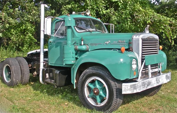

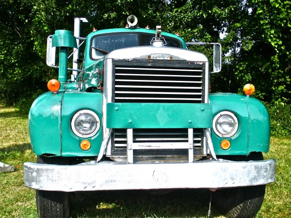

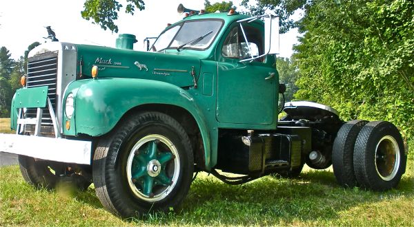

Ok i got the B75 2 days ago. i will take pics nd post them soon but i have a few questions. it has 4 6 volt group 4 batteries on it that are stone cold dead so i roll start it to get it running. Truth is i dont really want to buy $500 worth of batteries for it replacing them, A friend told me that i can replace them with 2 12 volt group 31 batteries. Do you guy know if i can do that? or what are your thoughts on it? Also for all of you guys in CT, how did you register your truck? Did you get early america plates for it or just register it normally? And you had to get it inspected then correct? not just a vin check.
I run two 12 volt in all my trucks. We don't have many mornings below 30 degrees. The local Mack and KW dealers have had 950 CCA for $79. If your truck still has a 24 volt starter, you will need to install one 12 on each side. That is basically what you have now with two sixes wired in series to make a twelve on each side.
Yes you can go from 4 6 volt batteries to 2 group 31 12 volt batteries a lot less money and easier to maintain I have done this on all three of my trucks

ya i always wondered what the not for hire on the door ment. i have my cdl so i am not worried about that but it seems like every different person at dmv has a different answer on what i need to do and how to register the truck. when i bought it someone told me that i didnt need to get it inspected if i got early america plates for it, turns out they were wrong and its my fault for not checking that out before buying it but its gunna take alot of electrical work and all new tires since they have cracks in them so its going to be a while before its on the road
