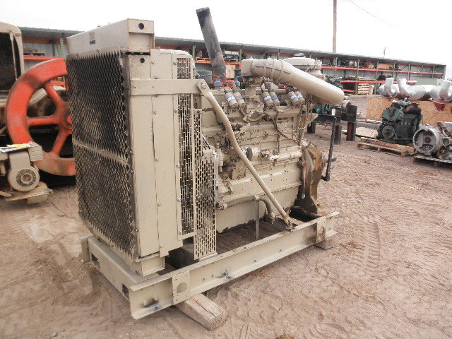

I have an 855 Cummins that runs on NG at work. It is not turbocharged but is connected to a 400kw generator. Loud SOB too. Where the heads are normally bored for injectors, this one has spark plugs and a magneto where the injection pump normally is.
