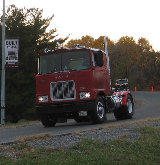

Paul you are right to say that is a nice F model, and thank you! It is a clean, good running 673P, so I hesitate to modify it in any way. Stay tuned, the turbo & fuel pump, etc. I have may soon show up for sale.
It was a lot of fun getting that picture, too. It was taken as I went a few laps on Mack Truck's test track at the old Engineering Center in Allentown 10/30/10. If you look close, my friend Bill is trying to keep up with his IH Emeryville!
