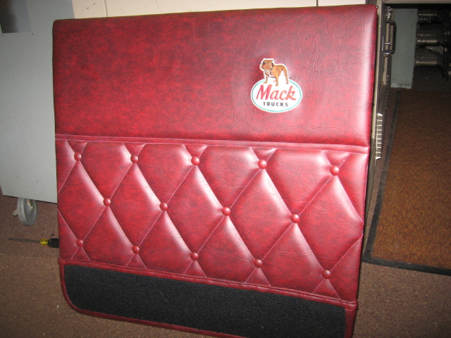

Since having back problems and basically being "laid up". I've decided to take up a bit of a new hobby; sewing. With a used sewing machine, some thread, a friends button maker, some carpet remnants, with another friends expertise who is pretty good at embroidery, and the help of a fabric store, this is what I've come up with for one of my RL series trucks. The truck originally had red interior so I've elected to stay that way. I'm going to try to to do the cab back panel next. Both of the door cards are finished, but I'll probably remake the driver's door card as I got a little crooked in my stitching. I made it first as a trial run. Both of the bulldogs face forward when installed. I couldn't easily get the dogs embossed as original, so I went this route.

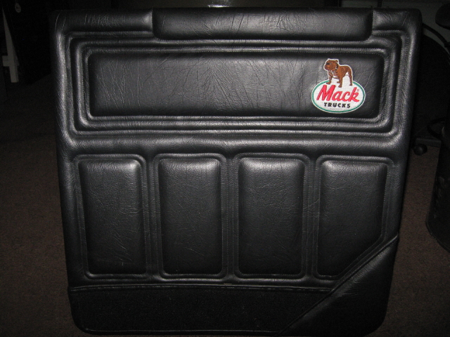

The black card is for my Project R-12. It has the standard silver/gray color full interior of the mid 1980's and I'm going to straight black for the interior.

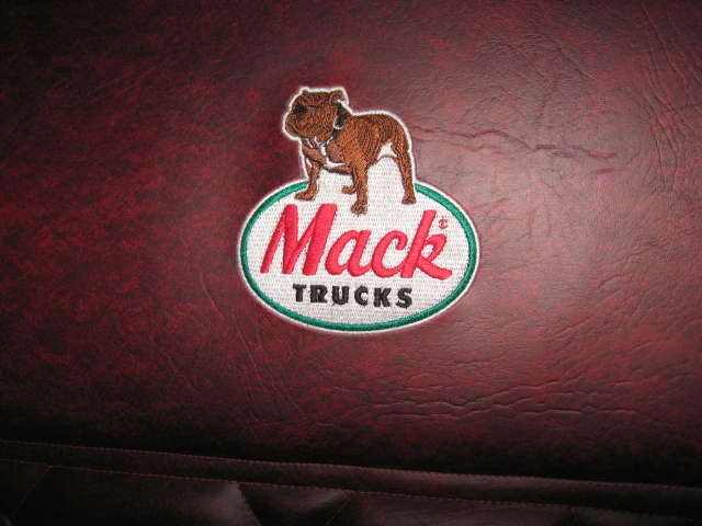

The "patches" are not iron on. They are embroidered through the material.
It took five runs altering thread counts each time to not "buckle" the material during the process.

Hi rob,this is indeed a nice looking job! i have a couple questions.....what did you use for the "backing" cardboard,thin paneling? can something like this be accomplished with a "normal" sewing machine or does it require some type commercial machine? reason i ask is that my wife is a pretty fair hand at sewing,and i have a few similar projects in mind. She just did'nt know if her machine would stand up to the rigors of upholstery. I did'nt realize the patches were embroidery either,but they sure look sharp!......mark
Hi Mark, the backer is what is called in some places, "Oil board" and other places, "cowl board". It is made for this purpose and waterproof. I have several friends that are into street rods and this is where the idea came to me from.
A household machine will not hold up to this. You need an industrial machine with a high punch force. I can't remember what size needle I was using as I went through so many and these are a couple of months old but I'll find out. The machine is a "Bradshaw" and came from a guy that retired from building interiors and convertible tops for years. It is all metal and very heavy. Also, completely manual in operation.
The embroidery actually started out as a decal. I have this decal that is about 12" wide, and 18" tall the dealers used to put on their front doors a lot. I had it digitized and my friend had it converted to a format his embroidery machines use. I have the dog facing left, and right. I have the seats for Project R-12 finished but I didn't do them. Another friend that does upholstery work actually made the seat covers after I had the material embroiderd over a year ago. I had a hell of a time getting the seats back. Unbeknownst to me, he wasn't paying his bills and a judgement went against his business, property, and everything in it!! I went to court three times to get my seats back!! With that behind me, I got to thinking that maybe I could do this myself so the saga started........

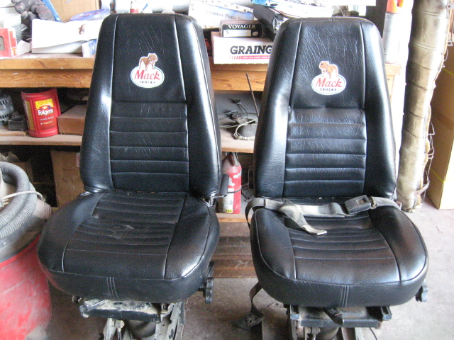

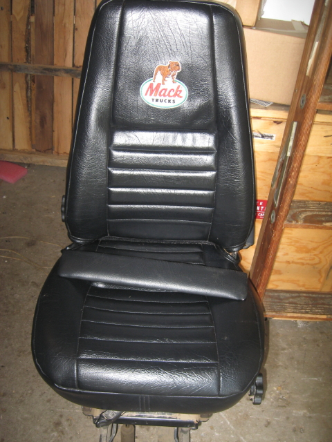

Here is my passenger seat and arm rest for Project R-12. The driver's seat looks the same with the exception of the dog faces left.
Rob

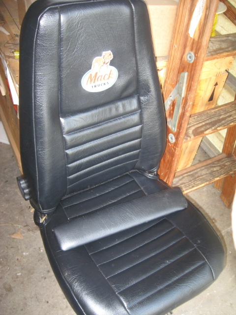

Here are both seats together. I didn't change the settings on the camera from when I was working with it earlier and didn't realize they were incorrect until downloading them.
I think the dash overlain with a nice pebble grain leather would look nice but would be expensive.......
Rob

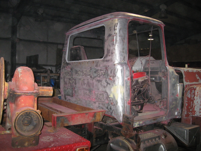

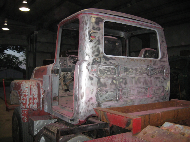

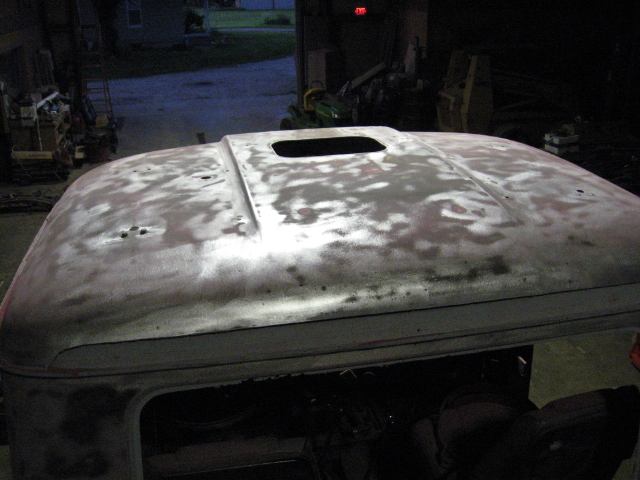

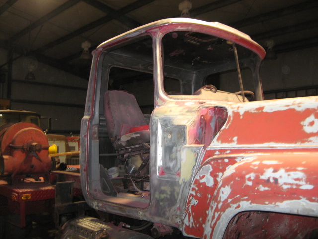

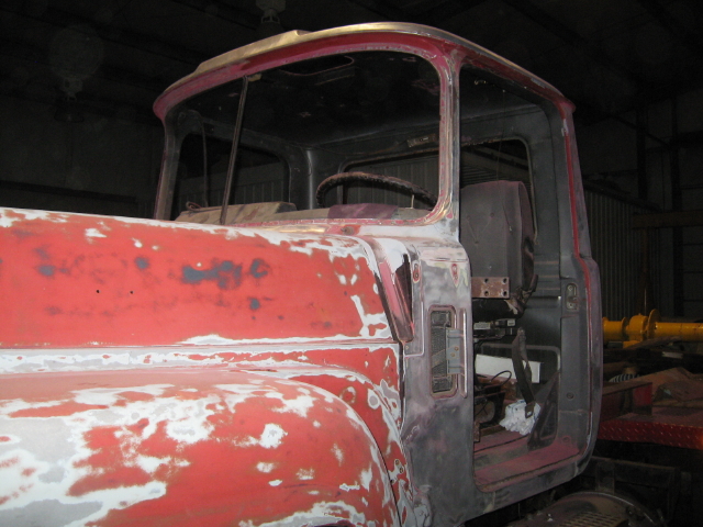

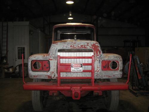

Now that I have my seats back I feel like getting a little done on the truck, (Project R-12). Got a little paint off the past couple of nights and a little left yet to do, then starting on the doors which are not rotted at all. I've found a few stress cracks in the cab that will need welded up but since I'm going to "back half" this one, I'll pull it.
Here's a little progress for six manhours. I usually leave this type work to a media blaster but the truck is not licensed, nor do I have a trailer to haul it. Been awhile since I've went the manual route.
Rob
