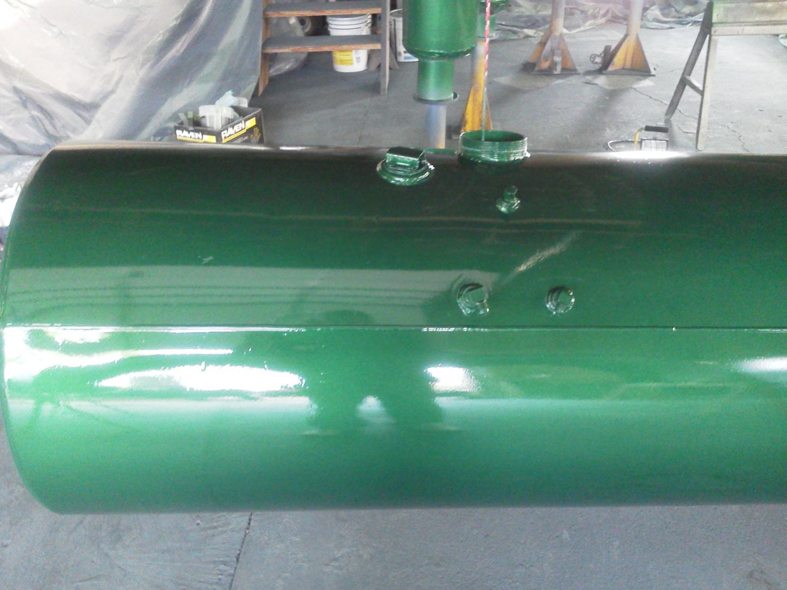

  1. From the album: 85 MH Restore
    Fuel tank painted. I rino lined the front and back later.

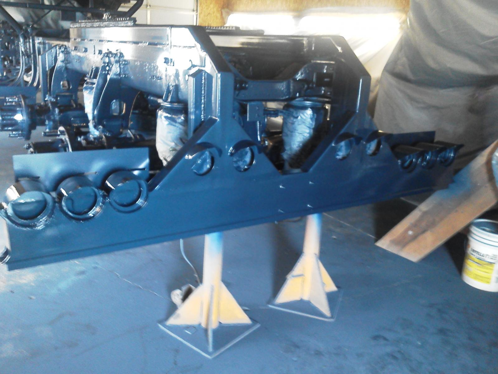

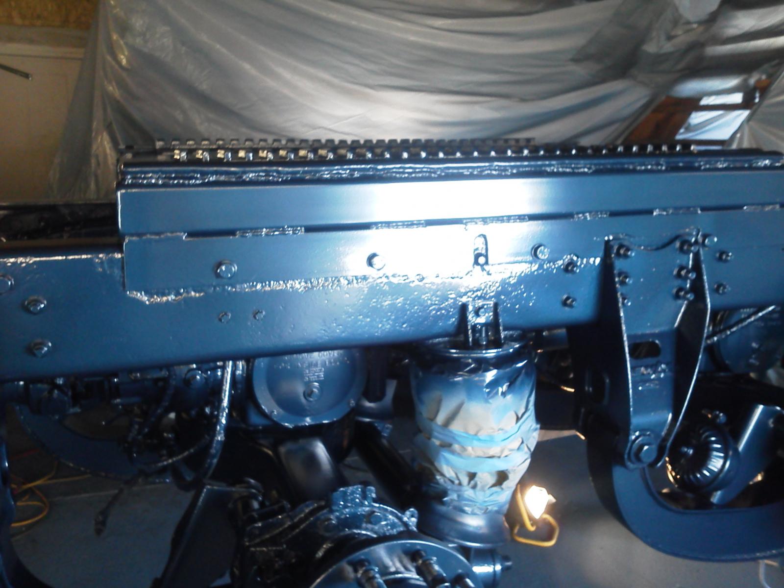

  2. From the album: 85 MH Restore
    Frame sand blasted and painted chevy indigo blue.

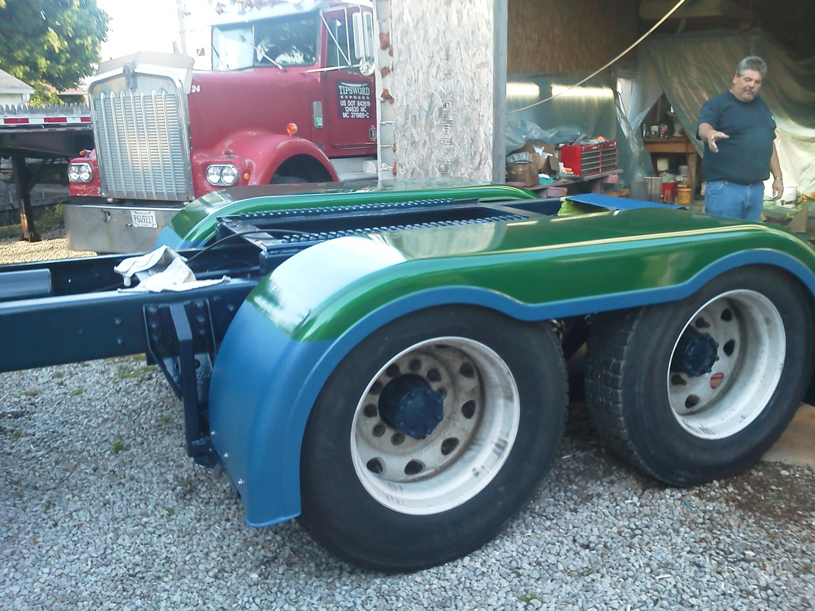

  3. From the album: 85 MH Restore
    WTI fenders rino lined on the front. Painted the new camaro Green

  13. Nope! KW wheels I do believe. Im trading em out with that red KW in the back ground...lol

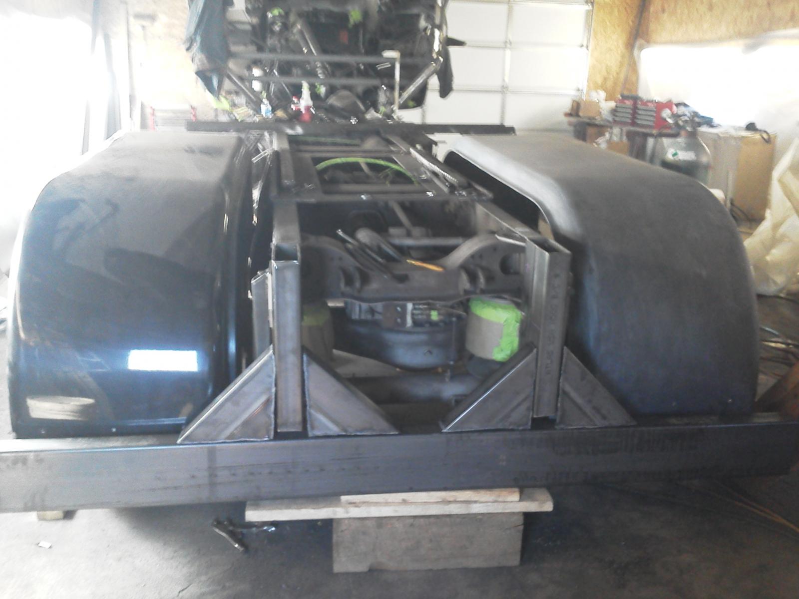

  15. just a painted up fuel before the rino lining. fenders mounted with the rino lining on.
  16. Some paint that I put on the frame and more later.....4 gallons worth lol...

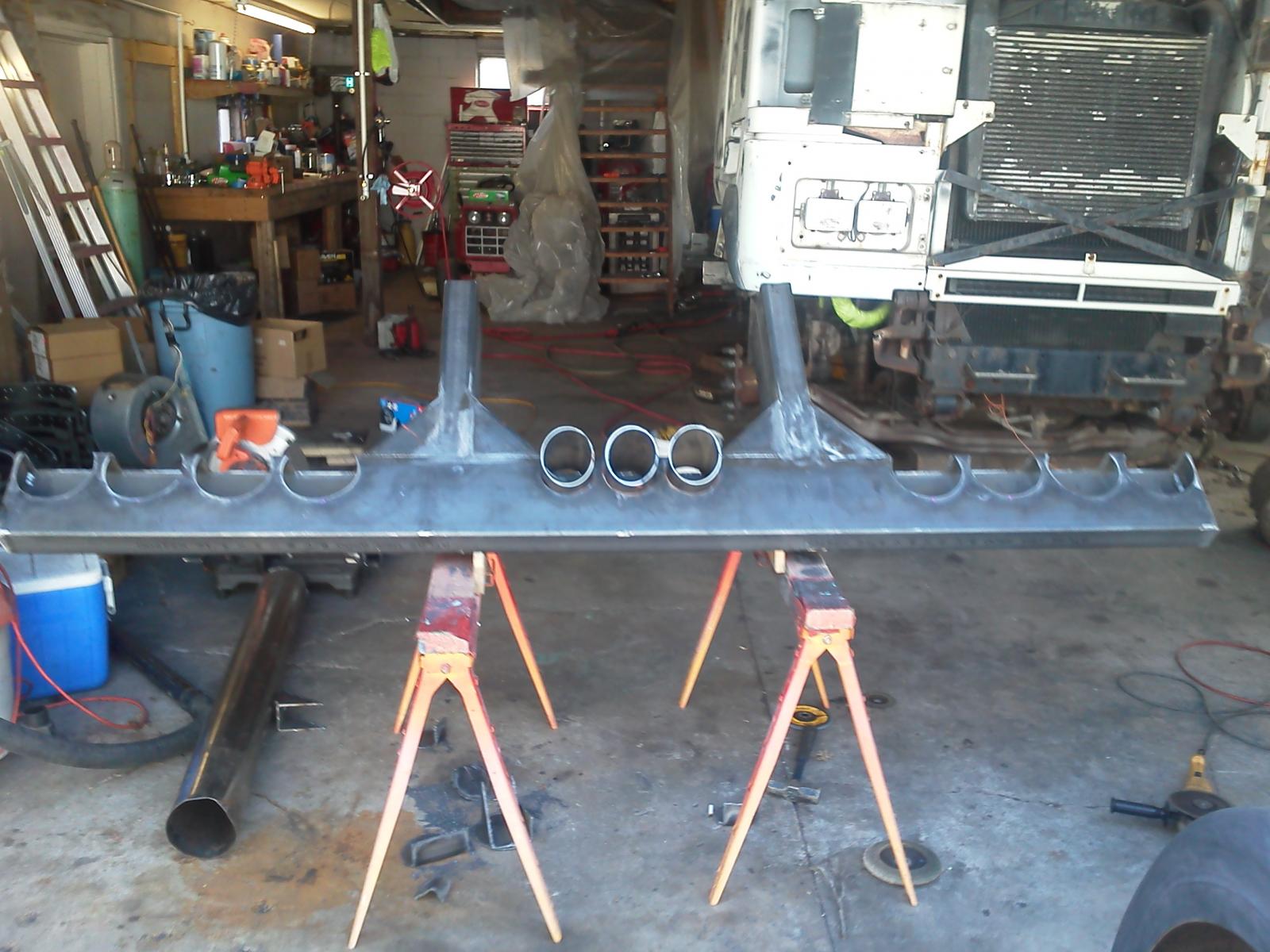

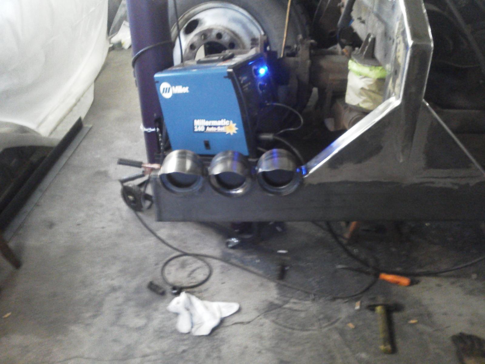

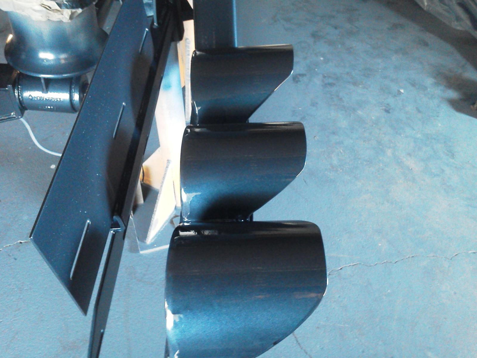

  17. They are hand made out of steel pipe. cut with a cut off wheel or a die grinder. Me and a friend are gonna start making them and selling them. they take a lot of time and patients. Lots of man hours.

  21. No its not a Magnum, but it does have the E9 in it. As for the light bar clearance issue. I cut the square tubing and notched it up into the frame. It sits no further back than the frame rail itself. I did move the 5th wheel anyway cause of the fenders. I put a 5th wheel slide all the way to the back of the frame to help get under trailers and to clear the fenders too. Ive put alot of thought in it all and hope it works as planned.

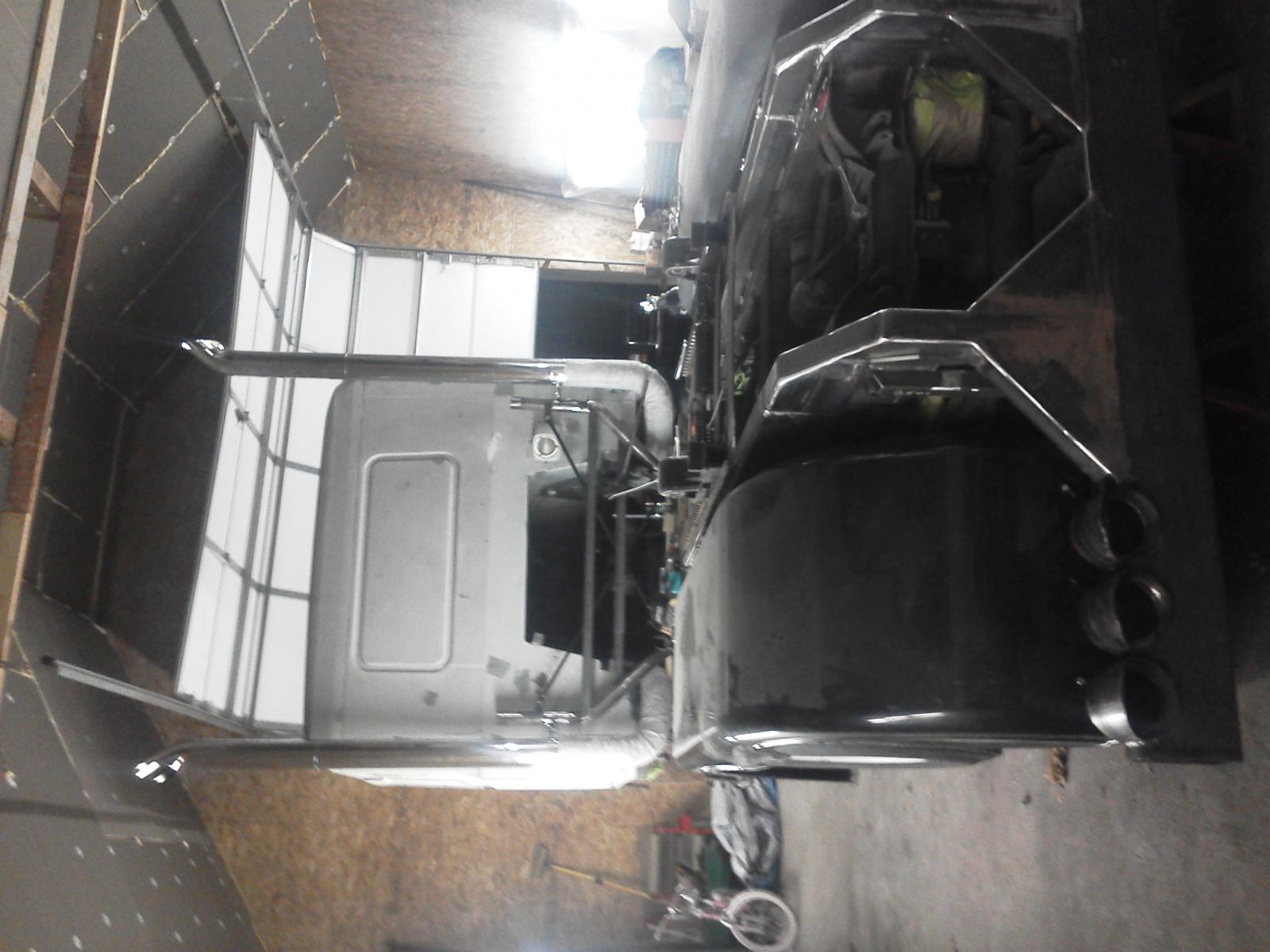

  22. Sorry the 3rd pic was sideways. I didnt notice till it was to late. Its just an old 85 MH, but its mine and its gonna be sweeeet when I get it done. And those are light bars on it that I made out of steel. I can make them if guys like some bad ass stuff... Later Joe
  23. Pics of my MH project. Soon to be on the road I HOPE...
