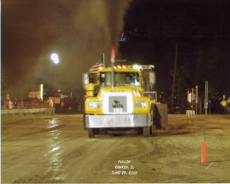

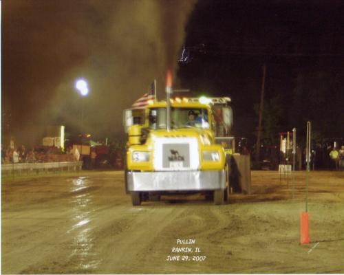

  14. Well i got it home. Little rougher than i thought, but O well.. It only turns about 2350 It might get a little more. Needs more fuel too. I was gonna chek the torque on the buttress, run it for a while then check them again. Ill get some pics soon. ~Joe Thanks for the help guys its alway appreciated!!!!!!

  18. I think it was only 280 or so. I got forth out of 10 trucks
