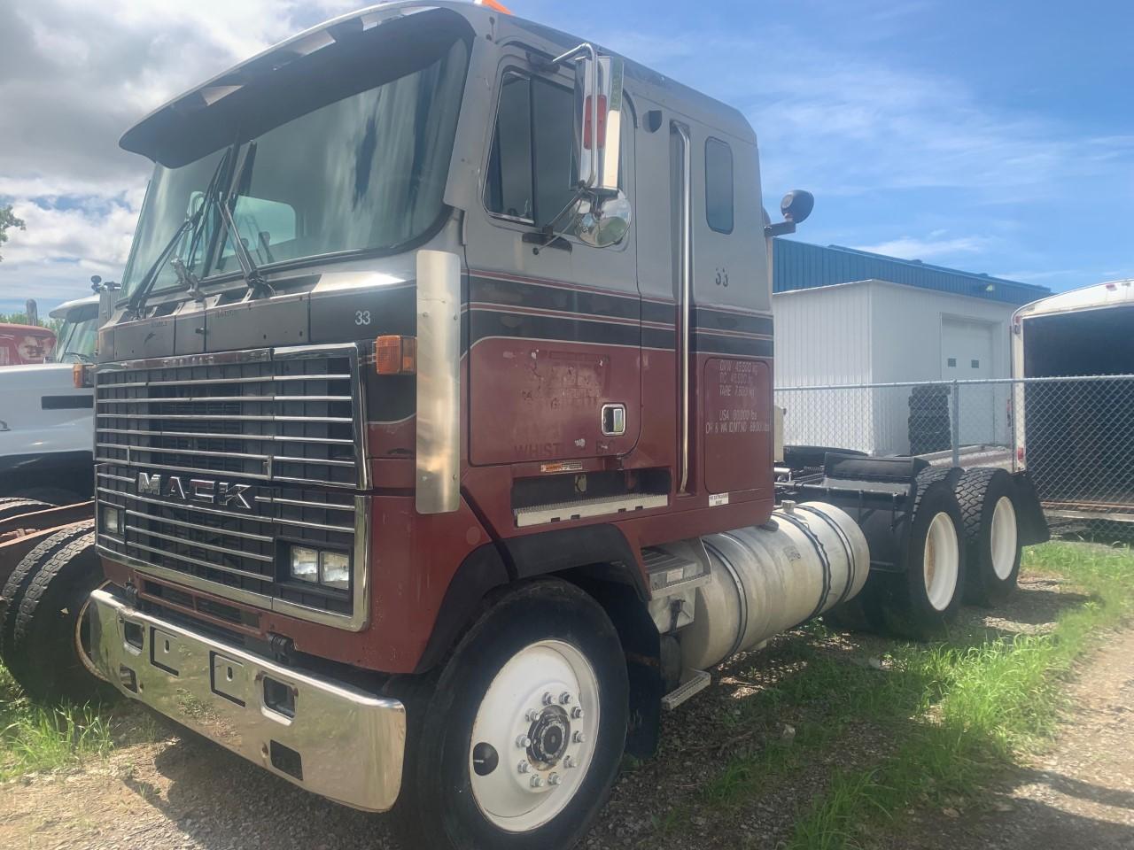

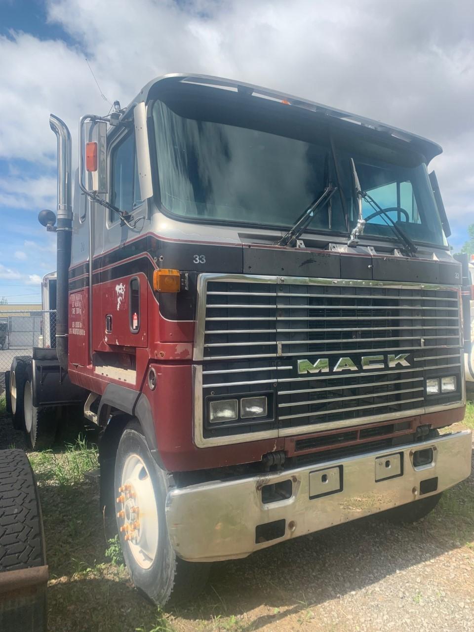

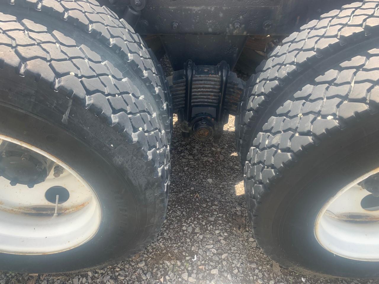

$1500
I still have this old dog if anyone is interested....Looking to do some Spring cleaning.
