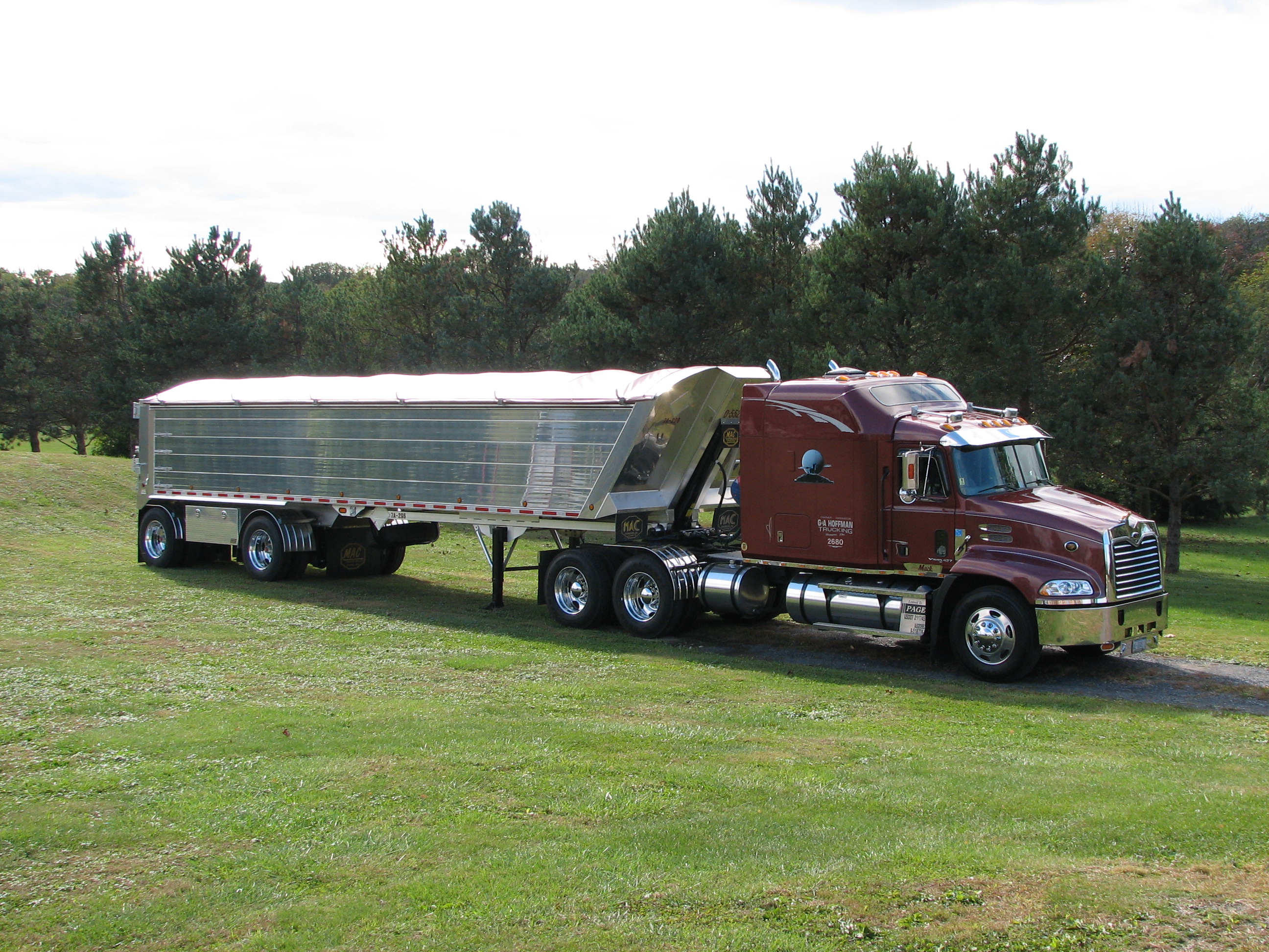

  18. I must say I cheated a little on that pic... The wagon is new, but my CX had about 800,000 on it. Now 1,116,000 still looks the same. Trailer is almost 3 years old now a little beat up from hauling scrap metal, slag, and DEMO. Oh, well. Gotta pay the bills somehow.
