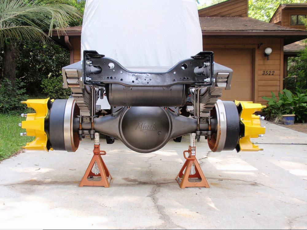

  3. Umm... I'm no expert on split wheels, clamps, and spoke hubs, but since there are no moving parts to wear, welding a 1/4" rod to the spacer doesn't seem like the way fix something that should not be happening. If something weakens from fatigue after 50,000 miles it probably should be replaced/repaired. Maybe that's the case with the spacer(s) getting... crushed??? But it seems like if something fits correctly after being fully seated, (and isn't a wear item) the wheels or hubs or clamps or... something ??? is weakened and stretching (studs, clamps), getting crushed (weakened spacer) or flexing ???

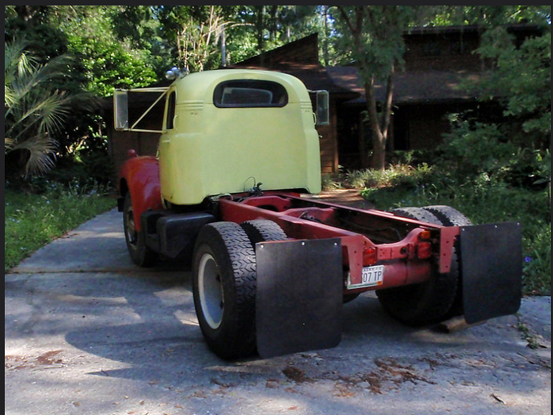

  5. I'm at the Mud Flap & Hanger stage for my B46 eMack and looking for pictures to get ideas. The picture below is what came with the truck: VERY basic, welded on, no lights... The new color scheme will be Tonka Truck Yellow. I'm considering three different hanger choices (all with a basic mud flap; maybe Tonka stenciled on the bottom) Old school coiled spring hanger Straight bar - round, rectangular, or oval Straight rectangular bar with three lights You guys have some pictures of your mud flaps, hangers, and hanger length? Seems like 30" long hangers would stick way out there - yes, no? - Keith

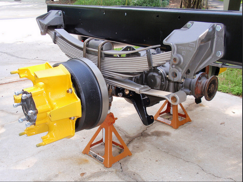

  6. Good'ol rust. There's a sense of satisfaction when using a needle scalar - for about 20 minutes. Then you realize you have several hours of dust and dirt and paint and... But, a lot cheaper than blasting. It would work great on your heavy, scaly rust. Good on cast iron too - That's how I found multiple cracks in a rear hub. https://www.flickr.com/photos/emack/34284586933/in/album-72157684558130216/

  11. I have an 8QJ414 on my B46. Flickr photo below There was a couple of these in the Northeast area for $200 each plus shipping. I had a hub (not the 8QJ414) with what I thought was one crack - it had three cracks that I welded with a MIG welder. Cast steel, not cast iron so they weld without too much worry of cracking. It was a really poor casting that had a lot of factory welding/repair work - which gave me confidence in repairing/welding https://www.flickr.com/photos/emack/34284586823/in/album-72157684558130216/
