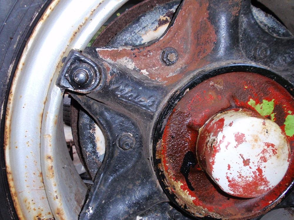

Rims & Tires for Dayton Hubs
Keith S replied to Keith S's topic in Antique and Classic Mack Trucks General Discussion
I just got a quote for six wheels/rims (8.25x22.5) and tires (Cooper Roadmaster) for $3100. The wheels/rims are reasonable, but the tires... I suspect I won't like that gap but... Any pictures of mounted 22.5's and that gap? And that "fix" to hide the gap. If I didn't know better and have the split rims to compare, would I know the difference? -
I'm ready for tires & rims for my '62 B46 and I'm trying to figure out the rims for the Dayton hubs. I need six new tires and probably 6 rims too. It currently has 10.00 x 20 bias ply tube-type tires. The build sheet shows it originally came with 11.00 x 22.5 front & rear. It looks like I have a combination of three different 2-piece Firestone & Goodyear rims - some rims are 20 x 7.5. A couple rims are damaged/bent A couple Firestone rims have non-matching side rings At least one Goodyear has what looks like an old lock ring I'll happily replace all the rims if I can figure out what I need Tubeless or tube-type are acceptable as long they fit my spoke hubs Accuride catalog shows a lot of stuff, but not enough information to figure out what I need So, What is available that looks good?

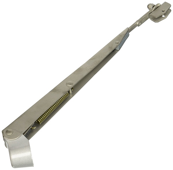

For those looking for Model B wiper arm replacements - not identical to original but... Anco #44-04. ebay for about $25 each; amazon for $21 & free shipping. The length is adjustable and comes with both 5/16" and 3/8" tapered, knurled driver for ISO shaft (double flats). Wiper Parts.pdf

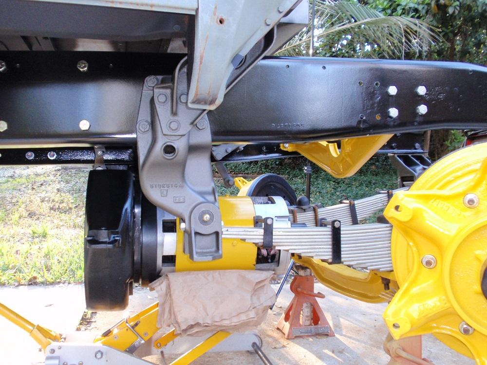

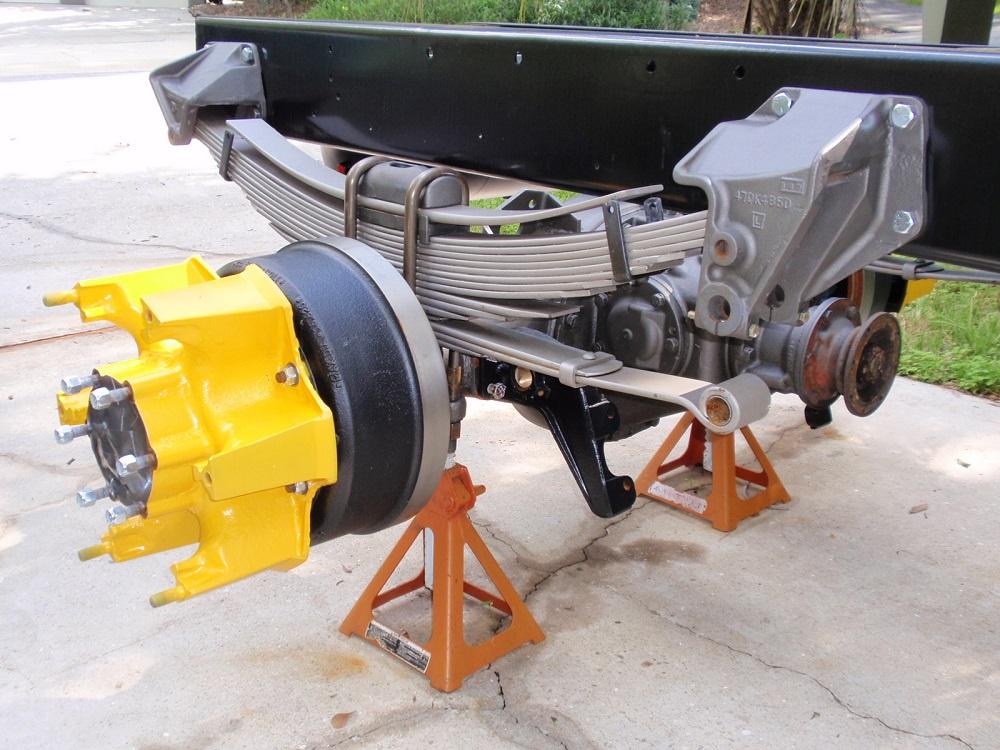

Keith S commented on Keith S's gallery image in BMT Member's Gallery - Click here to view our member's albums!
The linings are all the same and symmetric. The shoes are not. The casting's are imprinted with either "Upper Left / Lower Right", or "Upper Right / Lower Left". Before I took the other side apart I thought there were four different shoes and linings. They shoes only fit one way... well, when put together correctly. Here are some before's and after's. -
