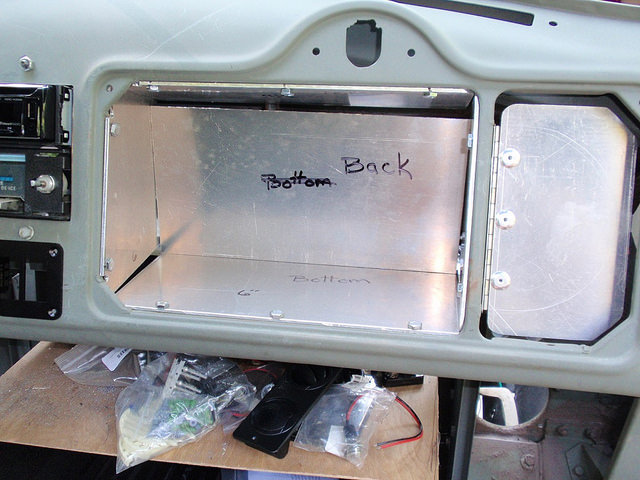

  12. I won't be using my glove box hinges - they're bent to hell, but workable. I'm replacing the glove box door, hinges, and "glove box". I haven't cut them out yet: probably in January. Are you still interested, and what parts do you need?
