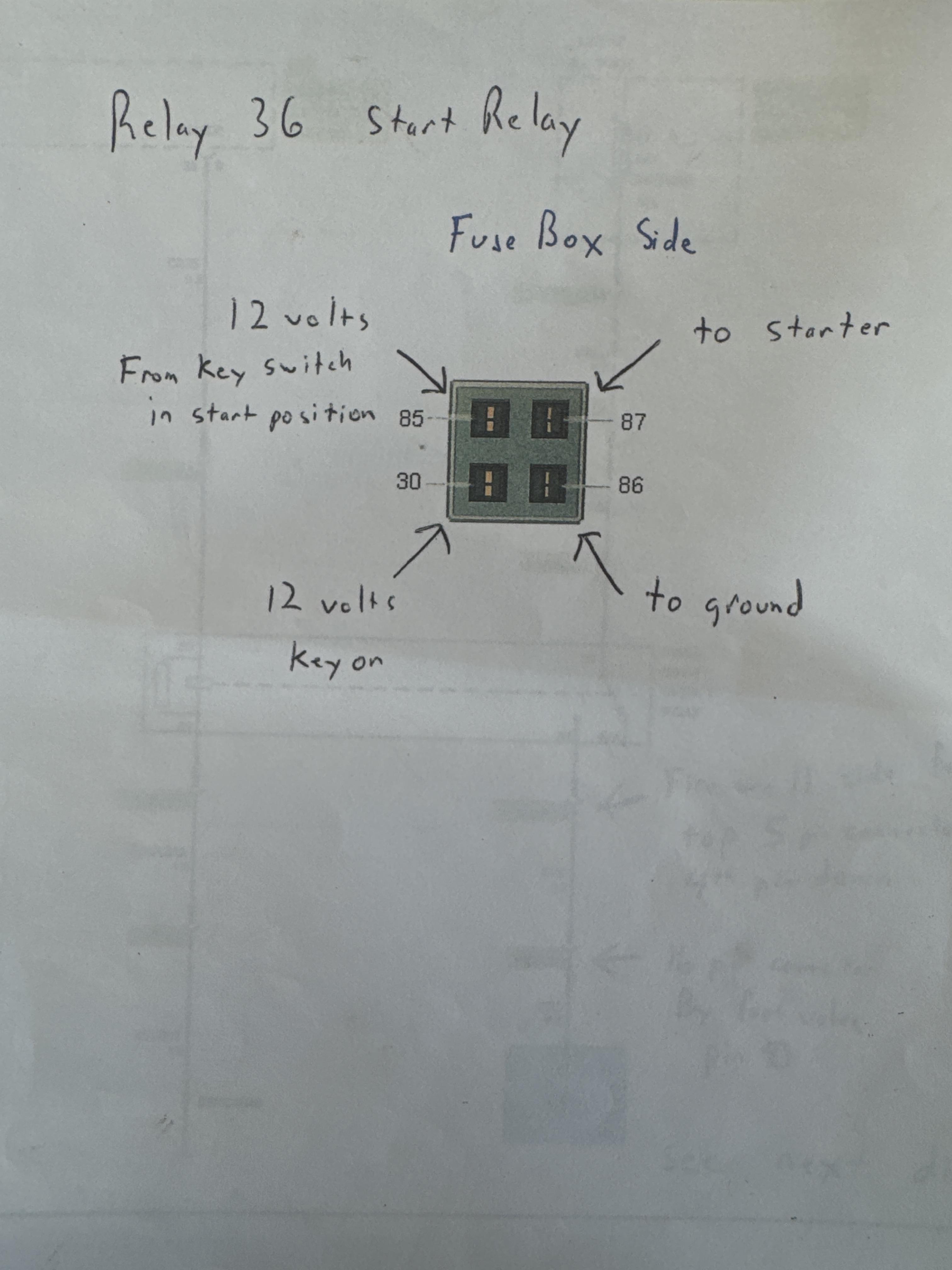

  5. Power to Pin 85 comes from the VECU Vehicle control unit . The key switch in the start position sends 12 volts to pin A6 of the VECU, then if everything looks good to the VECU it sends 12 volts out pin B28 to the start relay pin 85

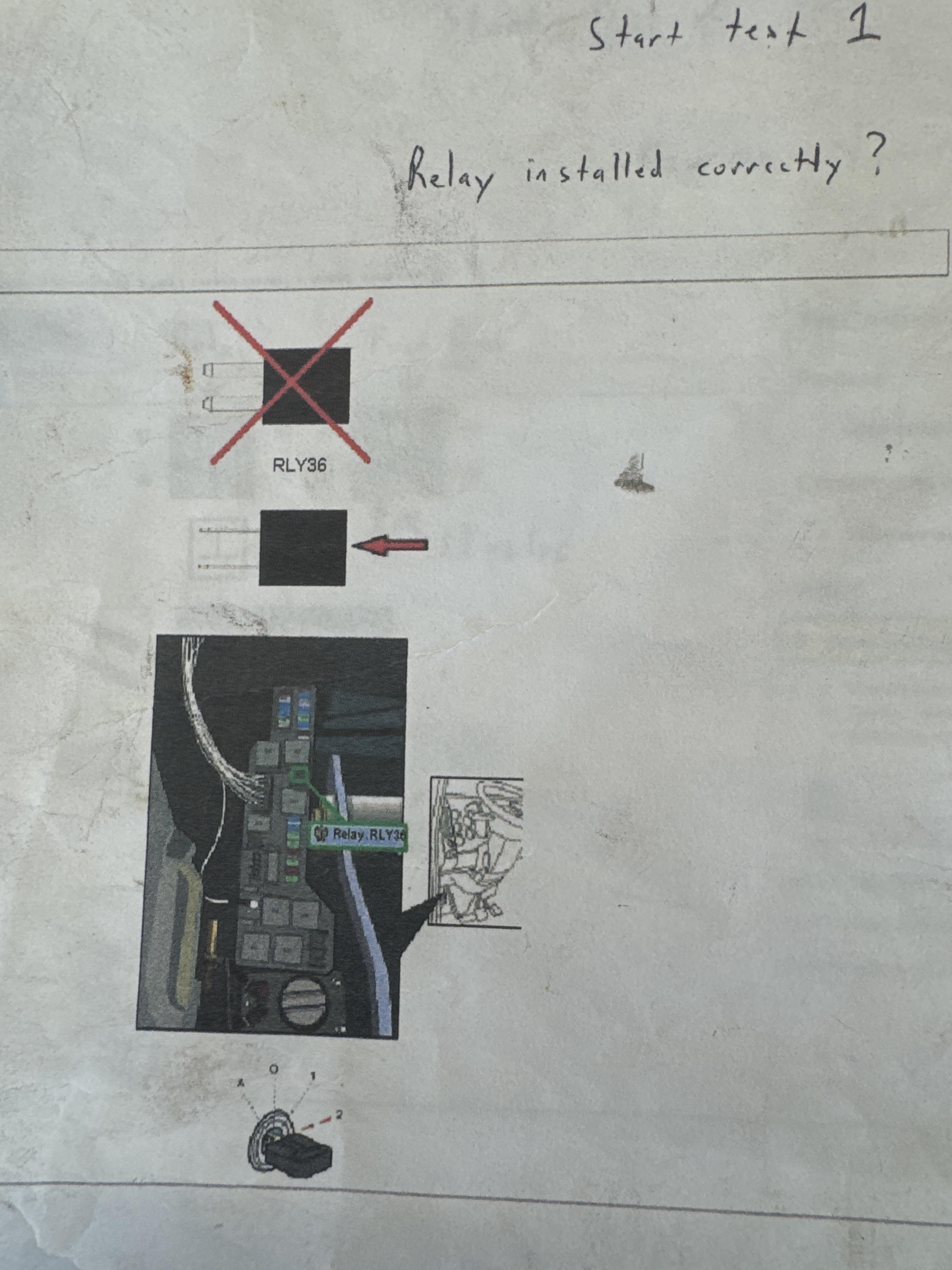

  6. Also relay 36 has to be installed correctly or it won’t start.

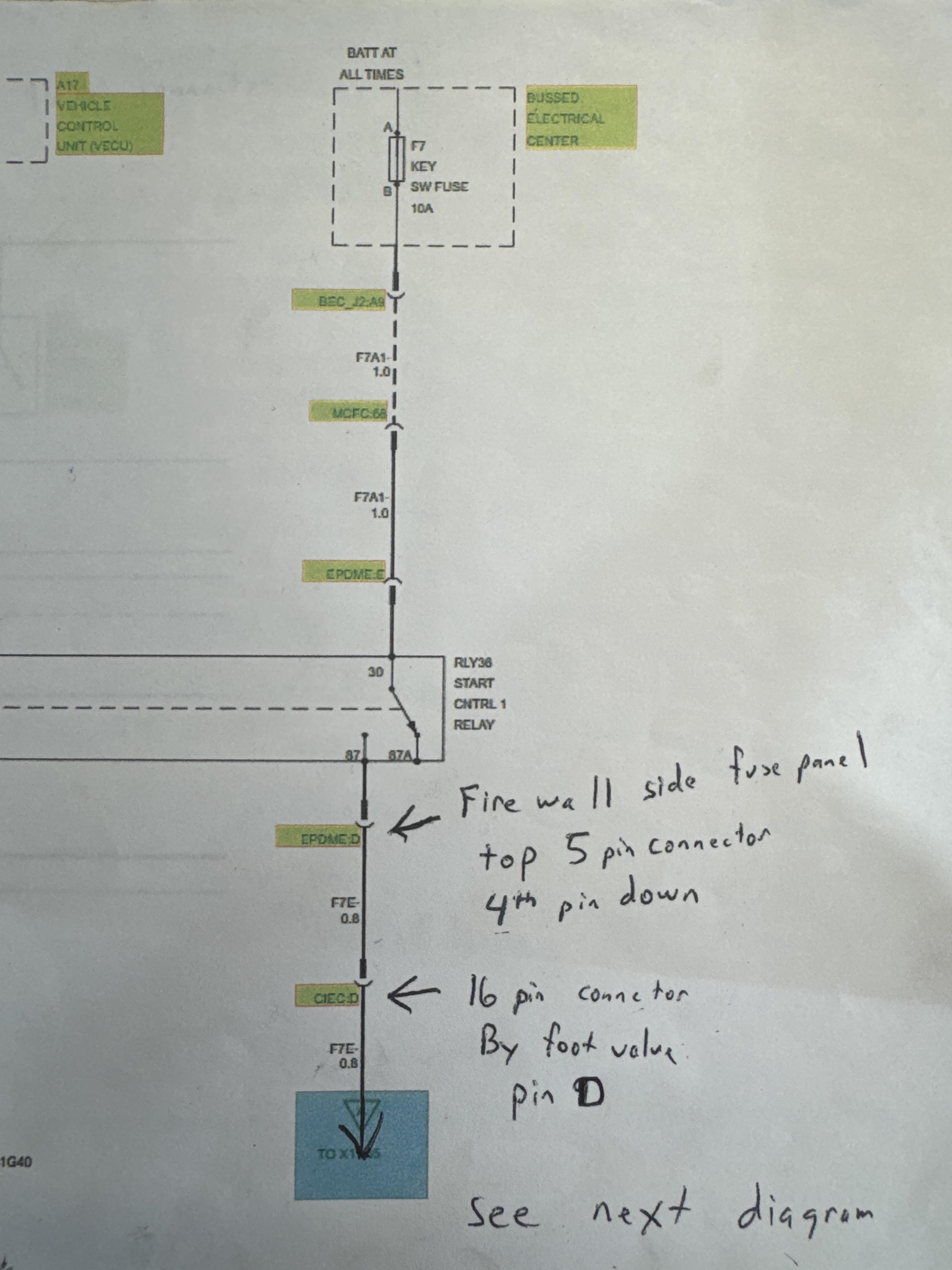

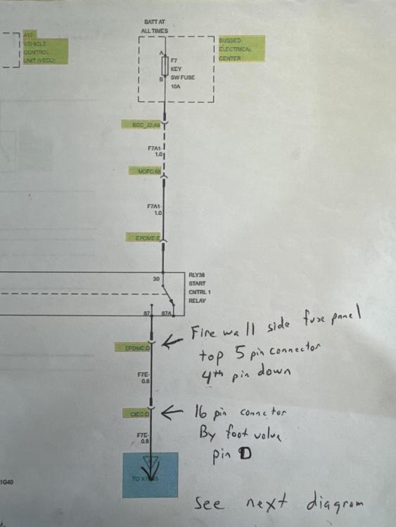

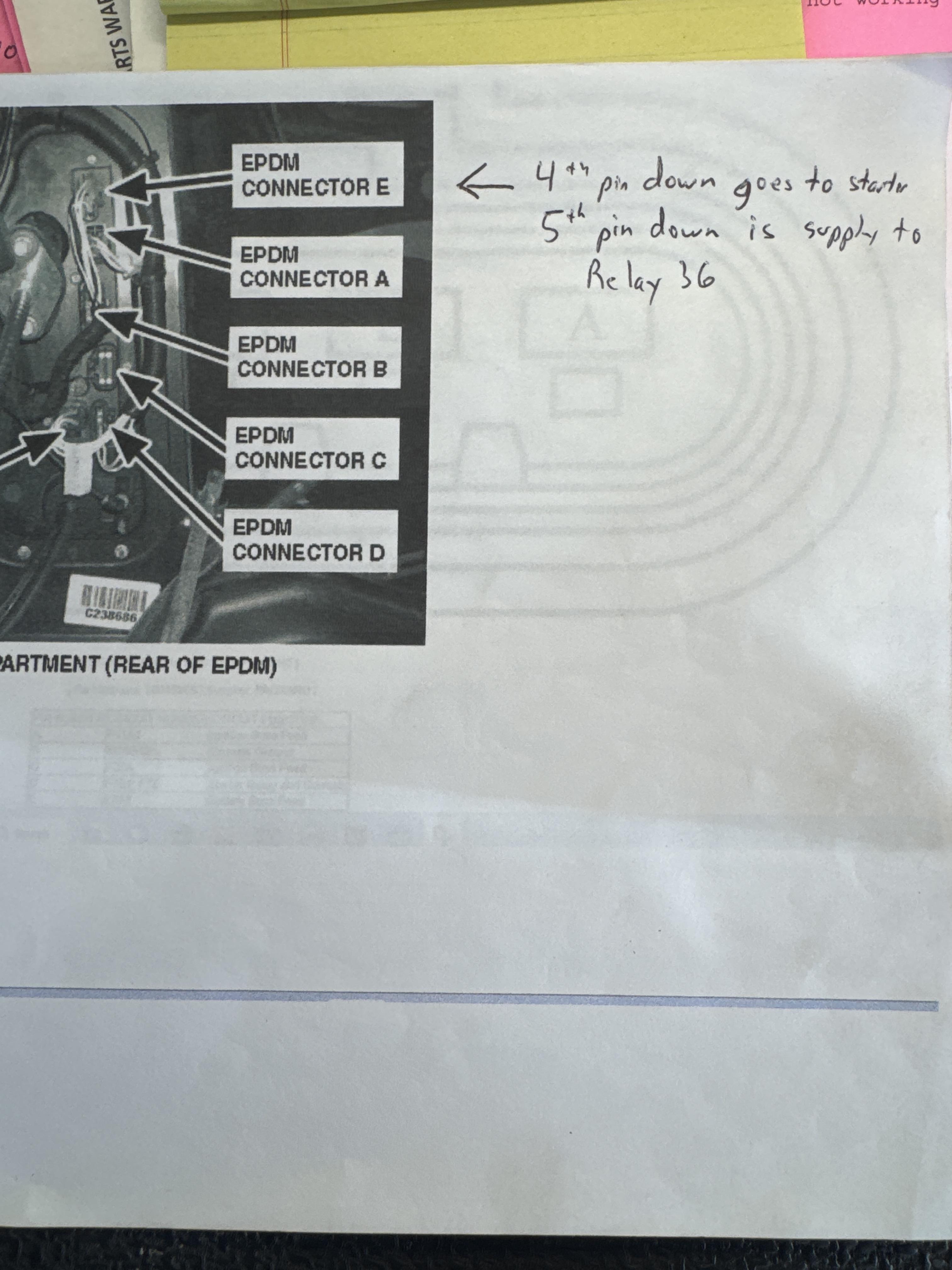

  7. Check voltage on both side of fuse 7 with the key on. Dont use a test light. Use an actual meter. The wire coming out of fuse 7 is labeled F7A1. It actually goes out the firewall in the big 100+ pin pass through. It’s pin 68 . Then comes back into the fuse box on the top connector bottom pin
  8. Pin 30 should have 12 volts with key on . This is looking into the fuse box with relay out
