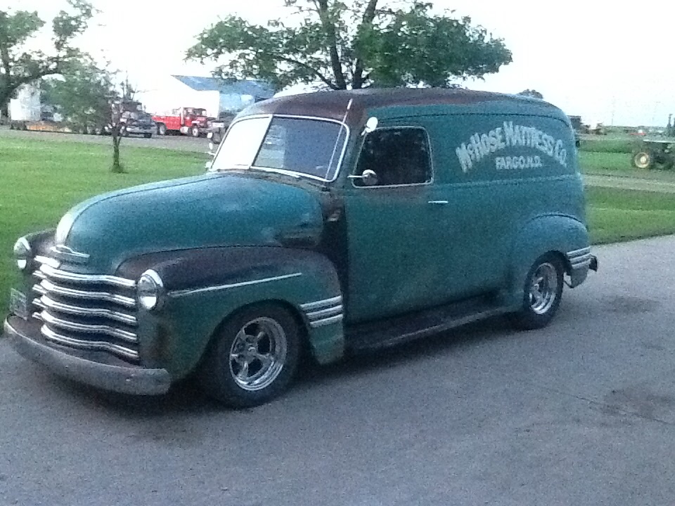

  6. I would consider cutting the roof off at the posts and welding a better roof on. I once did this on a 72 Chevy, just make sure to brace the cab before you cut, and measure carefully.

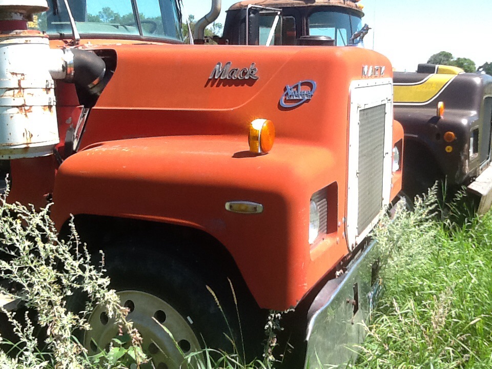

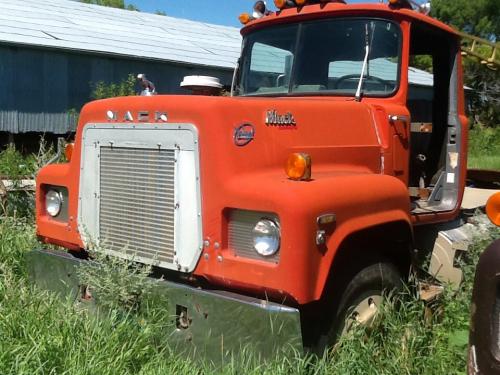

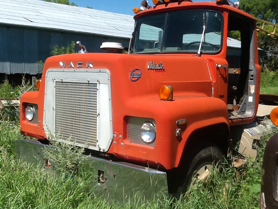

  10. I have a good hood and grille, it's not perfect one small crack by the latch and a .22 hole in the a.c. condenser. $700.00 picked up in ND. I would definitely see if a body shop could fix the fiberglass.
