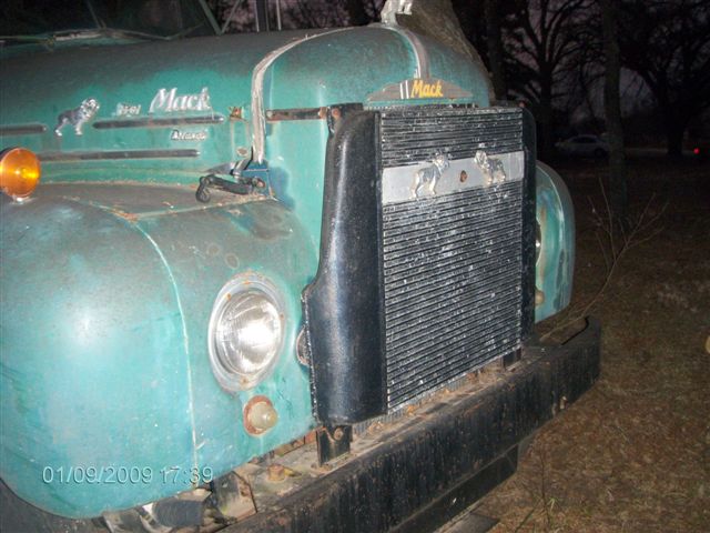

  14. This truck did have shutters till i installed a 285 engine and the cooler tubes go thru the headlight panels and connect to the larger air cleaner and to the intake.This was a single axle truck that i installed a box on the back and made a camper for hunting.It was some spared parts i had.I installed a eaton ten speed and a three speed behind it for more speed.
  15. Here is my B model with a later engine and air/air cooler on it.Its a KW cooler turned up side down.
