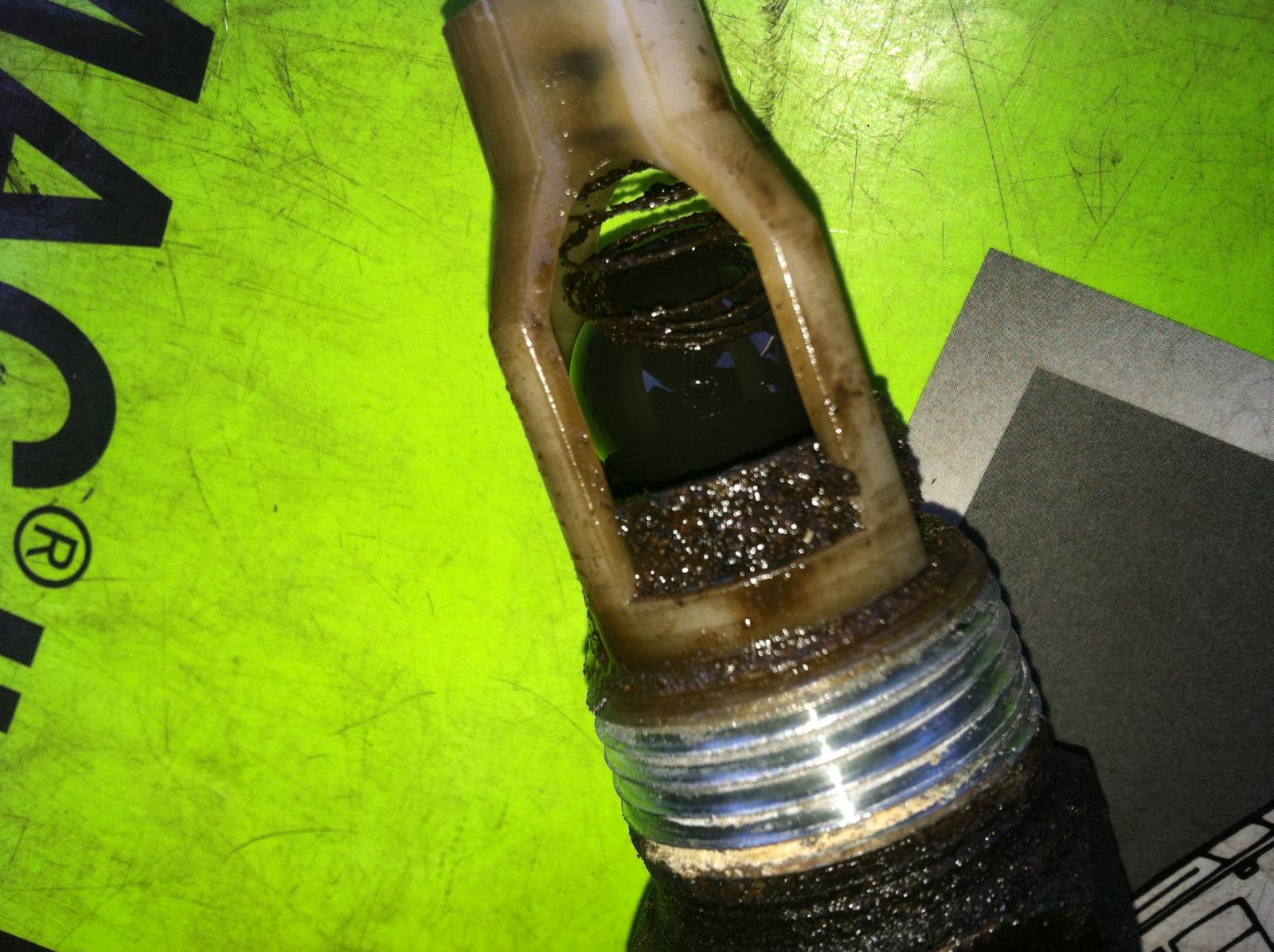

  5. Check and make sure the bottom of the fuel bowl housing is tight no wet spots then I would be looking at stuff like fuel overflow valve at return side on engine right above air compressor, sure fuel is not leaking internaly into engine at supply pump or unit pumps etc. also check and make sure all fittings are tight from fuel water separater to engine.
  6. This is what you are looking for ,either the ball valve is stuck open with debris or with spring is missing or rusted and collapsed .
  7. check were the fuel line comes into the fuel filter bowl there is a 90 degree fitting and in the straight part is a ball and spring check valve .
