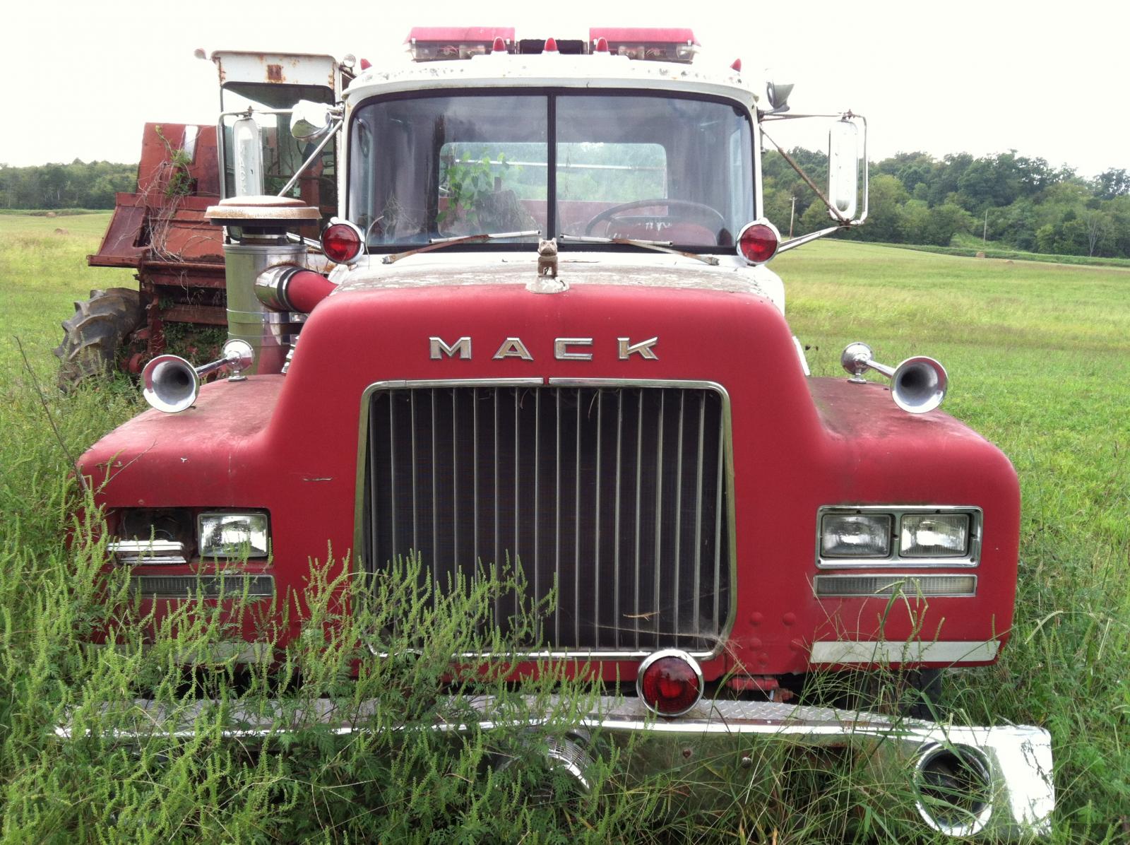

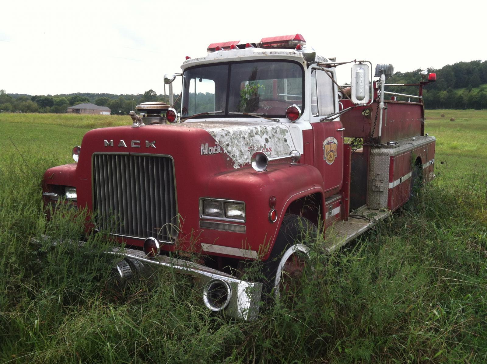

  14. The owner is not interested in selling it rite now his son wants to turn it into a service truck for welding, so I will check back next year the cab is really rusted has weeds growing inside the cab.
  15. Any chance there was a aftermarket company making these hoods in the 70s
  16. Looked in bucket and did not see any extra fiberglass or filler it looked like in was made this way engine looked almost new bright gold paint truck is maybe 69 has a steel dash in it.
