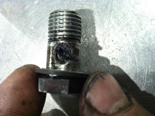

  3. Found this the other day banjo fitting inlet side of ecu cooling plate completly clogged with debris another shop had replaced cups and fuel pump but this is the real problem.

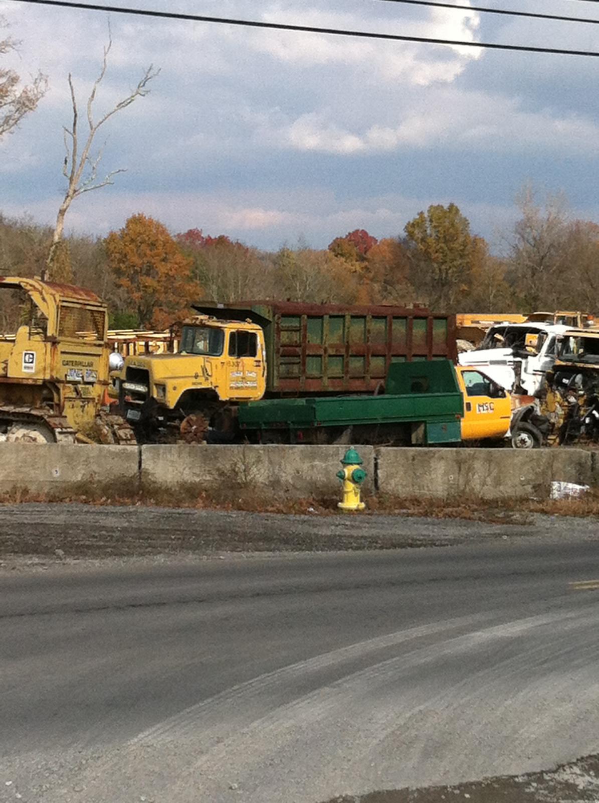

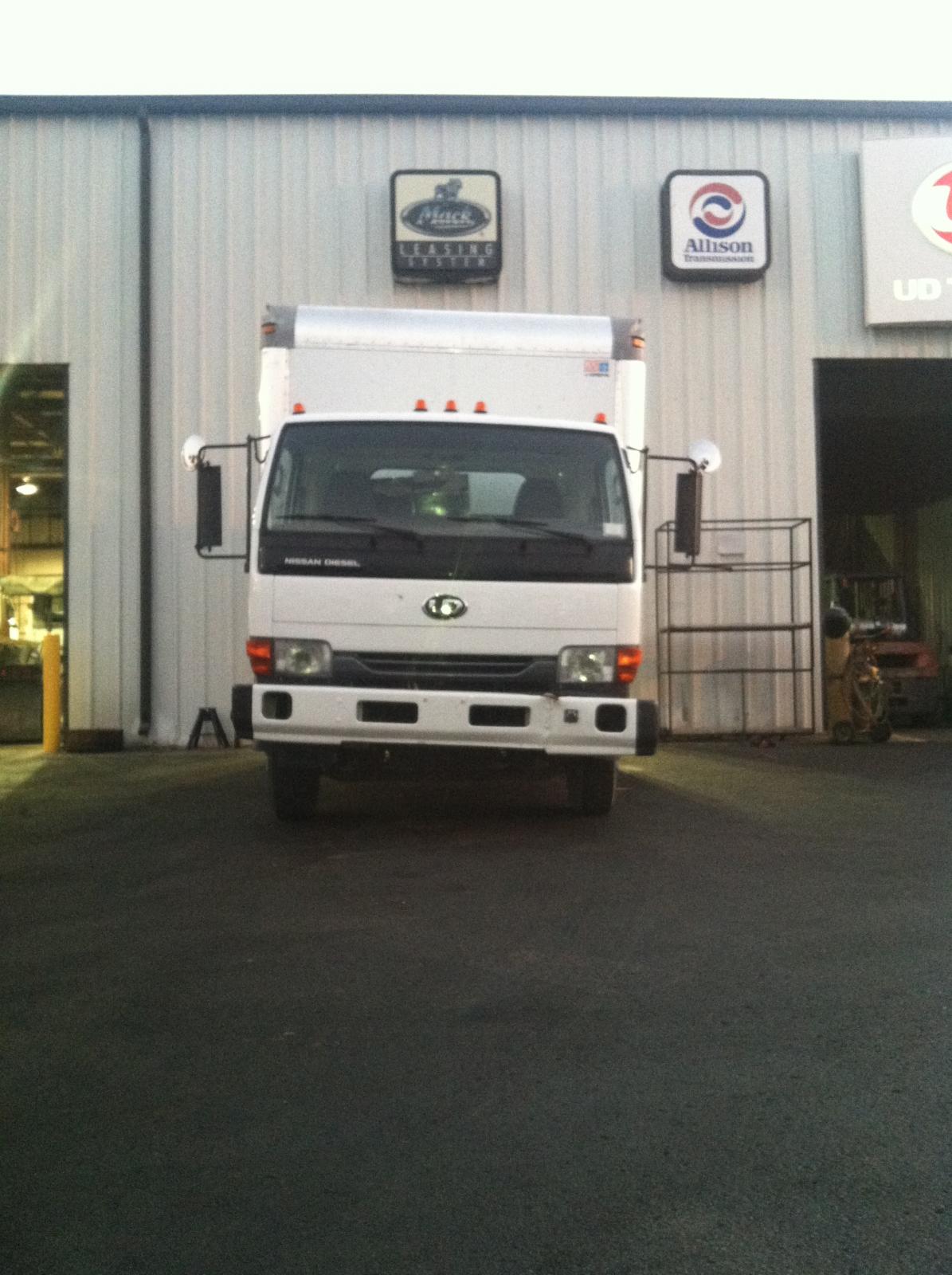

  4. Got a little U model lean in our UD service truck, Vinny do you have a universal kick stand that you want to sell . Also took pic of old jones brothers truck in scrap yard.

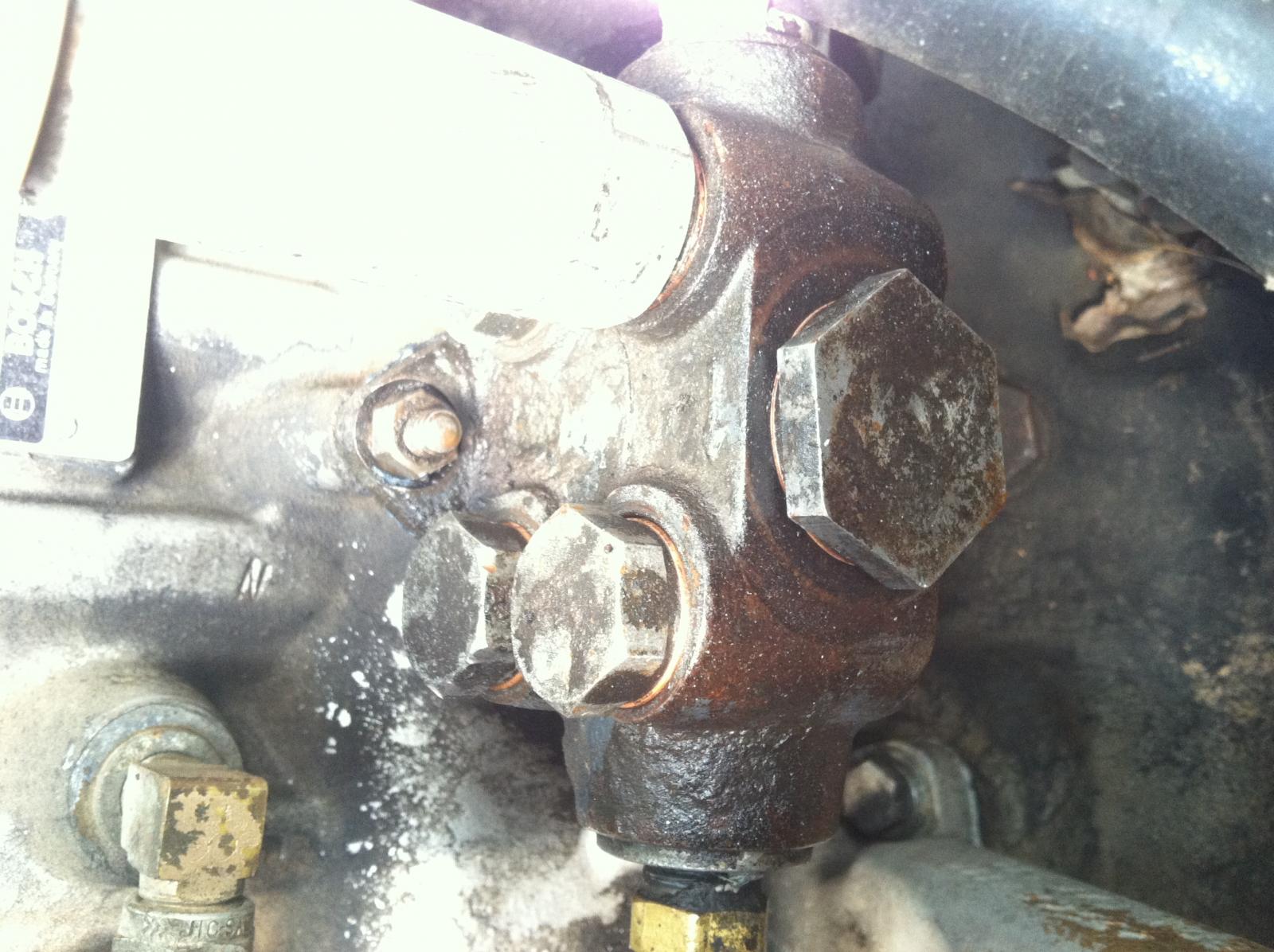

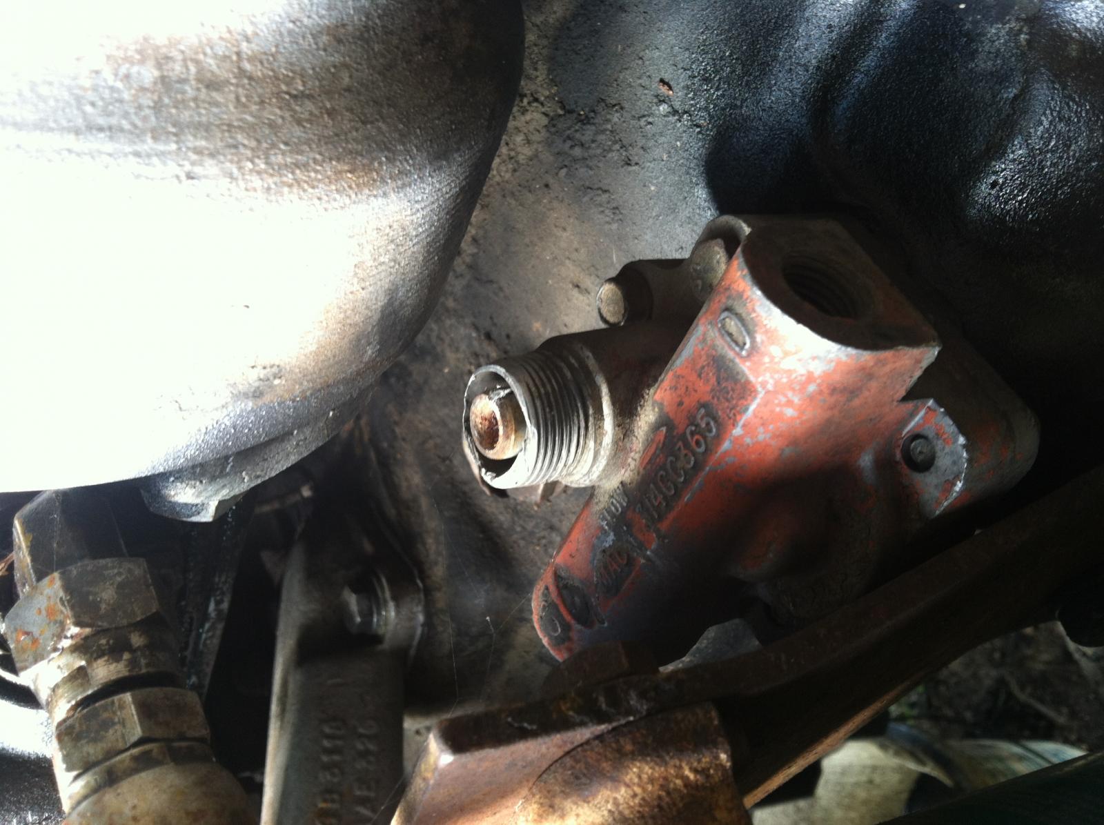

  19. Lift pump is mounted on the injection pump 3 small bolts are holding it on , other option is that it has a pump on tach drive which is below injection pump in engine block this is a low pressure fuel system 7-15 psi as i remember . Have been to the roundup in milescity many times remember the days when they run cattle up the interstate .
  20. Need to double check your fuel lines should be going into primary fuel filter out of primary to lift pump in correct direction out of lift pump to secondary filter out and to injection pump then return out of pump to tank. At fuel return fitting on pump should be a checkvalve with a ball and small spring this is what makes the fuel psi . This sounds like a fuel psi issue to me welcome to BMT I too lived in MT at one time little town called Colstrip
