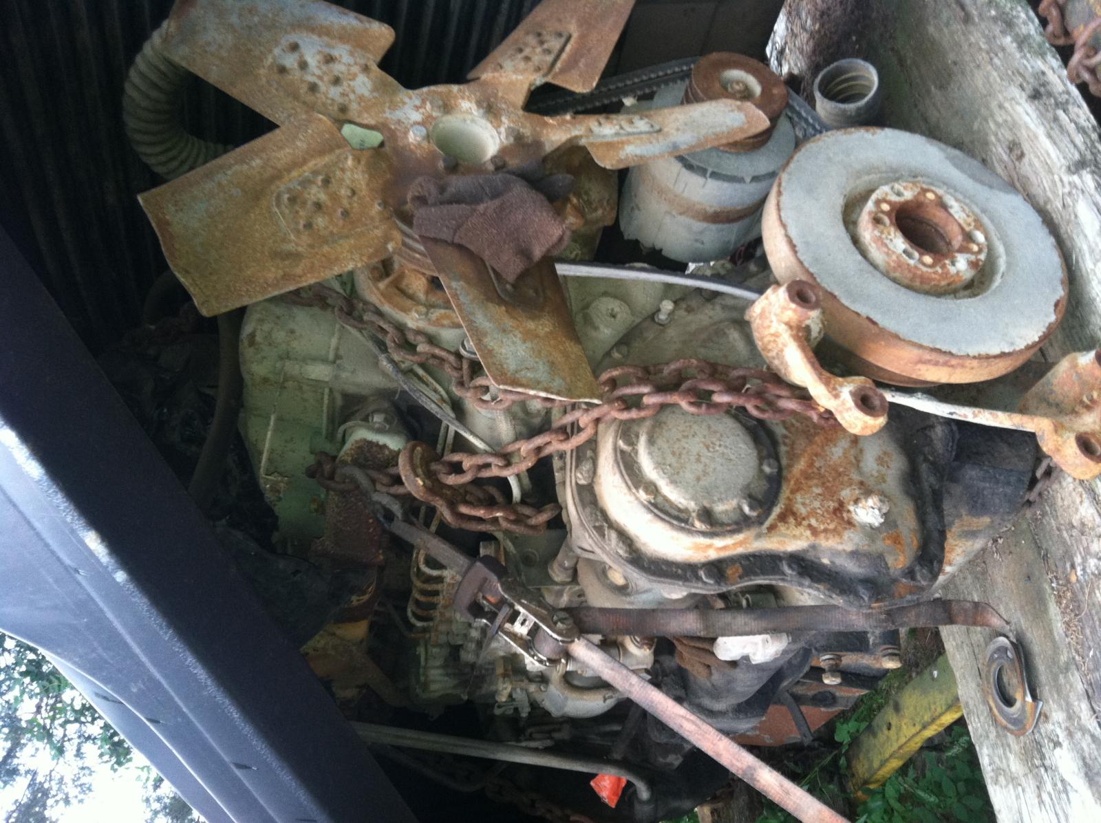

  6. Heres the engine that goes with it come out of a mixer

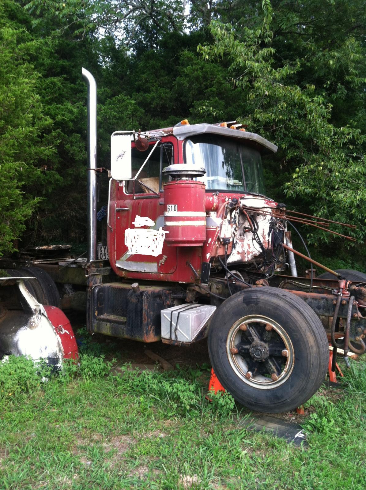

  8. What years did they build the R686ST with a Hood scoop, this would b a road tractor daycab Square fuel tanks.
