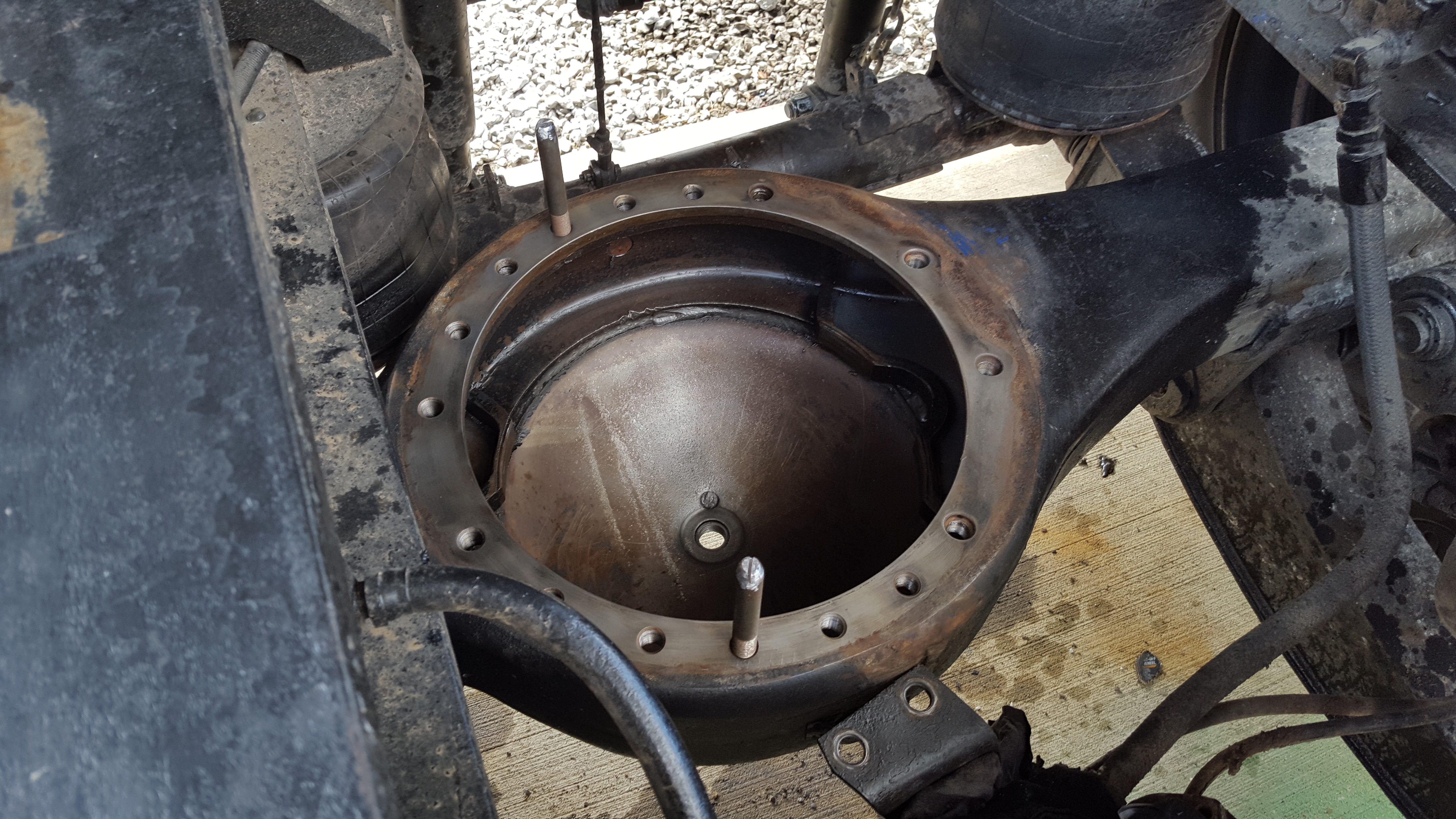

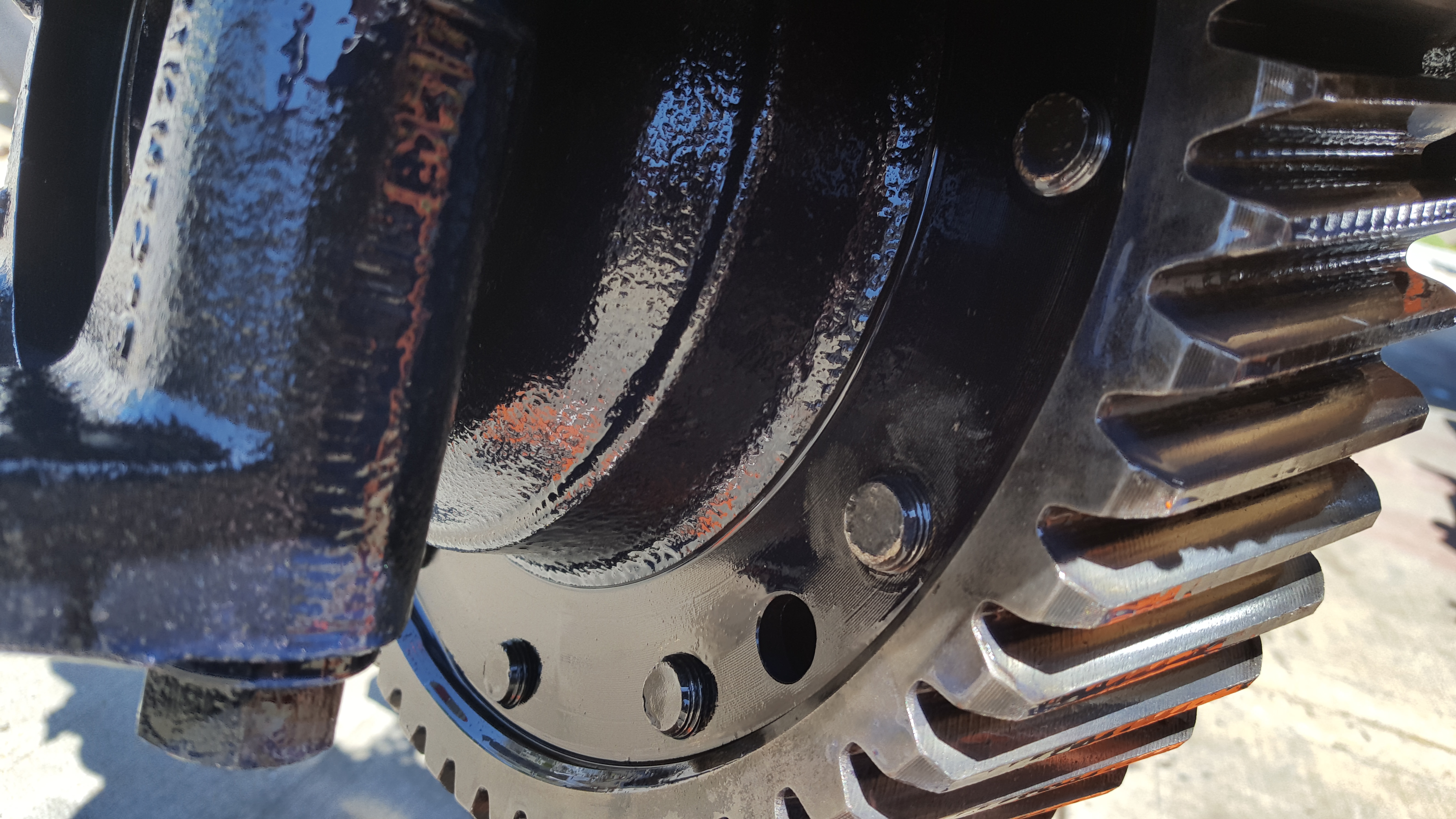

  16. I do the same but I didn't pull the hubs just the axles. I made set of guide pins I would recommend anyone doing this job to have them. The rear is sealed with silicone and must be applied to both half's and once you place it on you don't want to move it or you will have leaks. I bought the rebuild manual so ask away.

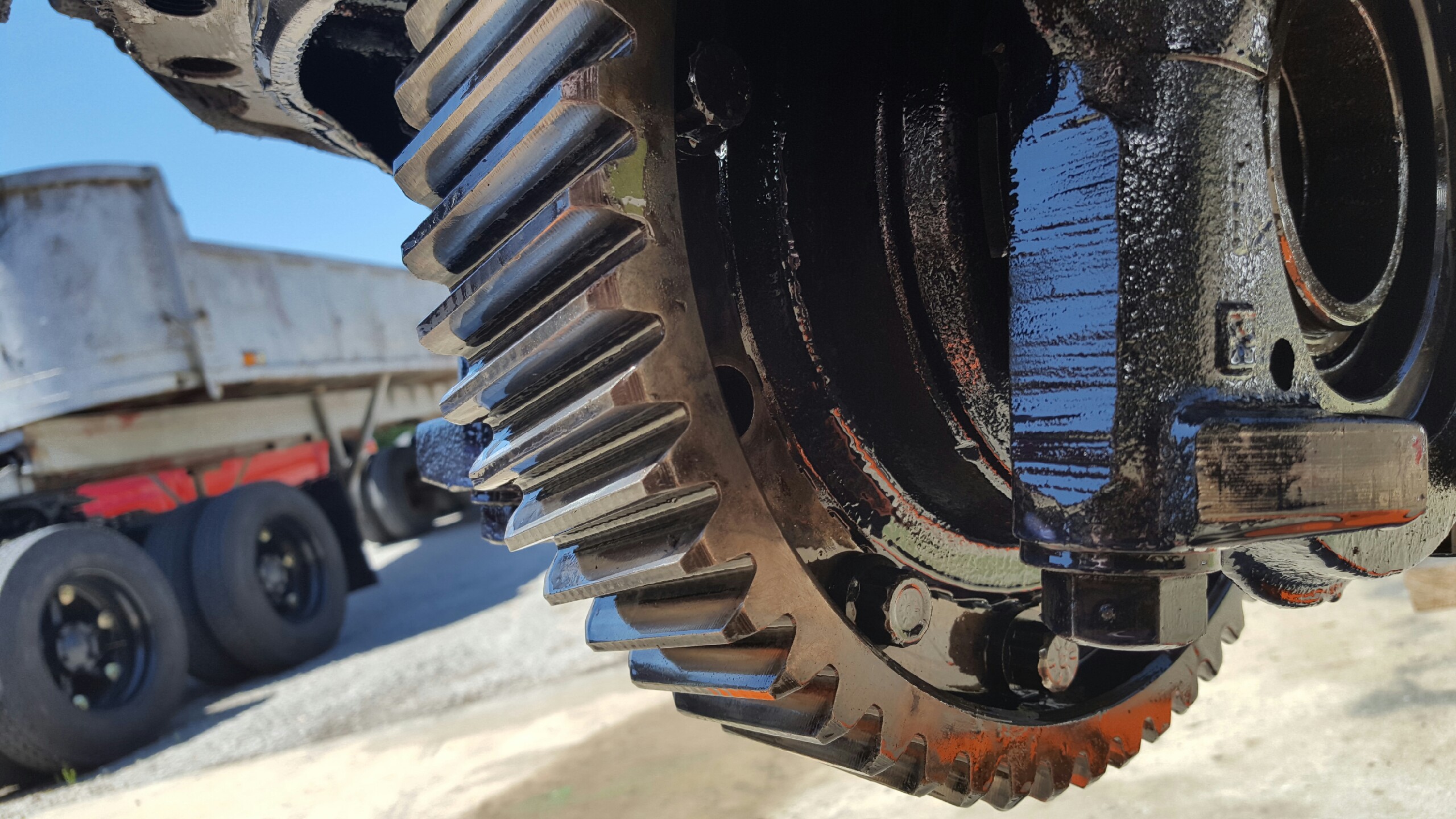

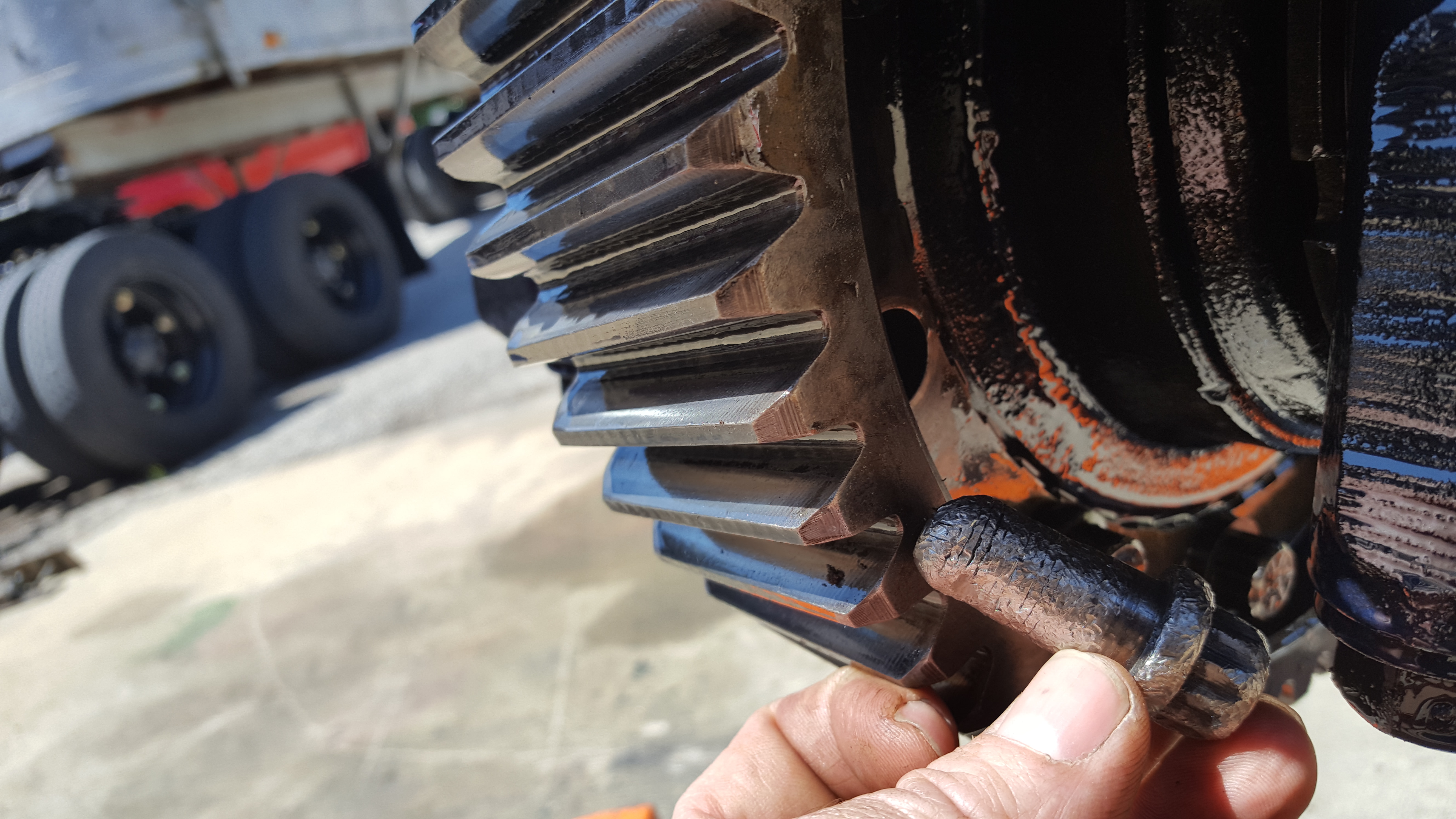

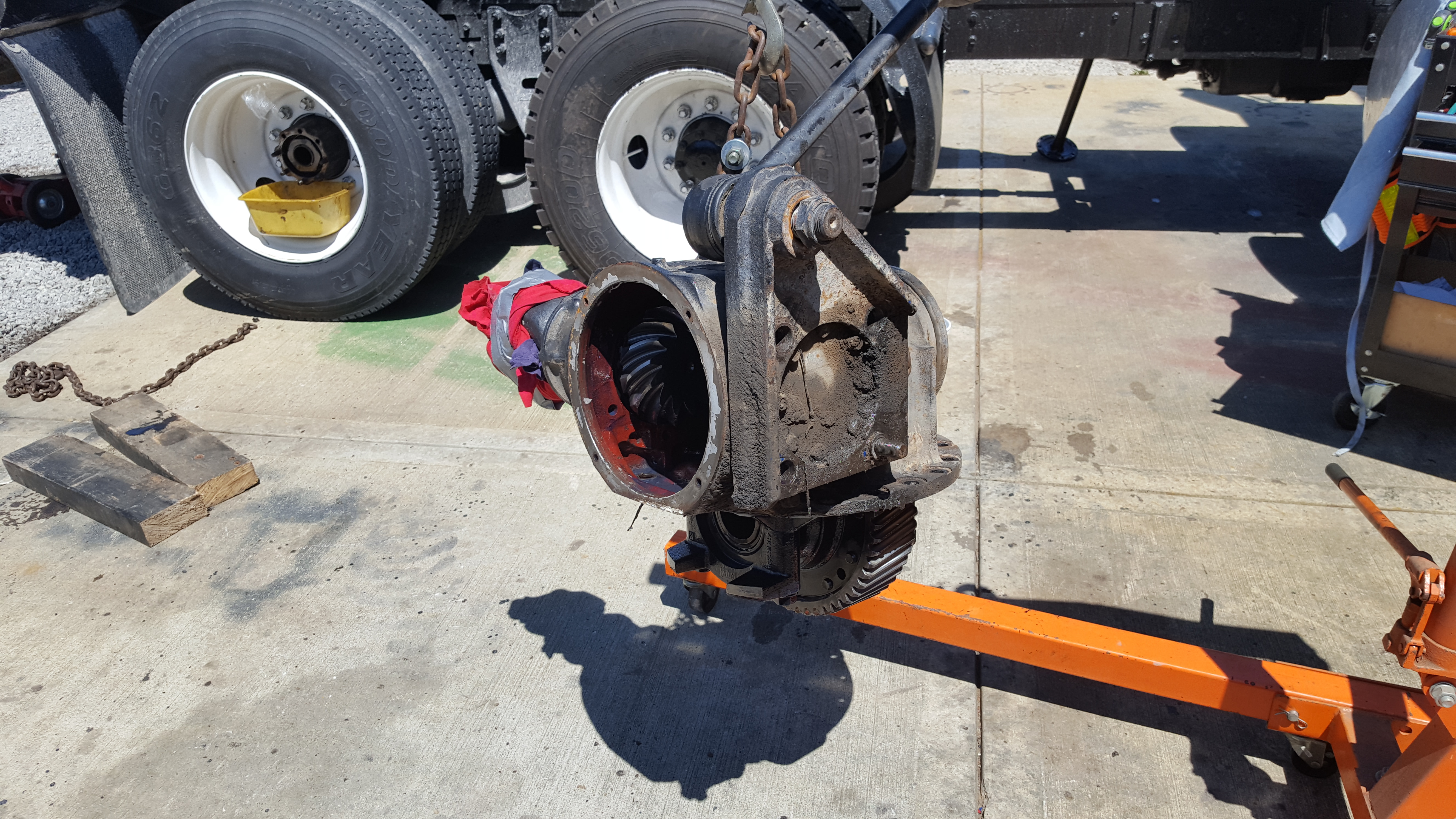

  17. Update this morning I tackled the job of pulling the differential. It was the rear one and tight as it is on a dump truck. After getting it removed I found all of the bullgear bolts loose. After checking it out and installing new bolts I managed to get it dropped back in. I made a set of guide pins which really helped with getting it dropped in. One of the hardest parts was pumping the oil. I ran the truck in gear on jack stands for over 20 minutes. Since I pulled the axles all of the oil was drained from the hubs running with no load will allow the oil to splash back up into the hubs. Better than pulling the wheel.

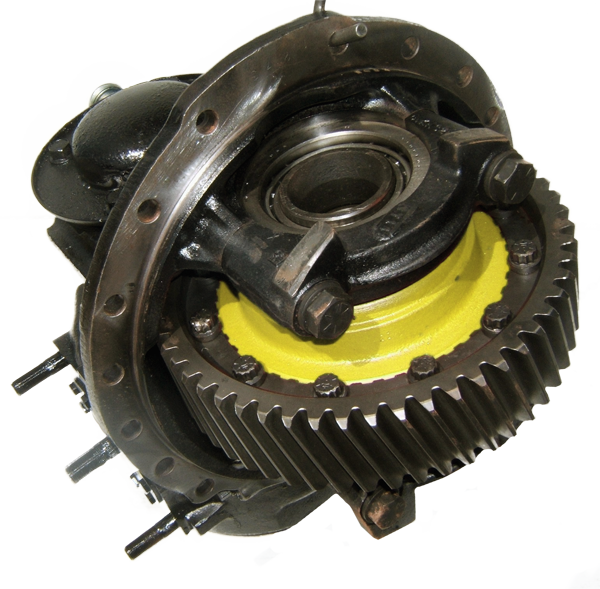

  18. I flushed the rears in June and replaced all the fluids. I would like to have thought it would have not been left in there? I spoke with a guy who rebuilds them and said that I shouldn't worry about it coming apart because the way Mack made it has like a gear in a gear. My concern is if one fell out are the others ready to also?

  21. I guess I will end up pulling it for inspection. Just kinda tired of this can of worms. I can see how the broken studs can be related to the swing arm but the bolt falling out of the bullgear not so much.
  22. Was flushing out the housing and found a bolt not to terribly chewed up so hopefully nothing is damaged. You can still see the treads and markings and nothing else is floating around in there so I stuck my inspection camera in and didn't see anything. I was hoping to save some work by pulling the right side cover off and see if you could get access to the bull-gear bolts. Anyone know???
