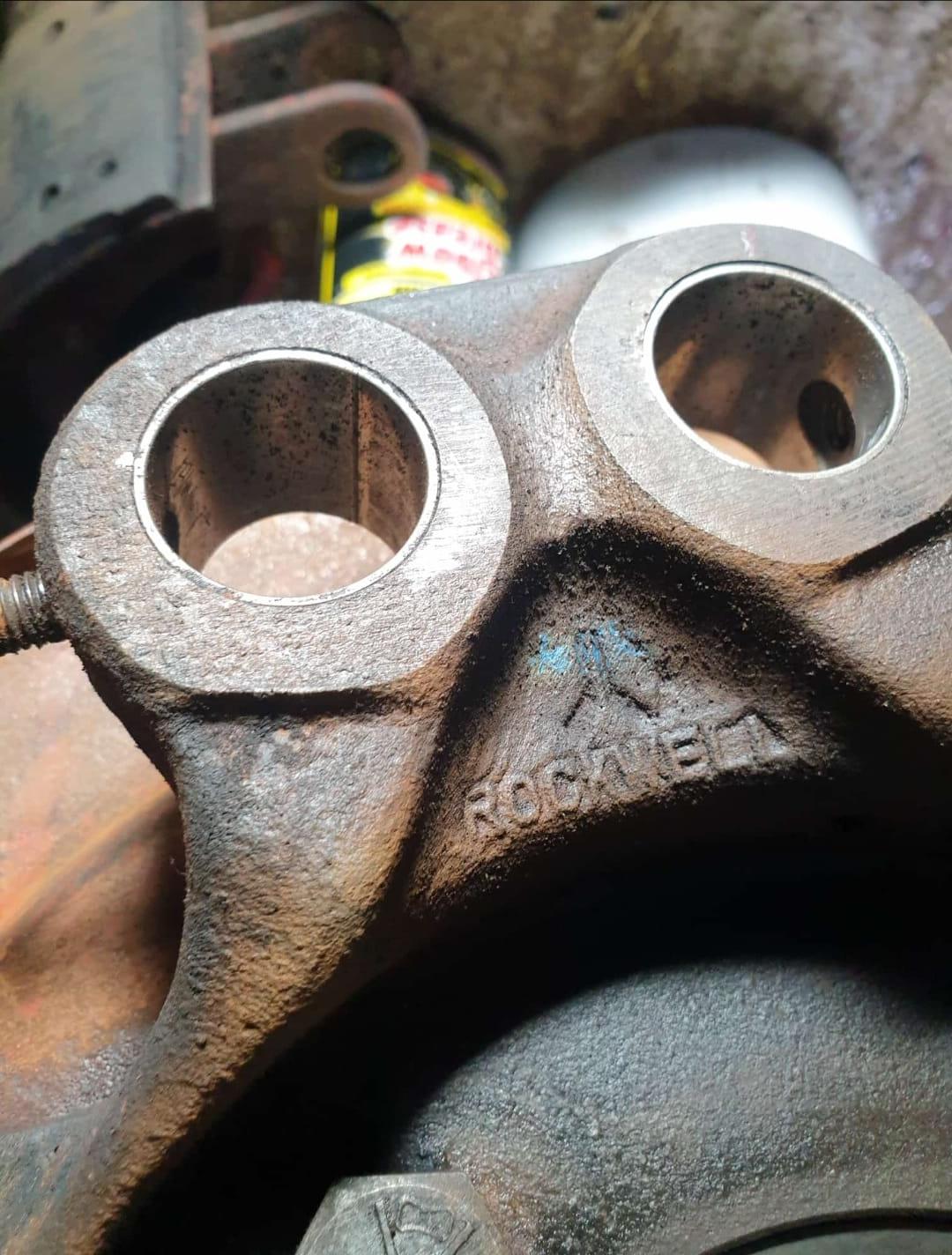

Cruiseliner front axle...
cruiseliner64 replied to cruiseliner64's topic in Driveline and Suspension
