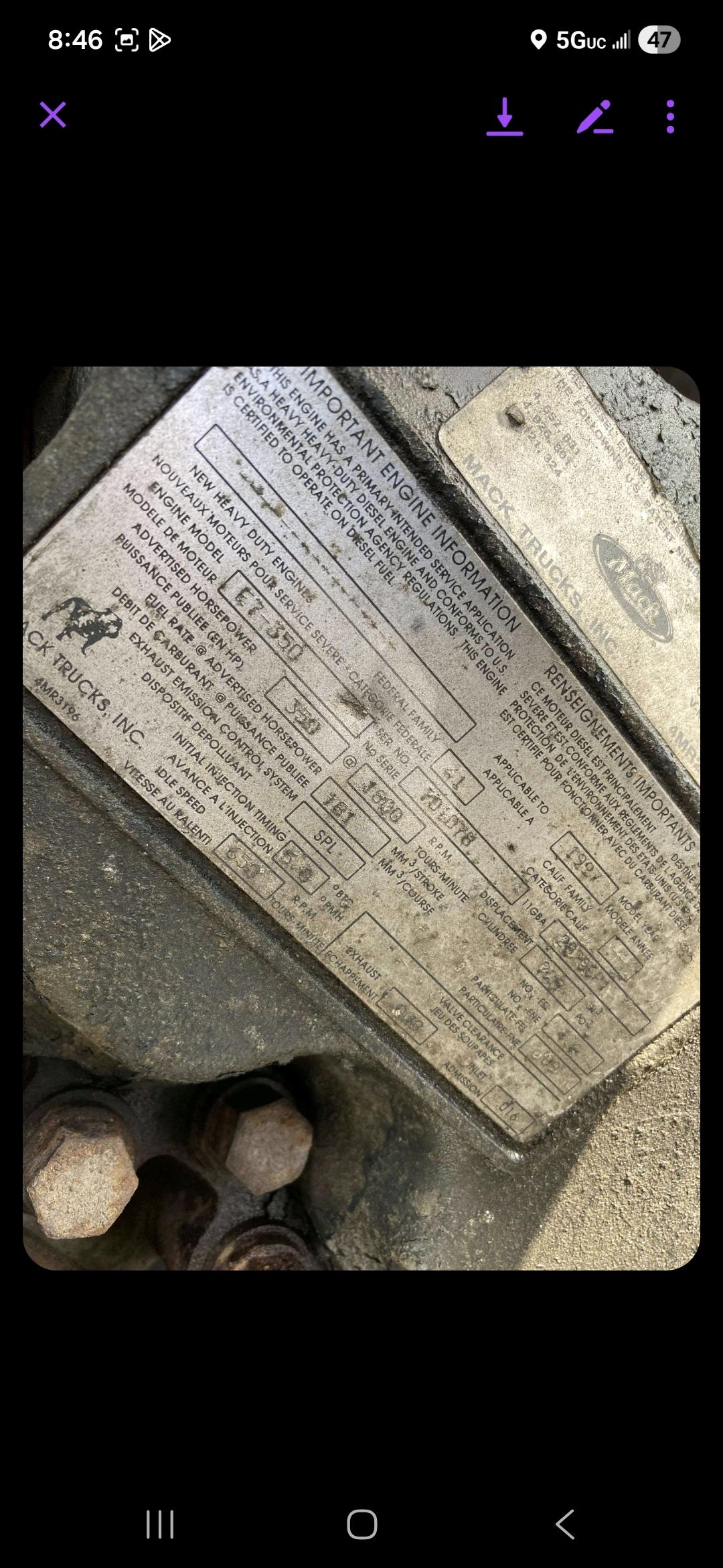

Something like this is what you're looking for. Price is a bit high, but it has engine brake. Like previously mentioned, you can tell it has engine brake spacer between the valve cover and the head.

The listing says its an EM7, which would be a Maxidyne. I think the Maxidynes have different pistons and camshafts than the E7s FYI. Also the fuel pump on an EM7 is governed at 1750. If your trying to make 500hp you'll probably want more RPMs than 1750. You probably will be changing all that on this build but if you buy an engine for parts/core be cognizant of that.
Yes, agreed , i meant for the listing to show what engine brake valve cover spacer looked like.. would like to also add that maxidynes are usually paired with 5,6,7,8 speed maxitorques trans which have an end overdrive of .64
