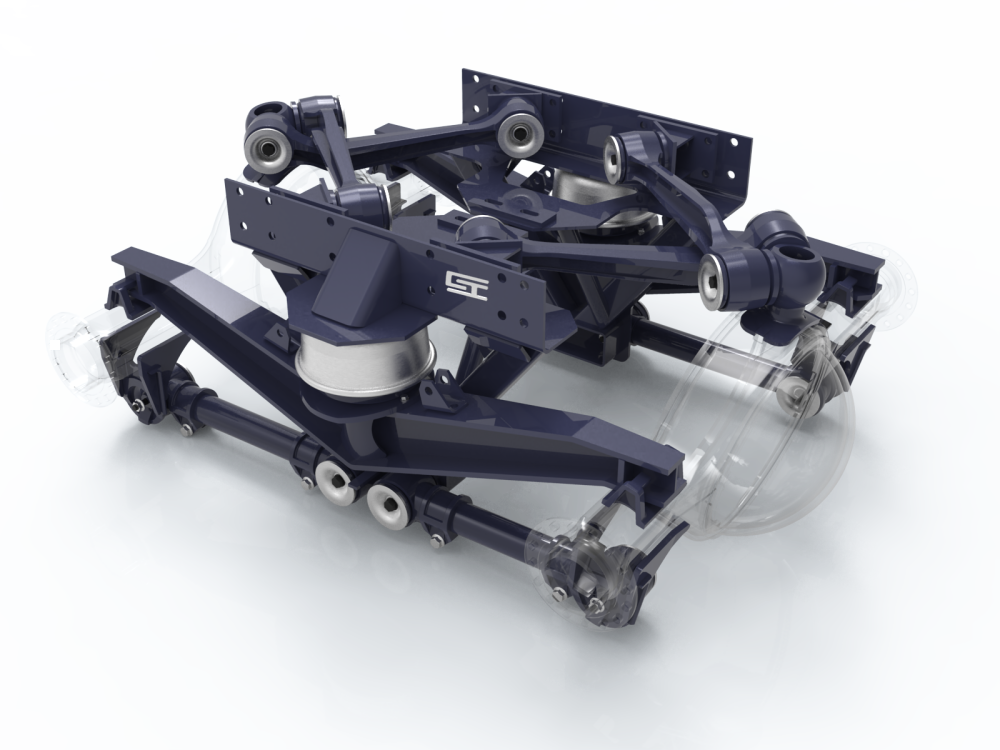

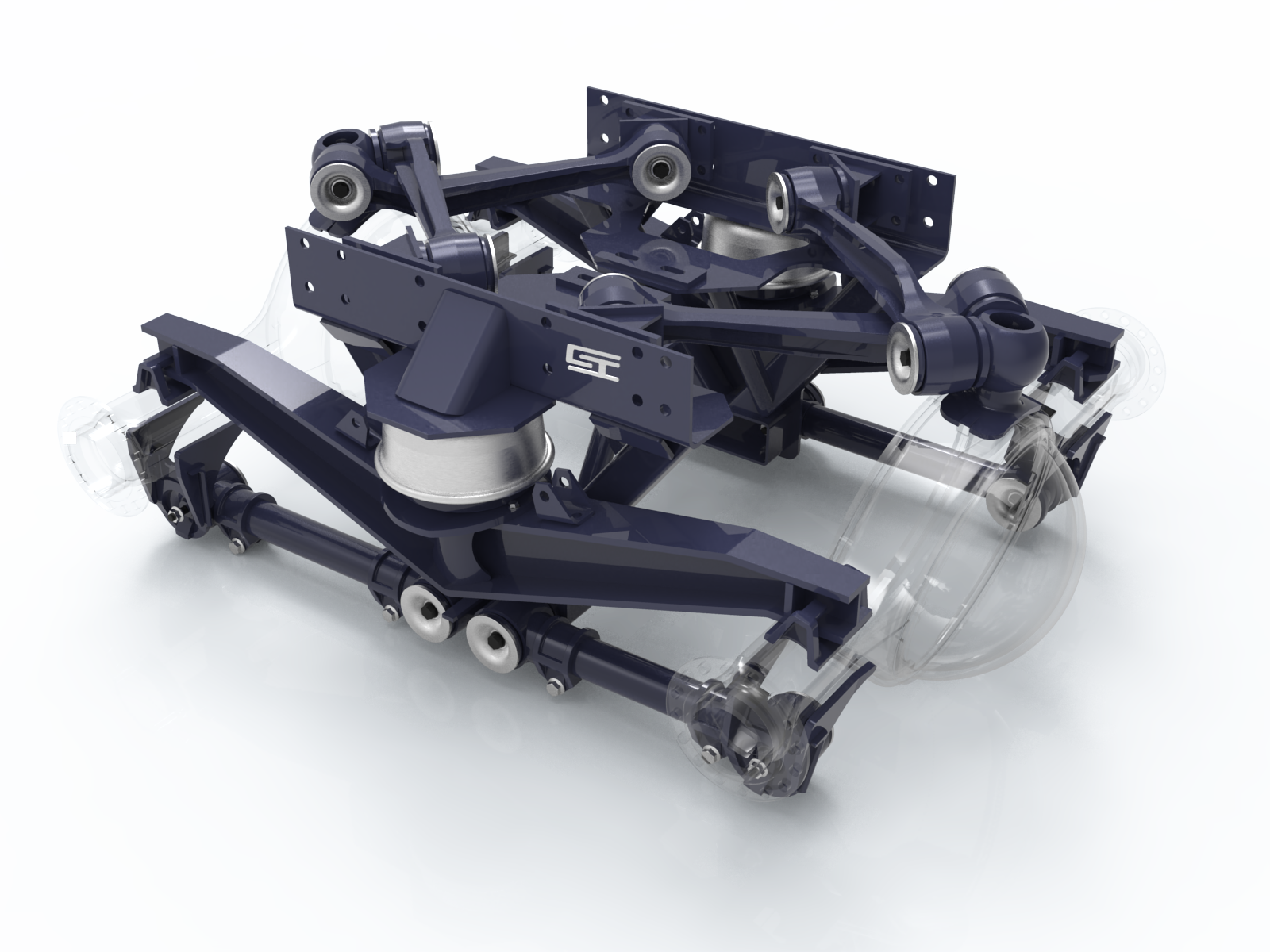

I don't ever remember seeing a Granite with 38s in it ????  Chalmbers ?  If I had to guess, I'd bet this truck has 23-160s.  Be interesting to see a picture of this truck's bogie. Come to think of it ???? I've personally never seen Chalmbers on anything in the less than 46,000 lbs range.
1 minute ago, Joey Mack said:
Heck. I don't even know what the chamlers rear suspension looks like..  i can only remember camel backs, and maybe Hendrickson HN...  Im curious..
You've seen them. They have an equalizing beam and a big rubber spring contained in a can in the center of it. 4 rods underneath and two like wishbones on the top.
