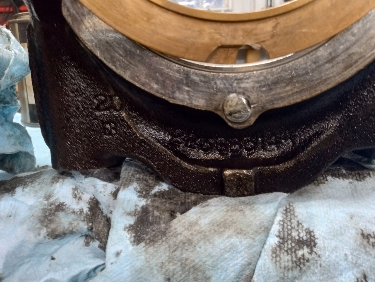

4 minutes ago, Geoff Weeks said:
clutch shaft higher also.
will the added height clear the body/cab?
Entire transmission is below the cab floor so that should not be an issue.
Larry
https://www.bigmacktrucks.com/topic/75768-300-rebuild/page/14/#findComment-587895
1 minute ago, Joey Mack said:
I see the inspection cover is on top, on the trans. Where is it on the new bell housing? Just curious...
Bottom.  I don't have to pull floor to get to it.
Larry
https://www.bigmacktrucks.com/topic/75768-300-rebuild/page/14/#findComment-587896
43 minutes ago, fjh said:
hopefully the rear holes are the same as the front on the fuller!
They are all in different area codes.  I will have to fab up mounts to get up to the Eaton mount area.  The frame mount ledge is about the same as upper mount holes in Triplex.  The Eaton is way up compared to those.
The pattern is completely different between each . See sketch.
Larry
https://www.bigmacktrucks.com/topic/75768-300-rebuild/page/14/#findComment-587899
The top of the bell is still just below the floorboard so the mount will be going down and back from the mount point on bell.  I don't see an issue with clearance.  Time will tell, I have a welder....it will all fit.
Larry
https://www.bigmacktrucks.com/topic/75768-300-rebuild/page/14/#findComment-587904
I have noticed in Australia when RoadRangers/Eaton are installed in Macks aftermarket, a rear transmission mount is also used, these range from a propper engine mount rubbber deal to a section of leaf spring out of a car or pickup as you blokes call them
These might be only 2 or three leaves, I wonder are they really needed or not ?
Paul
https://www.bigmacktrucks.com/topic/75768-300-rebuild/page/14/#findComment-587908
Not trying to say it will not work, just wanted to point out somewhere to check. The new mount is in a "different area code" as you put it, so needs checking, which it sounds like you have done.
New things in different real estate is always a concern.
https://www.bigmacktrucks.com/topic/75768-300-rebuild/page/14/#findComment-587909
Paul.. The single leaf spring at the rear of the main box was used here as well.  Ive seen it in Ford's and Freightliner's, I think Int.'s also.
https://www.bigmacktrucks.com/topic/75768-300-rebuild/page/14/#findComment-587910
Paul
Generally, here if the rear mounts are on the engine 1/2 of the bell, a rear transmission "leaf spring" type or rubber bisket mount is used. On set-up's where the rear mount is on the transmission 1/2 of the bell (thinking Volvo/White) then there is nothing at the rear of the transmission.
It may have something to do with how much weight is cantilevered off the back of the bell housing, esp when aluminum housing are used.
Just an observation
https://www.bigmacktrucks.com/topic/75768-300-rebuild/page/14/#findComment-587911
