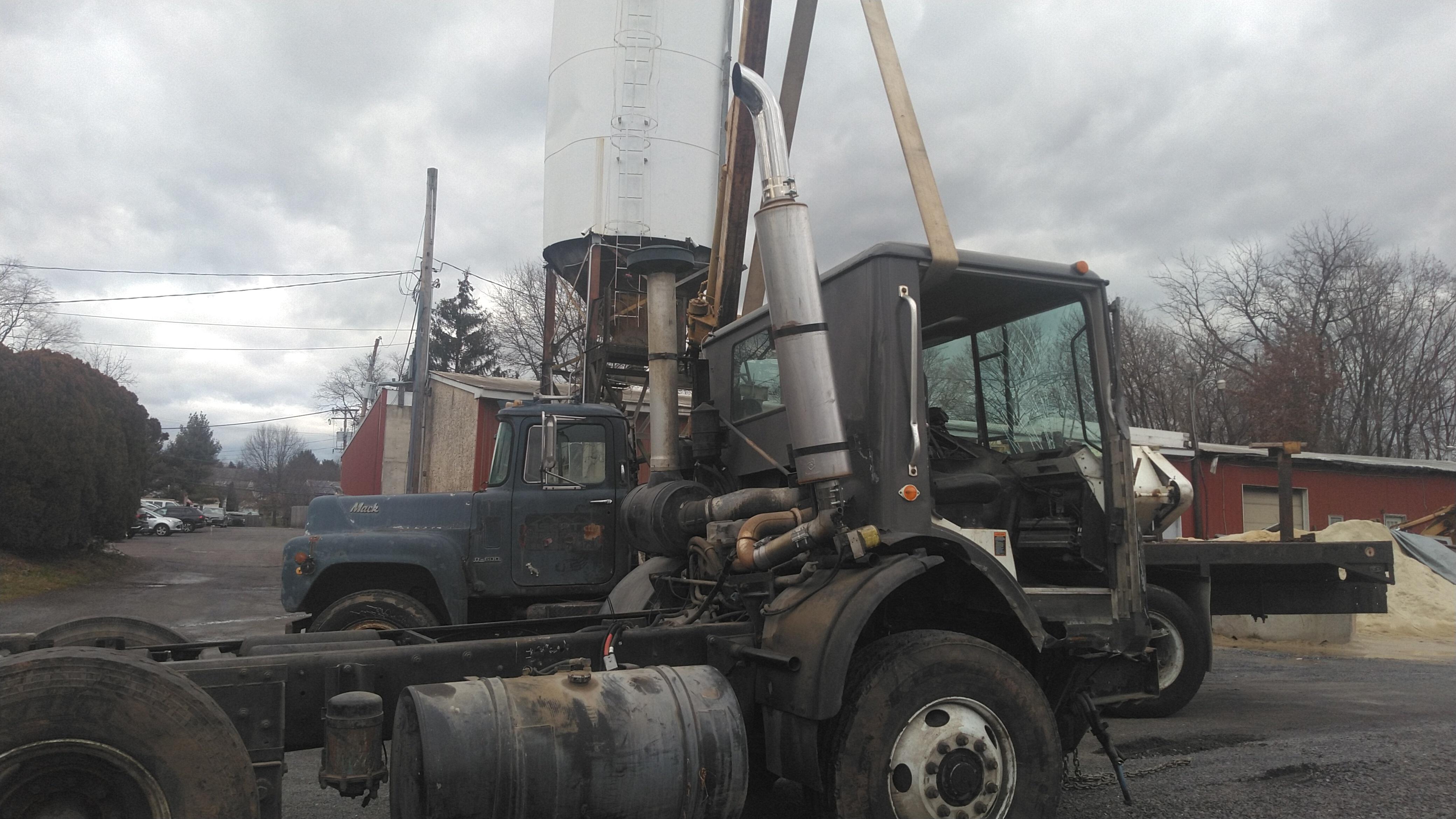

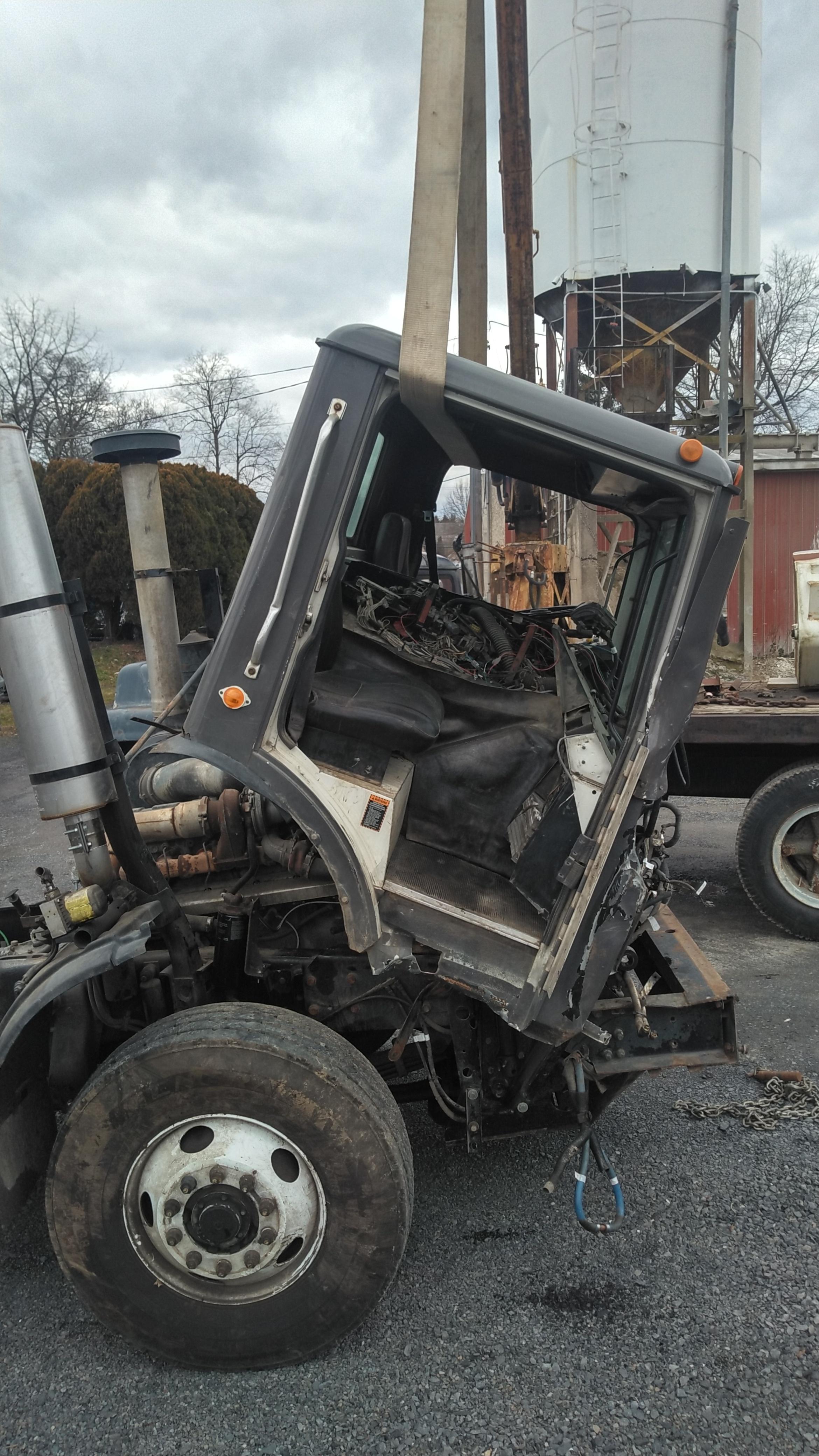

Truck got put in the ditch Nov 11th 2023, busted the cab pretty good.  Most of the obvious damage to the cab was to the passenger side, but from the twist applied from impact, the driver side of the cab has some buckling and cracking in a few places. KIMG1749.thumb.JPG.92ccf6da69cace2dc06b241c5ea8b884.JPG
Secondary fuel filter housing magically disappeared in the accident, ripping the ends off the fuel lines, which is a good thing because it helped starve the engine for fuel so it didn't idle too long on its side.
I pulled the crushed passenger door and unbolted the crushed step assembly the other day.

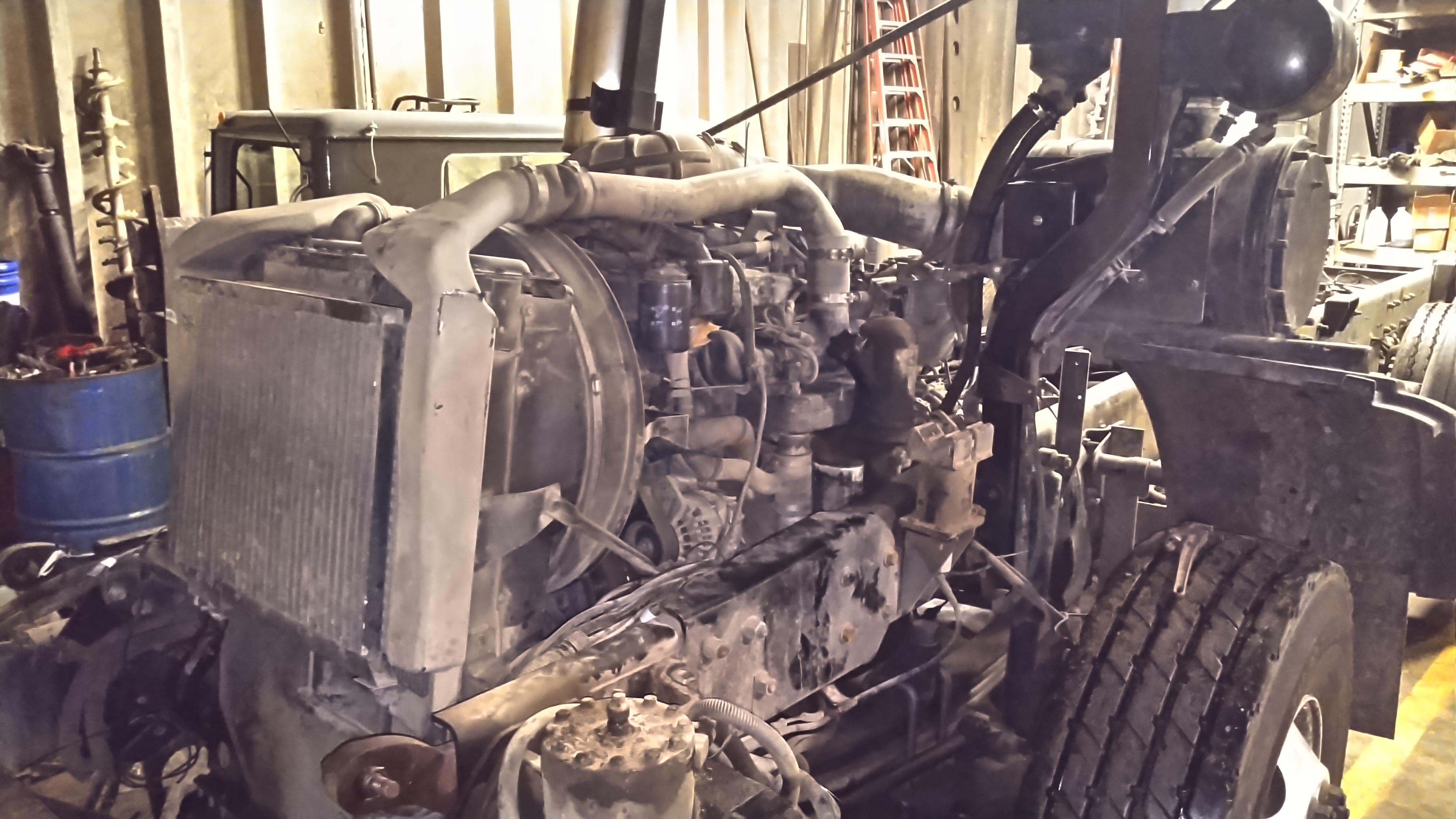

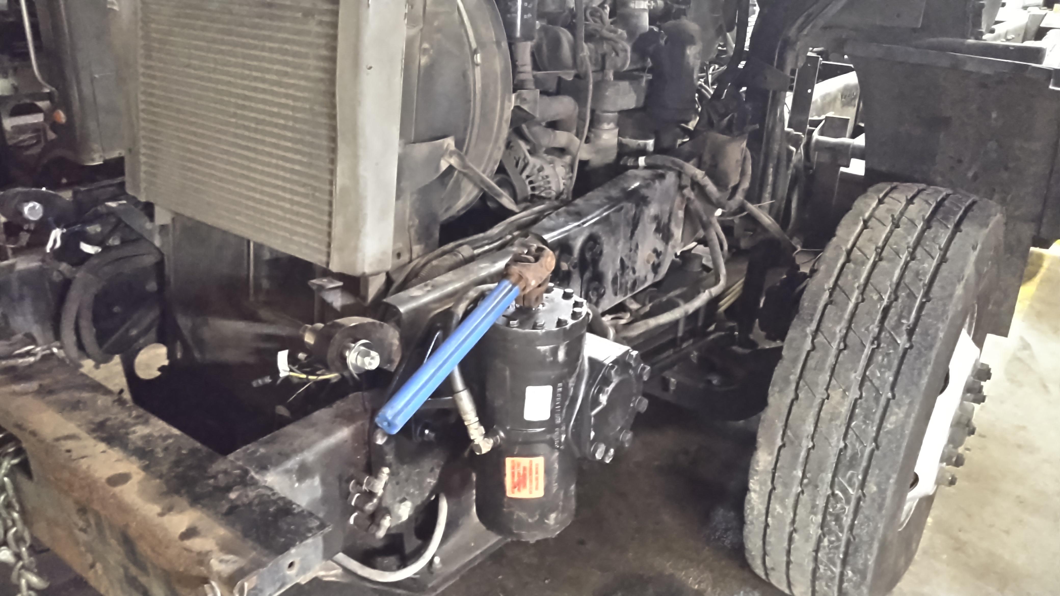

Today we pulled the secondary filter housing off the replacement cab cutoff assembly we bought a few weeks ago, replaced the damaged fuel lines, installed a new secondary filter (I guess we should have done the primary filter while we were at it...), primed it up, hooked up the laptop, and turned on the key. All active codes are related to the torn ABS sensor on the passenger wheel. New sensor gets picked up in the AM on my dad's way in to work. (Hopefully we can get all the codes cleared up before we have to start gutting the cab.) Engine shutdown light was on, a bit of coolant and that went away.
Engine wouldn't start, laptop showed voltage dropping below 9.5v, which I think is about where the EECU won't fire off.  Battery charger on, my dad shot a little ether in the intake, and we managed to stop cranking while it was chugging on ether, and with the voltage spike back up to normal I think the EECU was able to kick in and start firing in some diesel! It coughed through whatever air got into the injector lines and the idle steadied right out.
We pulled the bumper, pulled  heater core hoses and butted them together, pulled the passenger cab latch off, rear engine heat shield, scratched our heads a few times, and called it quits. Not rushing into this too aggressively, it's a bit of a Gordian knot. I'm not Alexander the Great, so I won't be untying this one with a sword.
All looks good on the electronics side, so now we have a baseline of systems functionality before we gut the cabs and put all our wiring from this cab into the replacement cab.

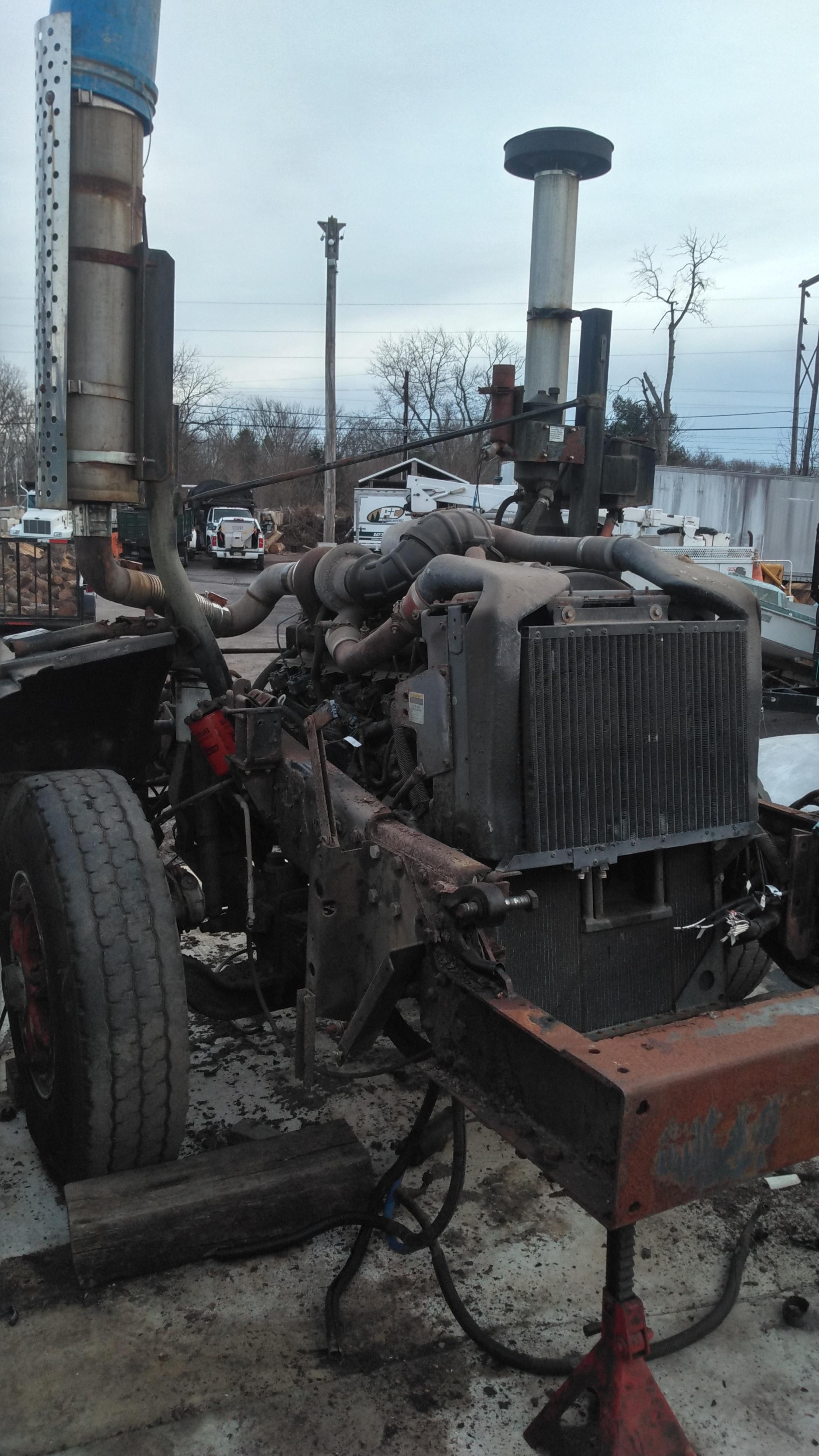

Need to pull the spare cab off the cutoff, steal whatever we need for the radiator/CAC assembly on this truck, install/gut new cab, swap guts from our cab to the new cab. Hopefully we can work in a coat of paint on the new cab before it goes onto the truck.

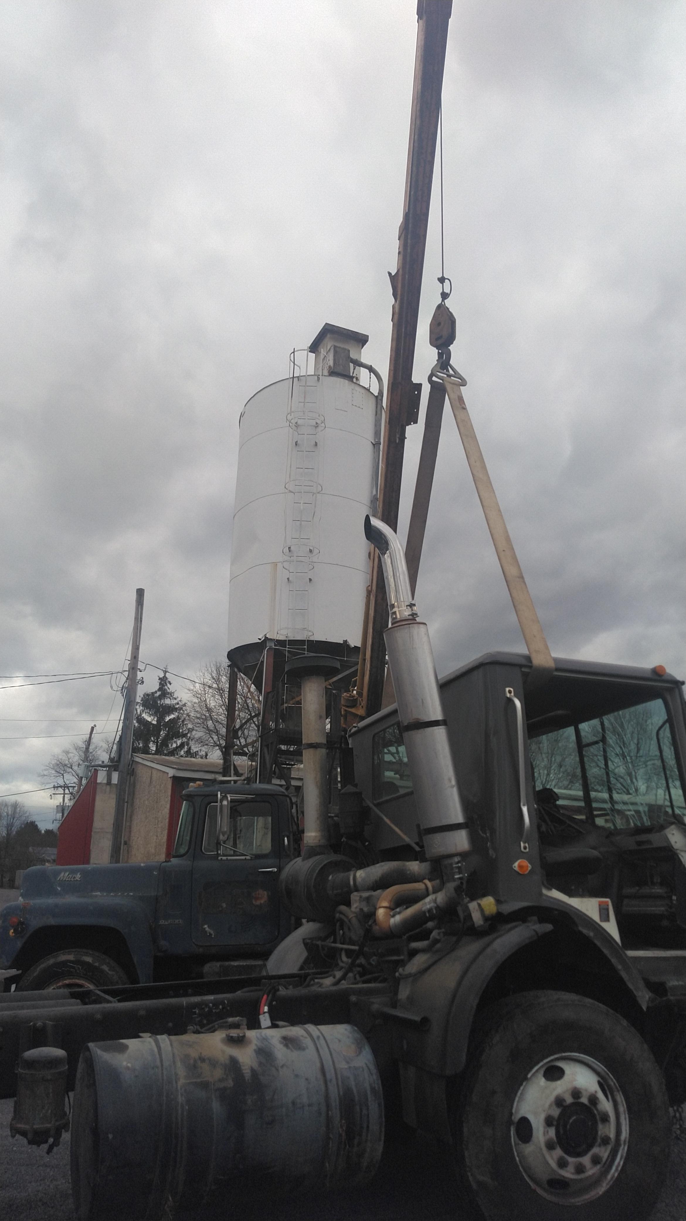

I see from your photos that you’ve pulled the mixer off. Was there much damage to it?

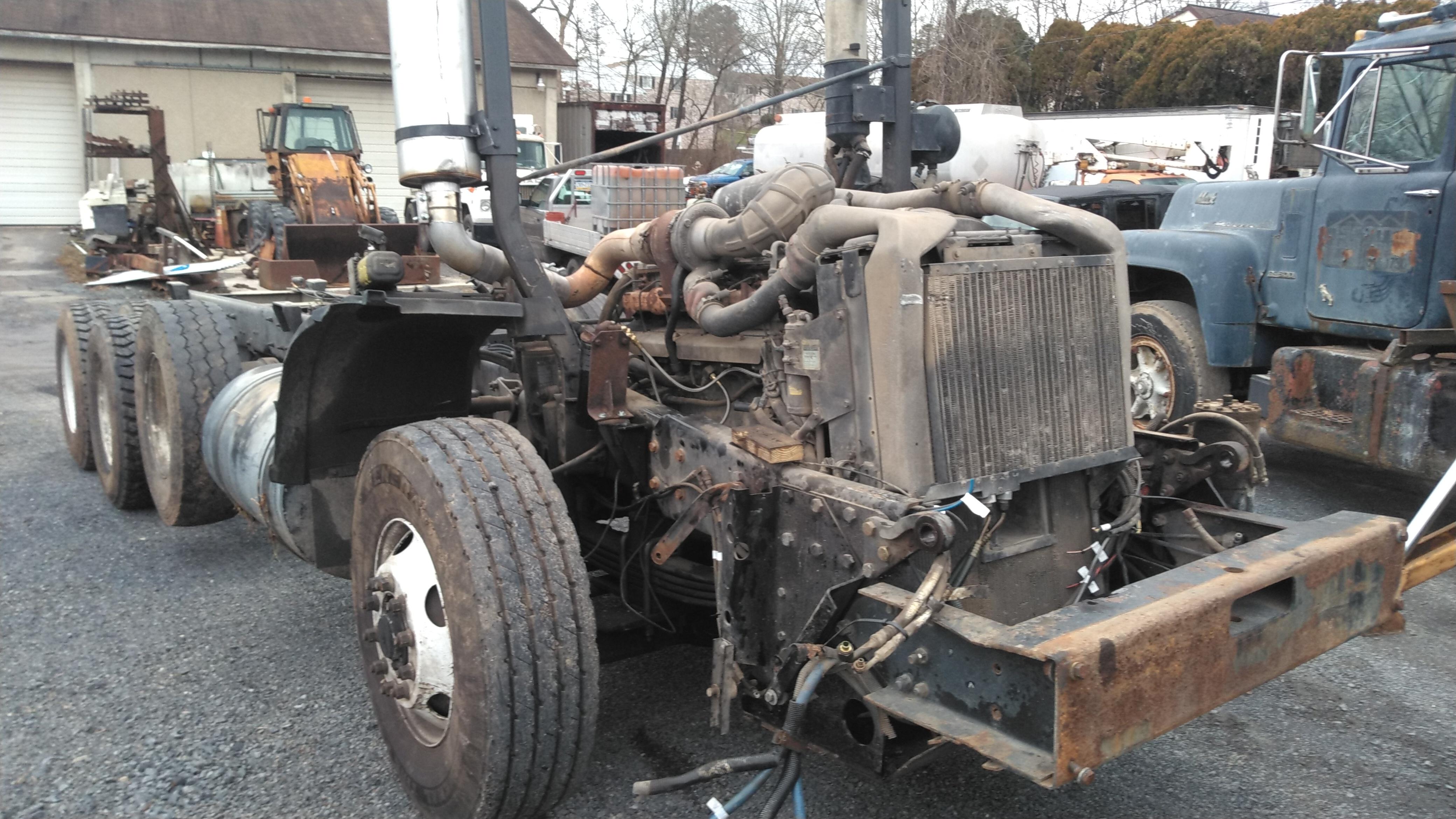

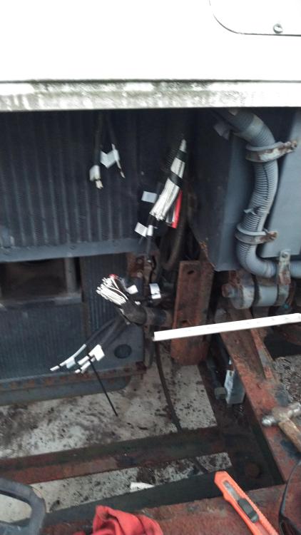

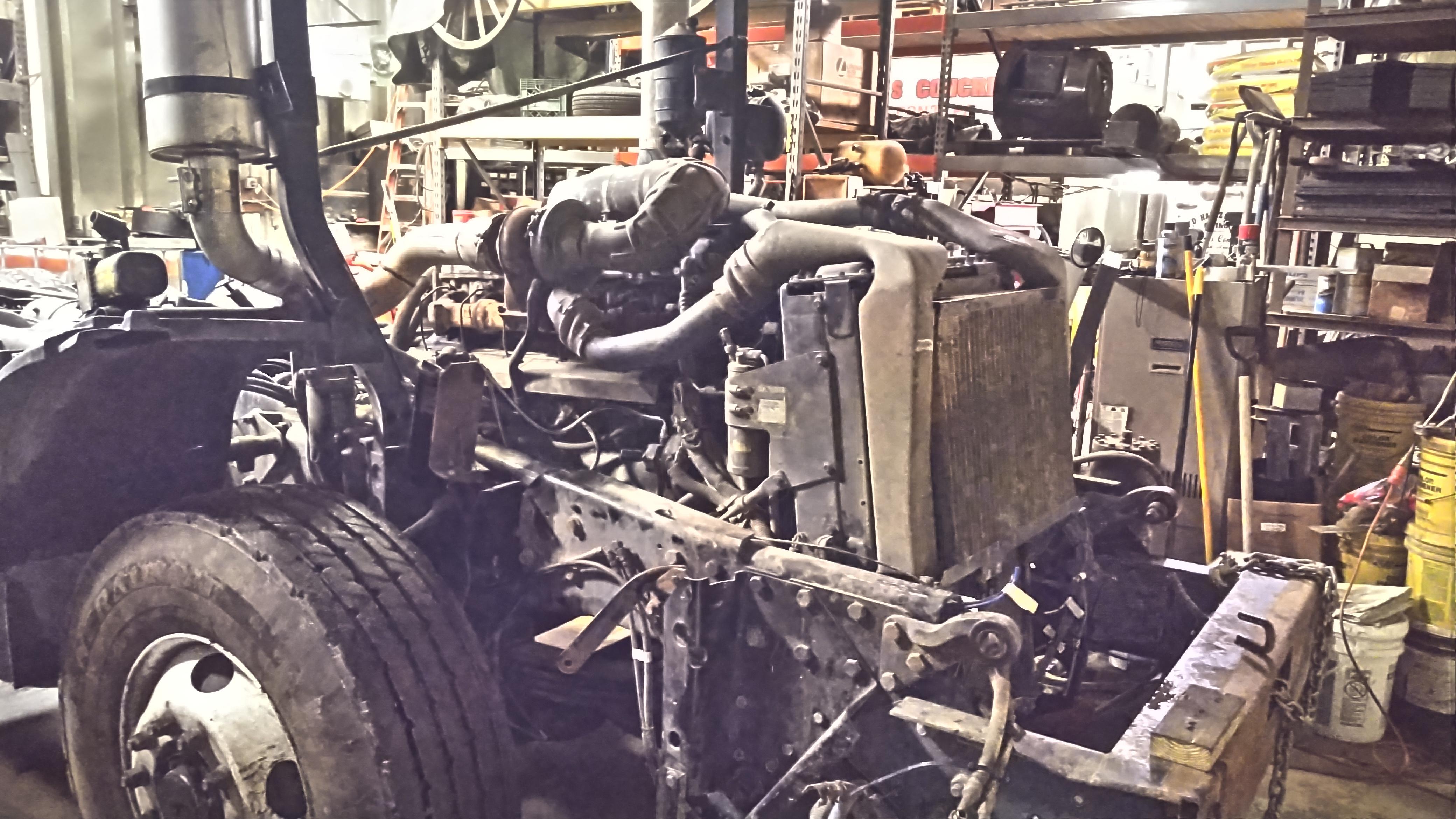

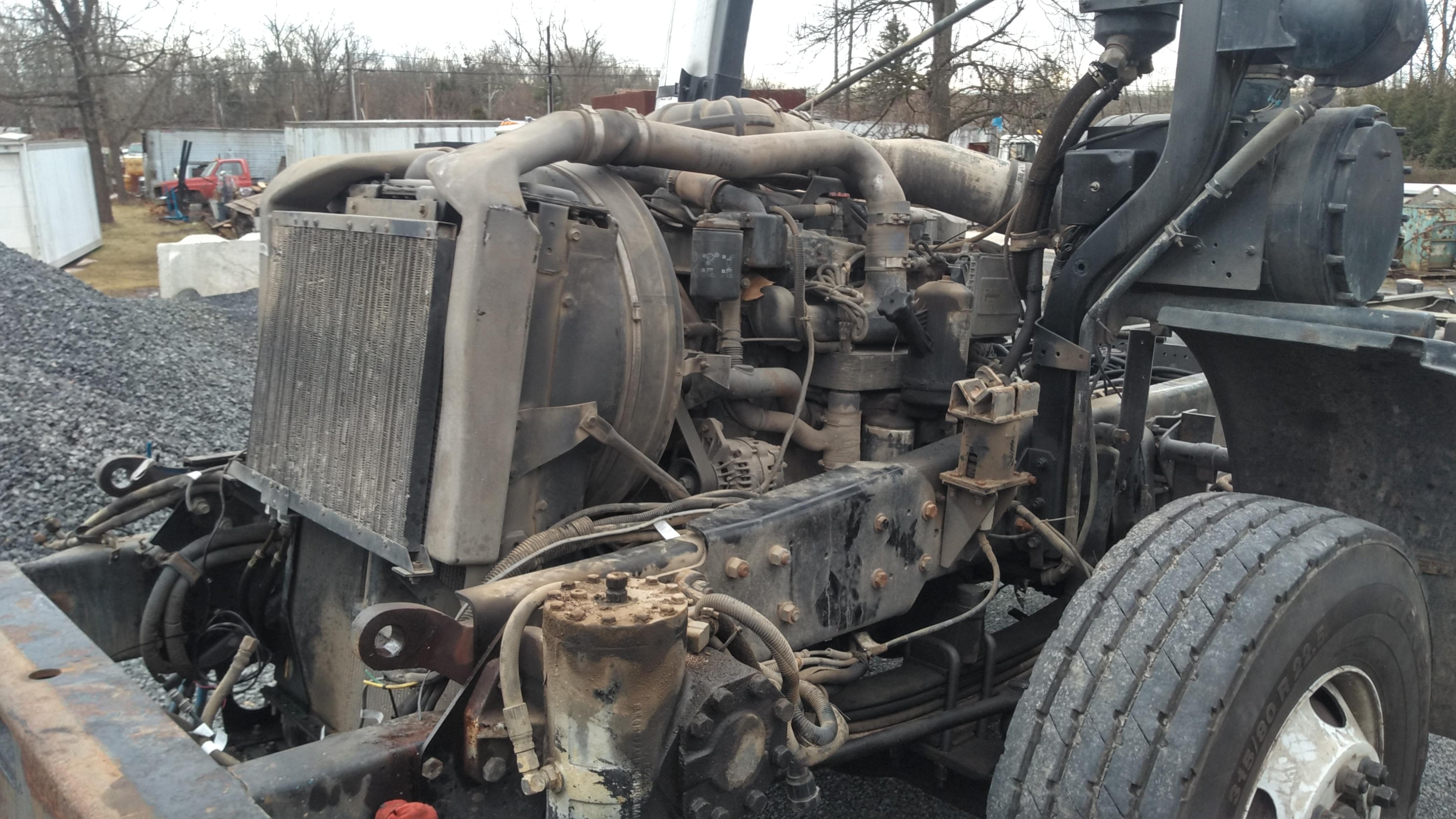

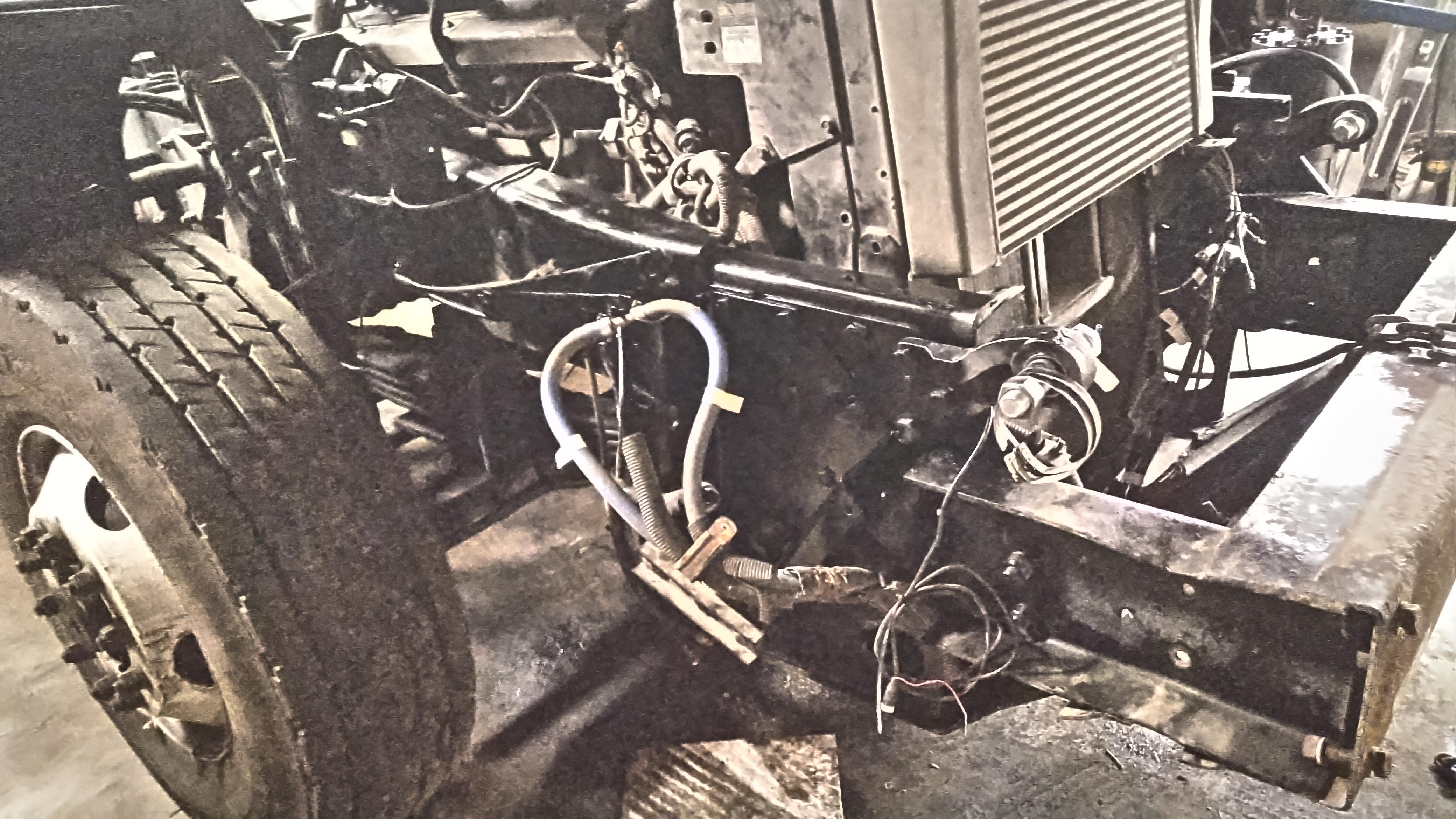

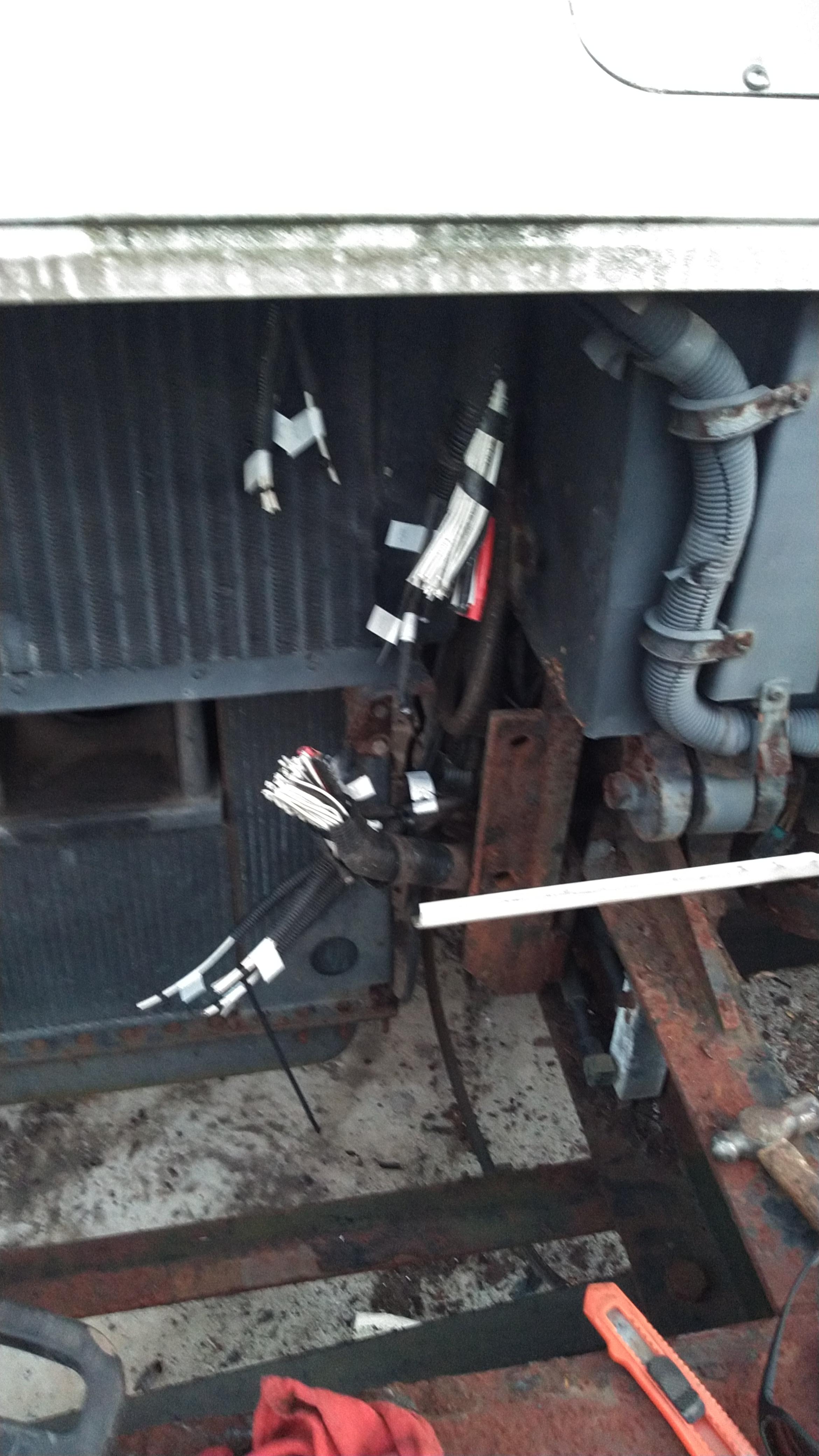

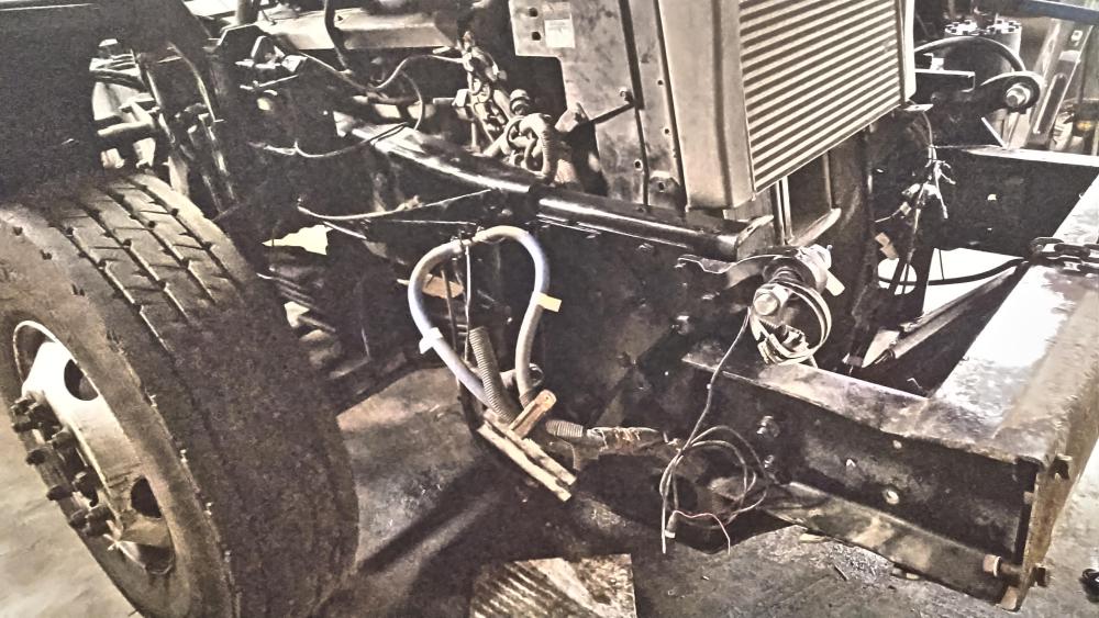

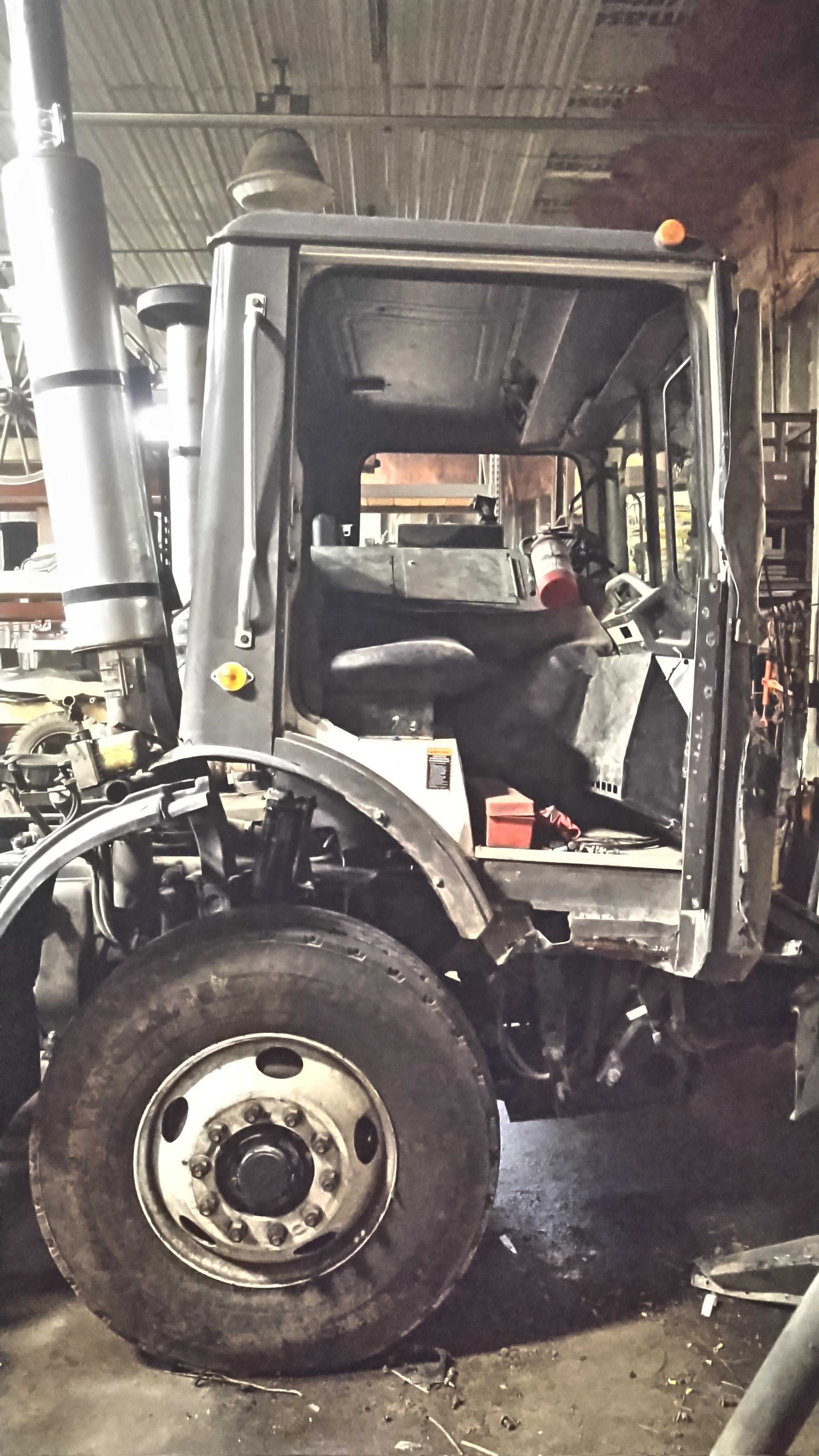

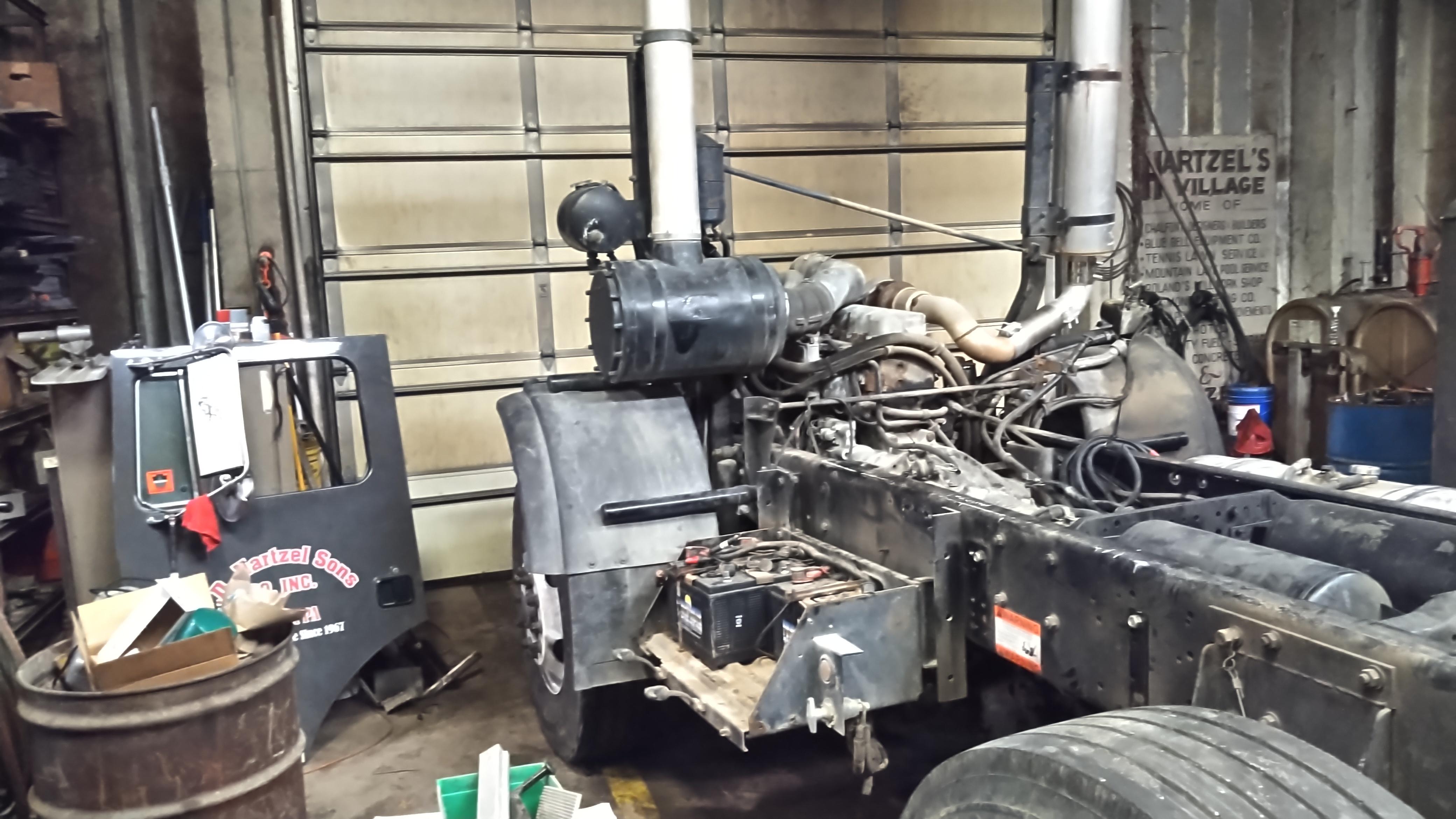

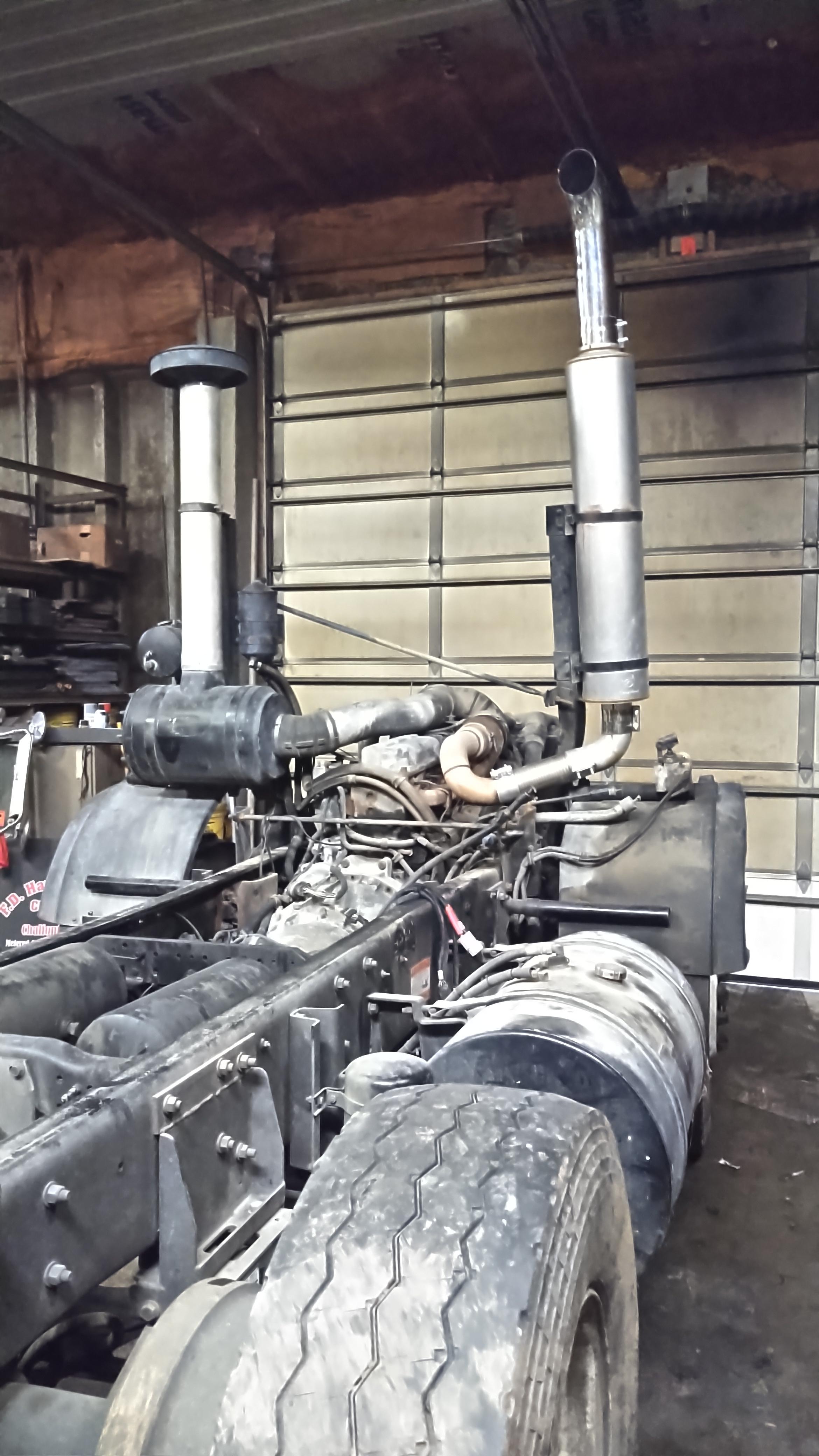

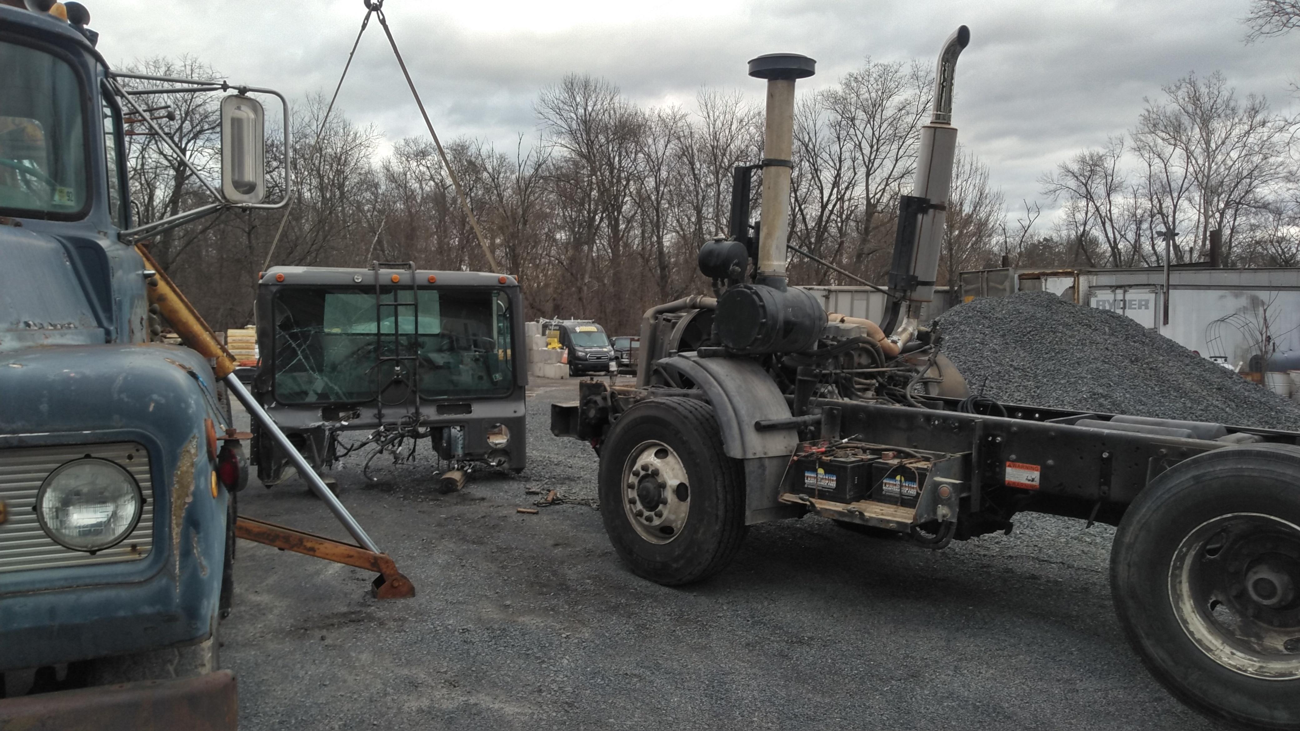

I had hoped to avoid Plan B on the cutoff, but seeing as we couldn't get any of the aluminum bulkhead connectors to unplug, I had to cut the big harnesses on either side.
About all that remains is the oil gauge pressure line going to the cab from the filter housing and the transmission shifter cable. Should get those done pretty quick tomorrow afternoon after concrete, then hopefully we'll have time to lift the cab off the chassis and get ready to bring it into the garage to strip down, patch a hole in the floor, and a few other things to get it ready to go on the truck.

Mixer is largely fine, a little porta-power work, a little welding, and a couple small covers and the mixer should be (almost) good as new.

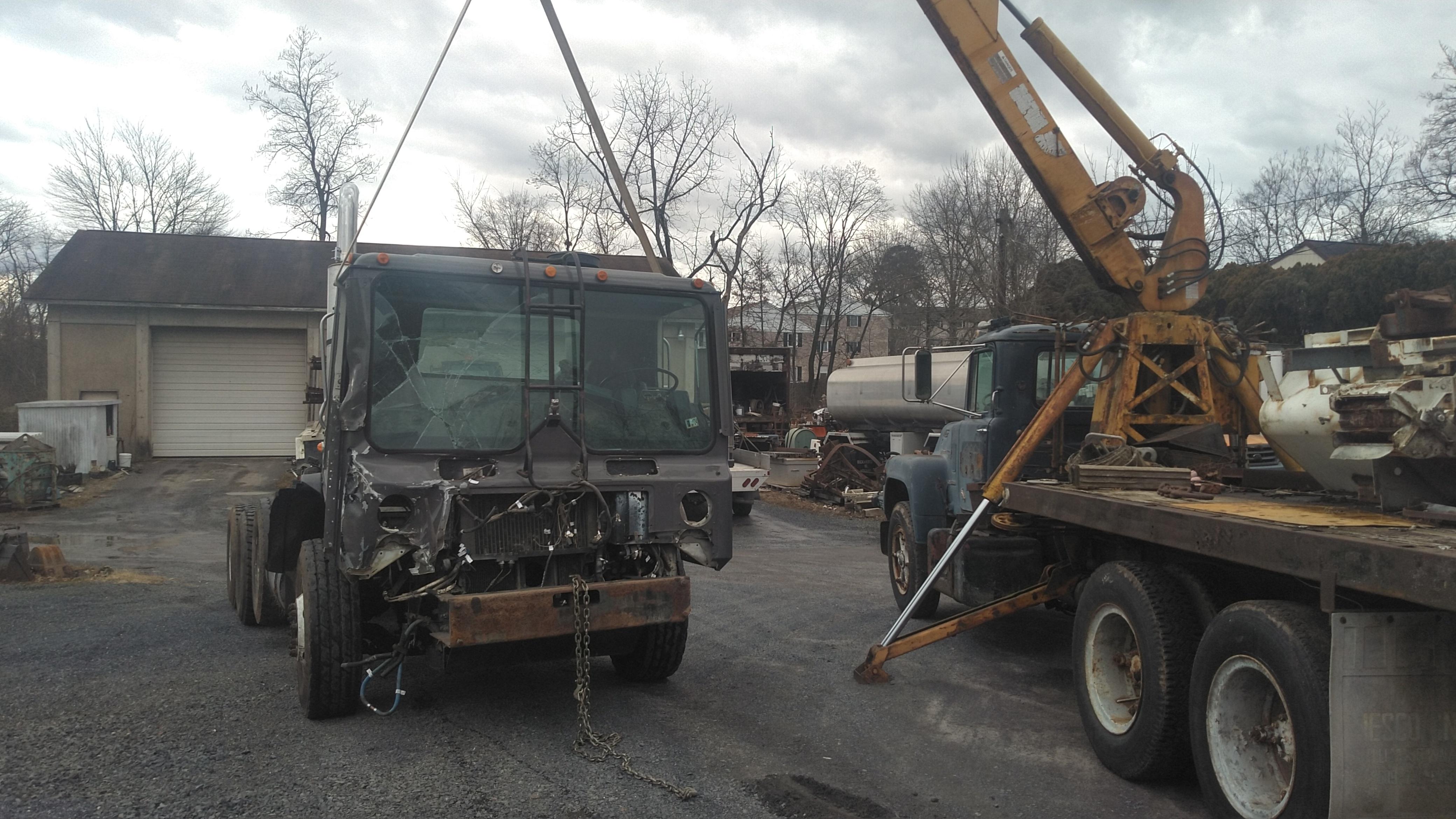

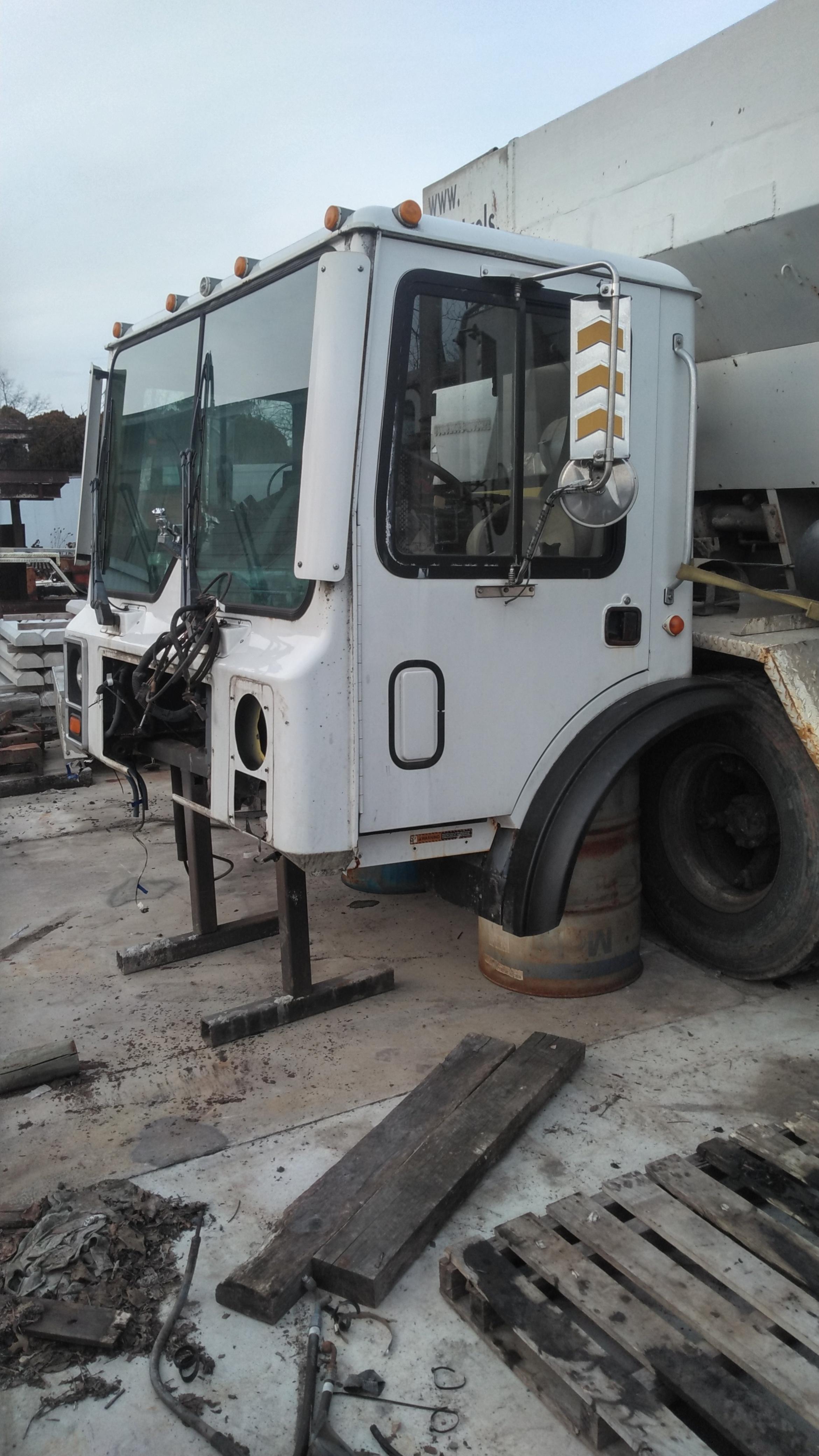

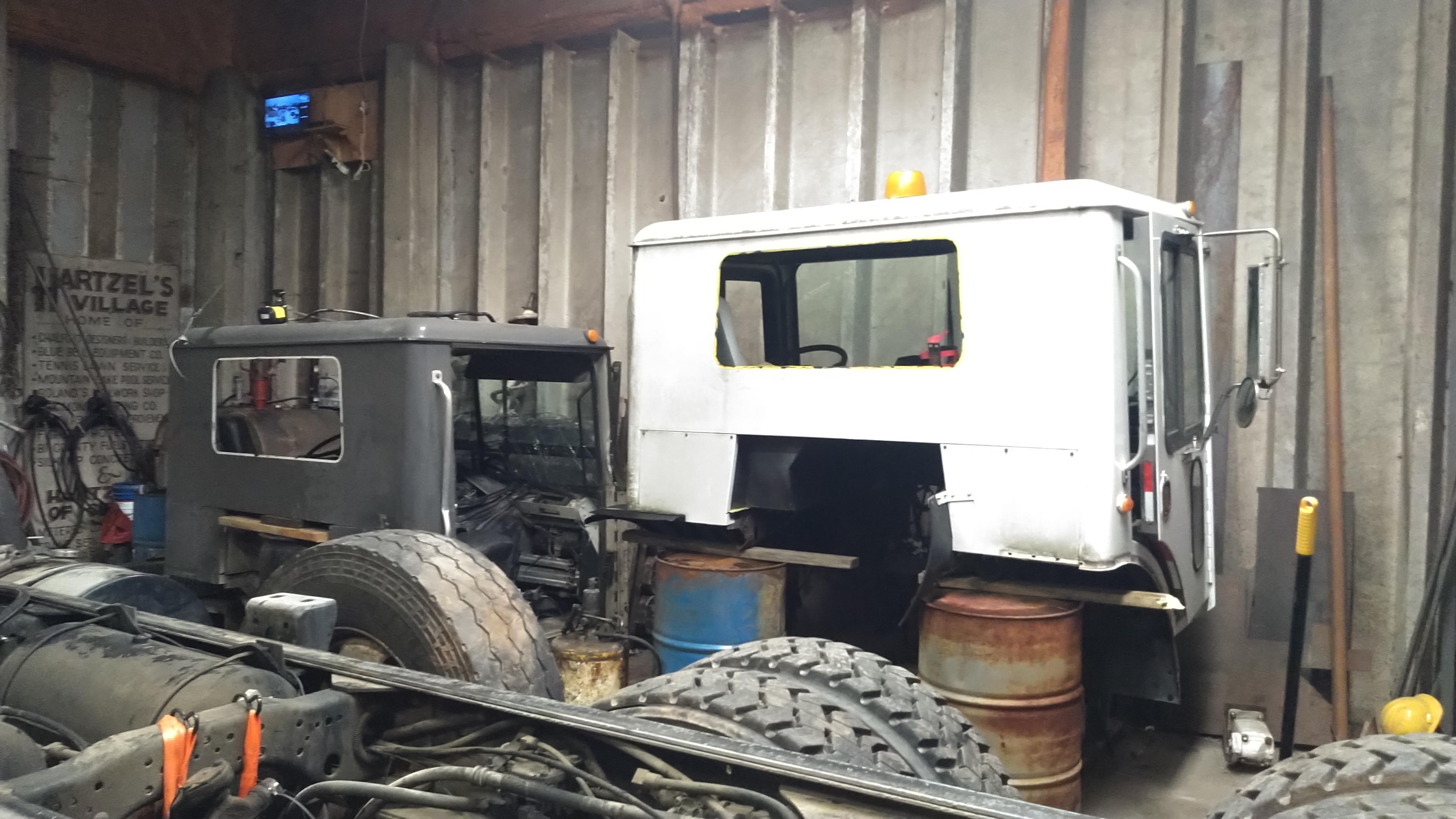

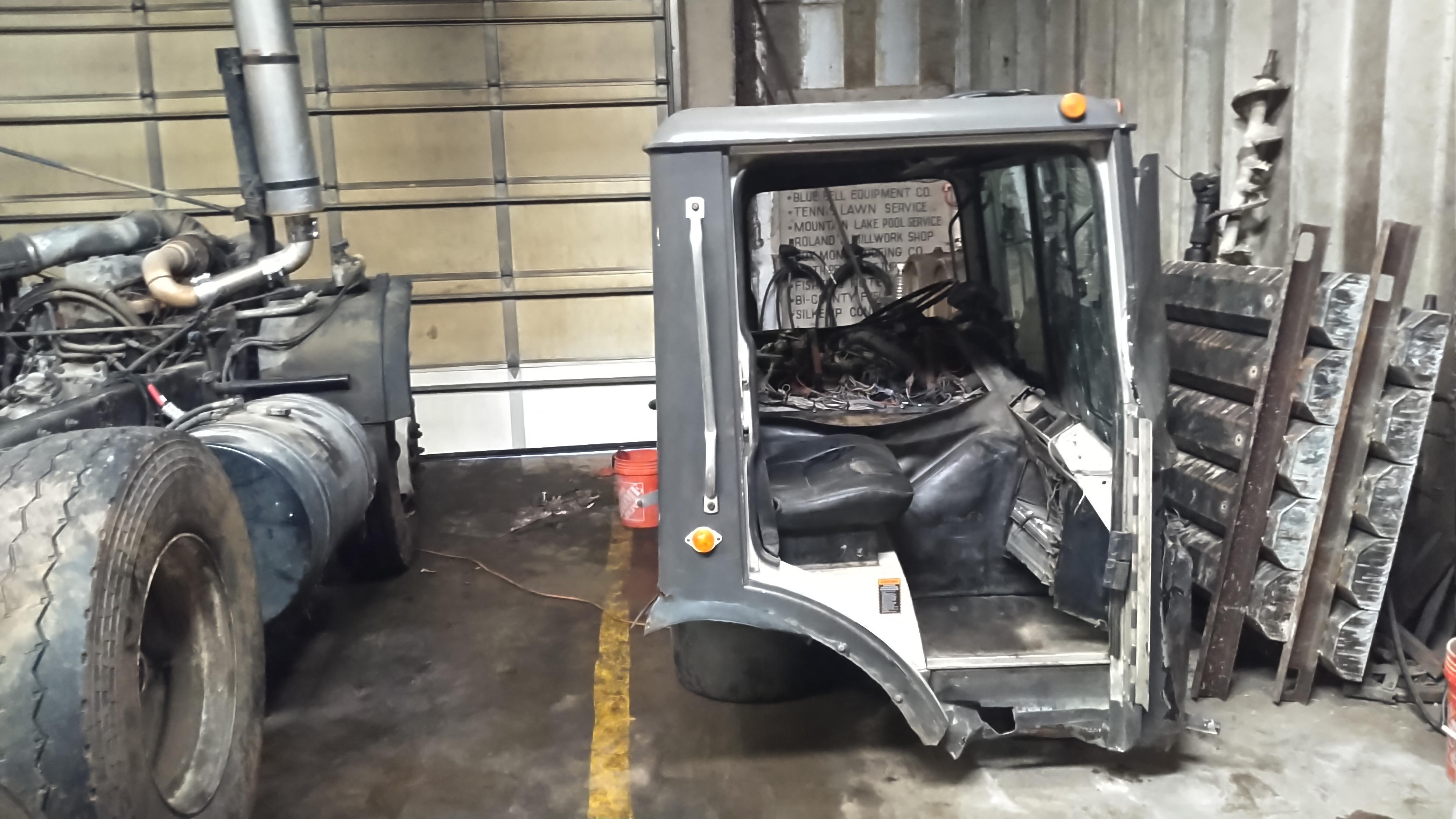

Cab is off the cutoff. Hopefully we will get it into the garage on Monday so I can start stripping it down. Might be a bit of a juggle to decide what to put where in the garage. Might make a wooden cradle of sorts on wheels to hold the new cab that my forklift can pick up and move around.

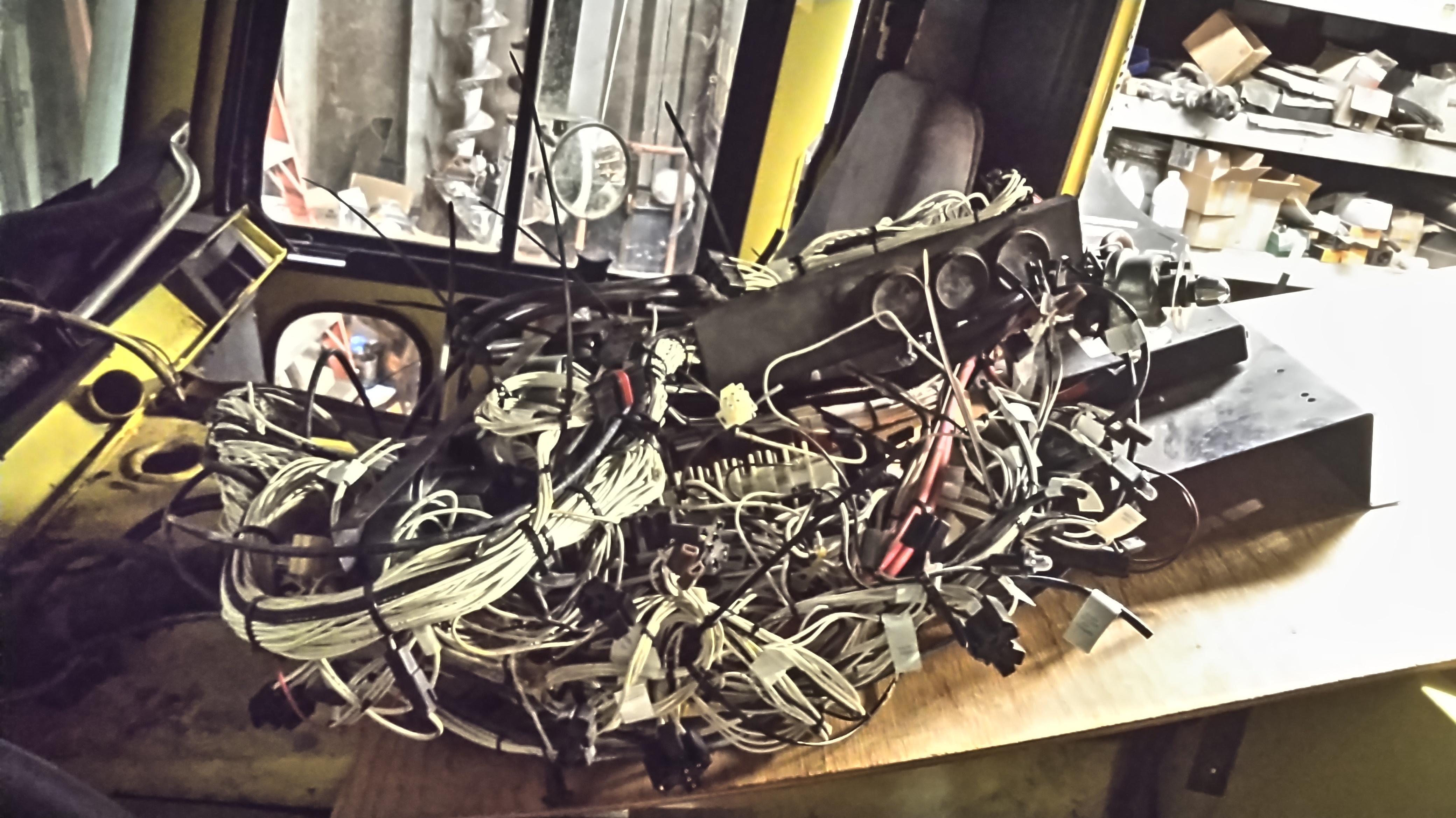

I'm about $200 into a label maker, between buying it and buying 4-5 roles of the vinyl cartridges that go in it. Pricey, but the utility value is massive.

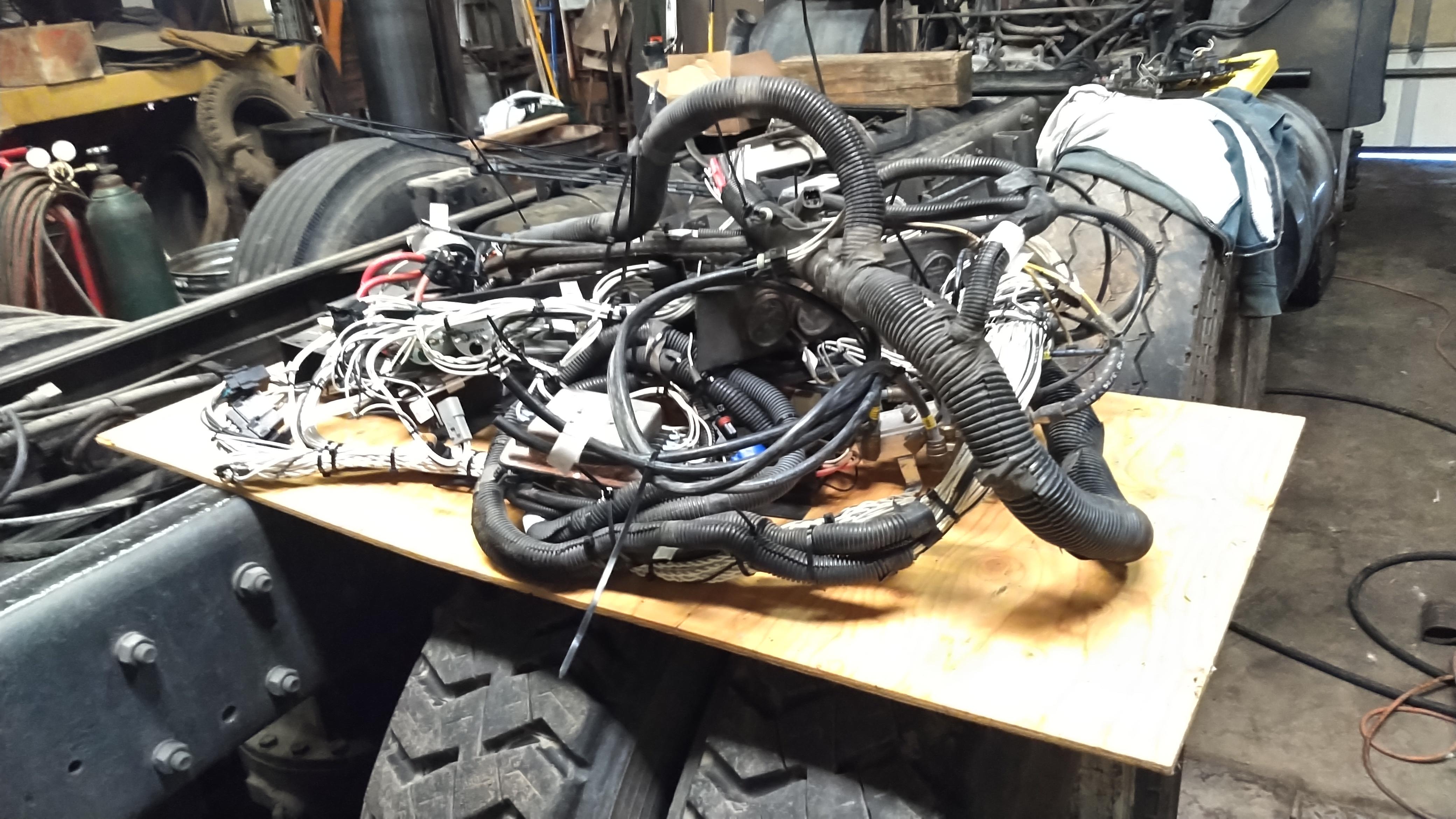

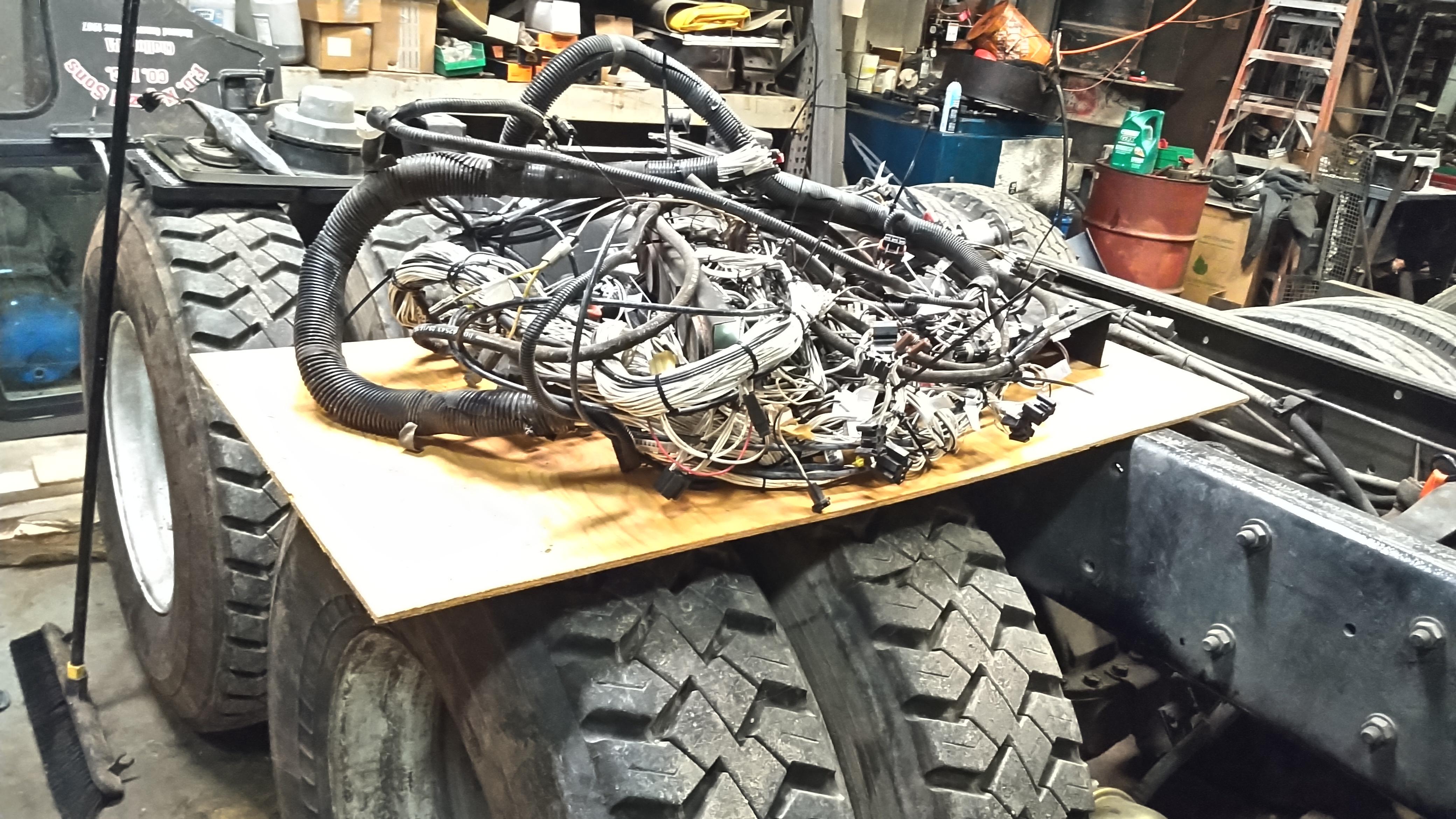

This harness will go into storage incase we ever need to utilize it and the engine. I'm sure hoping everything works once I get it all together.

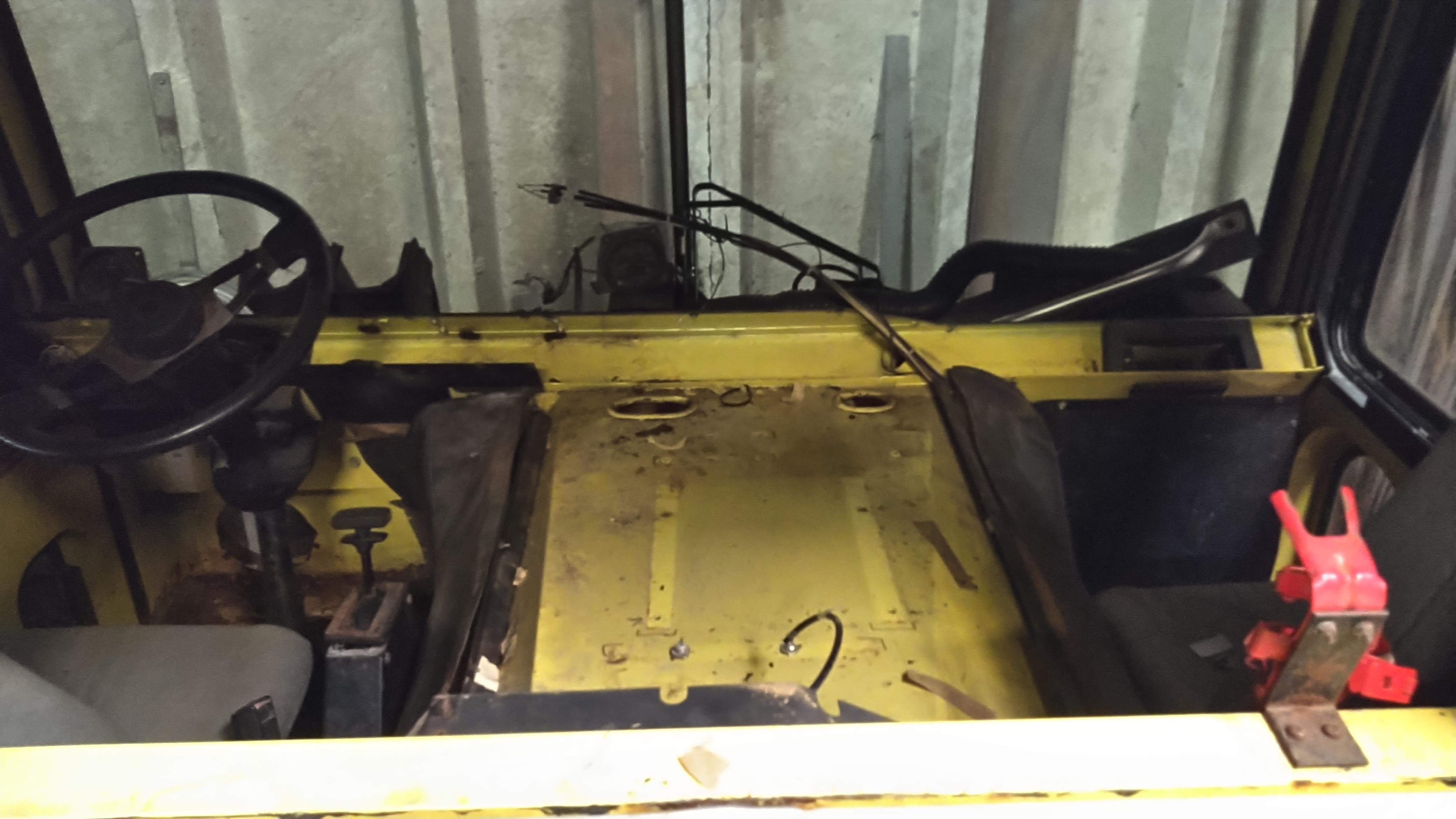

Still need to strip this cab down further, patch a hole in the floor, replace some seized rivnuts, pull windshields, sand down and paint the cab, and a myriad of other tasks. Probably needs a heater core.
The rear window in this cab was a slider, but I'm opting to put the solid rear window from our busted cab into it instead, since the VECU is located just inside the rear window.  Not taking any chances on rainwater finding it's way to the VECU.
