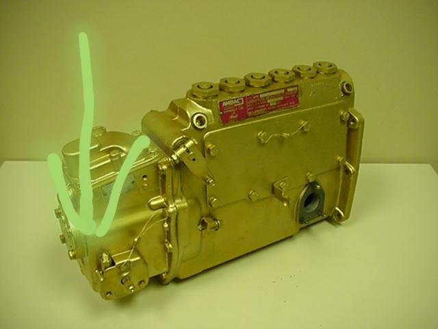

Okay, simple answer is pull some shims out of here 20231212_212326.jpg.fcd58e60521df8a9f4684b0a80fb79c8.jpg
The round doo hickie with 4 bolts thru it
This will put more tension on your governor spring so the motor revs harder before the rack starts to close the pump off
Pure WAG (wild ass guess) from a dumb ass but I reckon you'll see a result
Paul

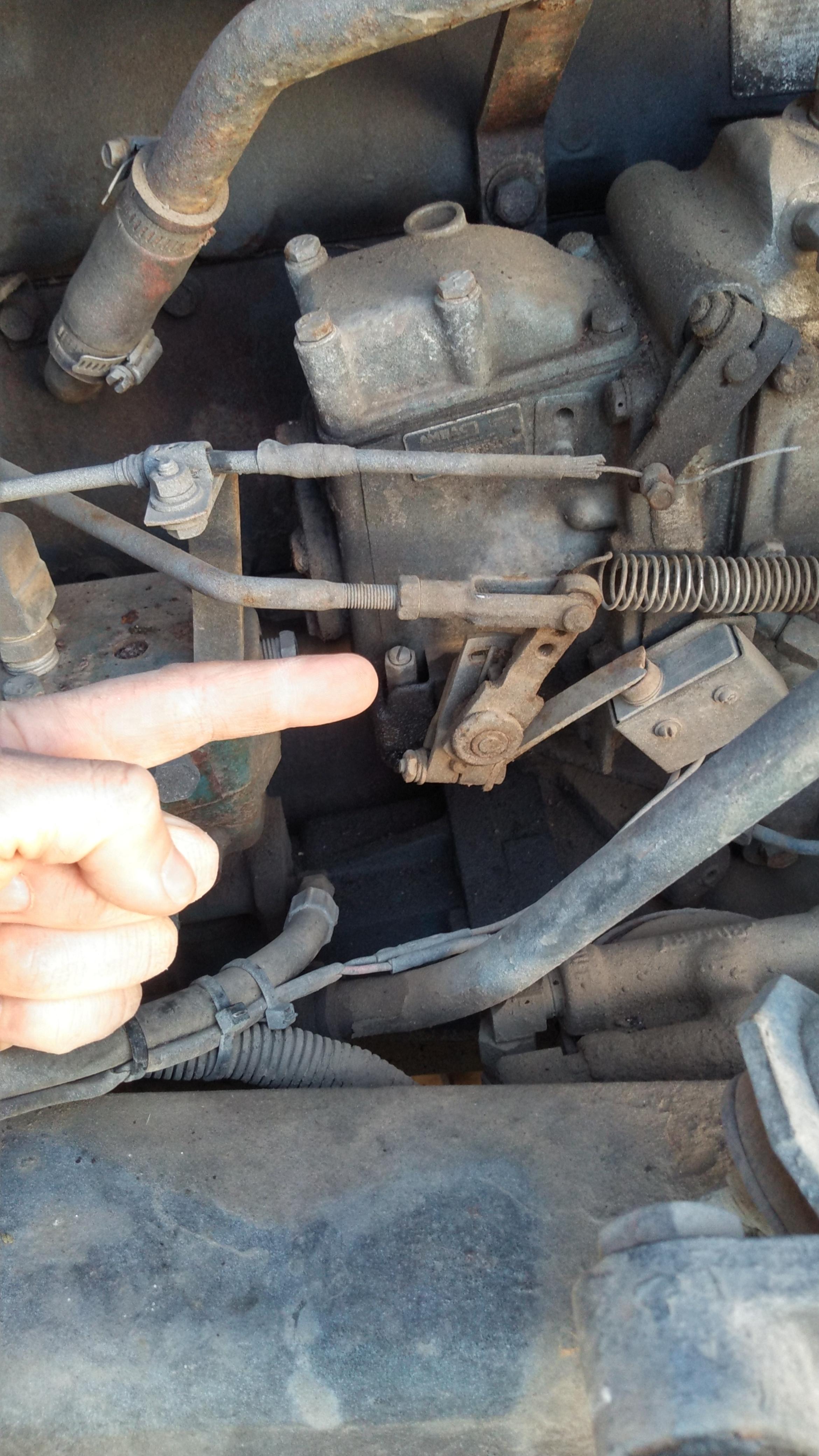

On 12/11/2023 at 2:10 PM, JoeH said:
yes it is..  the slotted screw adjust engine speed and the outer nut is the jam nut, for lack of better words..  you loosen the jam nut, then set the idle speed with the slotted screw then,,, when your happy,,, hold the slotted screw with the screw driver, and lock it down with the outer nut..
I used to use a photo tach and reflective tape on the balancer to set RPM... sure wish I had that tool today...  Jojo
