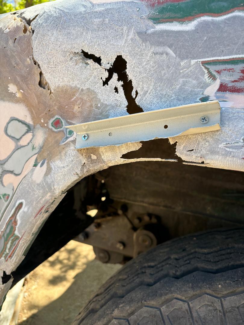

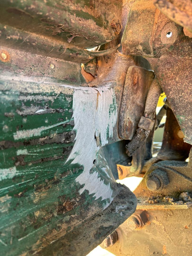

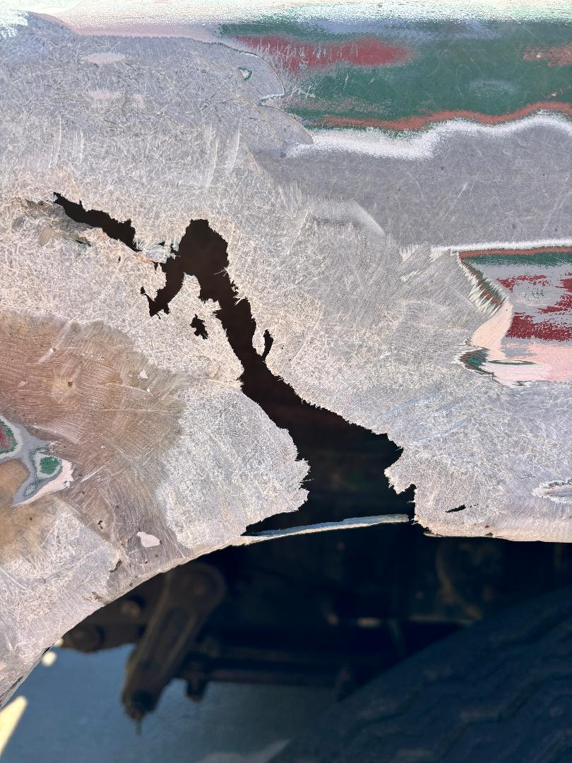

worked on it a bit,,,focused on these 2 areas for now,ive grown to figure out,if i continue to grind out the entire section,its tore up so bad,and repaired so many times,the entire corner,will fall apart and loose its shape,so ill have to start here,as it is,i had to make up this chicken shit little bracket to hold the shape,,,i was going to work on it a little longer,,but its getting late,and bees started following me around,,,im off thursday and friday,i will jump on it some more and lay fresh fiberglass on these 2 areas ,,,bob
I would pick one of those areas and concentrate on it until it's got some structural integrity. Brace all those soft areas first to keep the hood's shape. Bracing doesn't have to be pretty, what you did there is fine. Be careful with some of those fiberglass chemicals, they can be very hazardous to you. It is pretty rough, but don't look at the whole thing, just where you're working. You'll get it done, one repair at a time.
