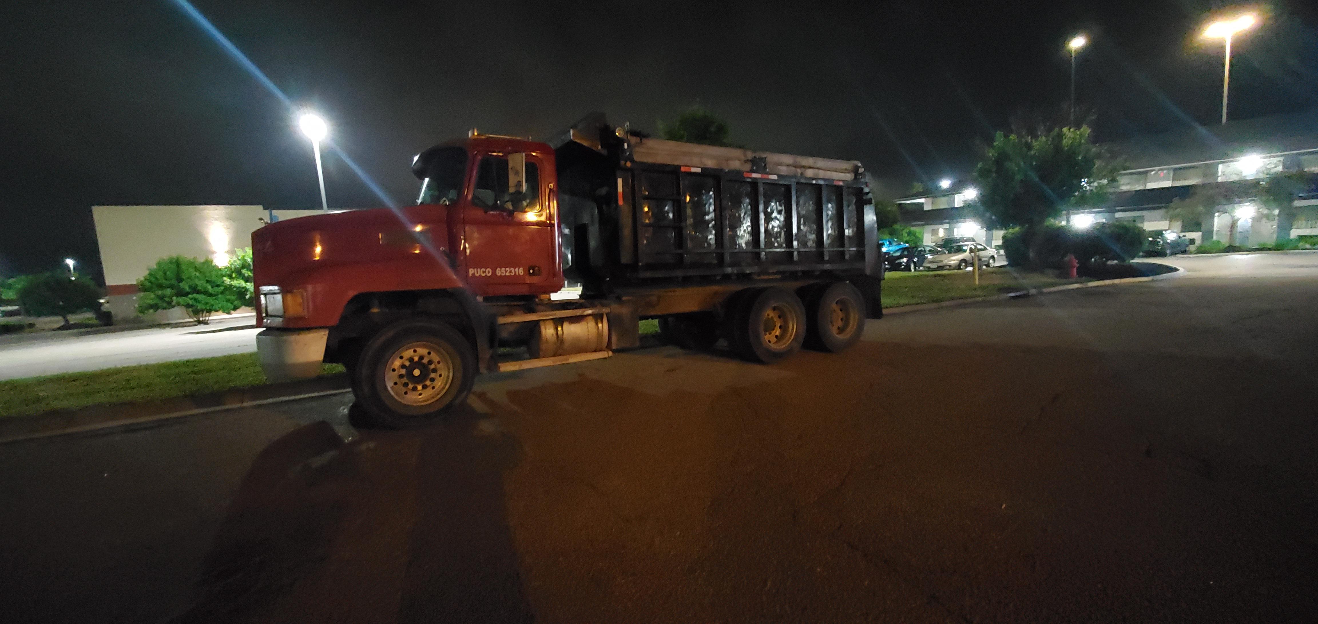

Is a mack super 10 and a super 10 the same? If not what's difference..
Getting ready to pull the trans. 96 ch614 e7.. anything big that's different than a regular cummins and trans in a kenworth/pete/freightliner that I've done before?
Thanks
Just curious,  Is it a Mack tranny?  I dont recall super 10 in the Mack tranny's..   However Eaton has a super 10 top 2..  I have also never seen a CH-614..  Does it have 3 Drive axels?  I would love to see pictures of it..   Welcome aboard...  Jojo
