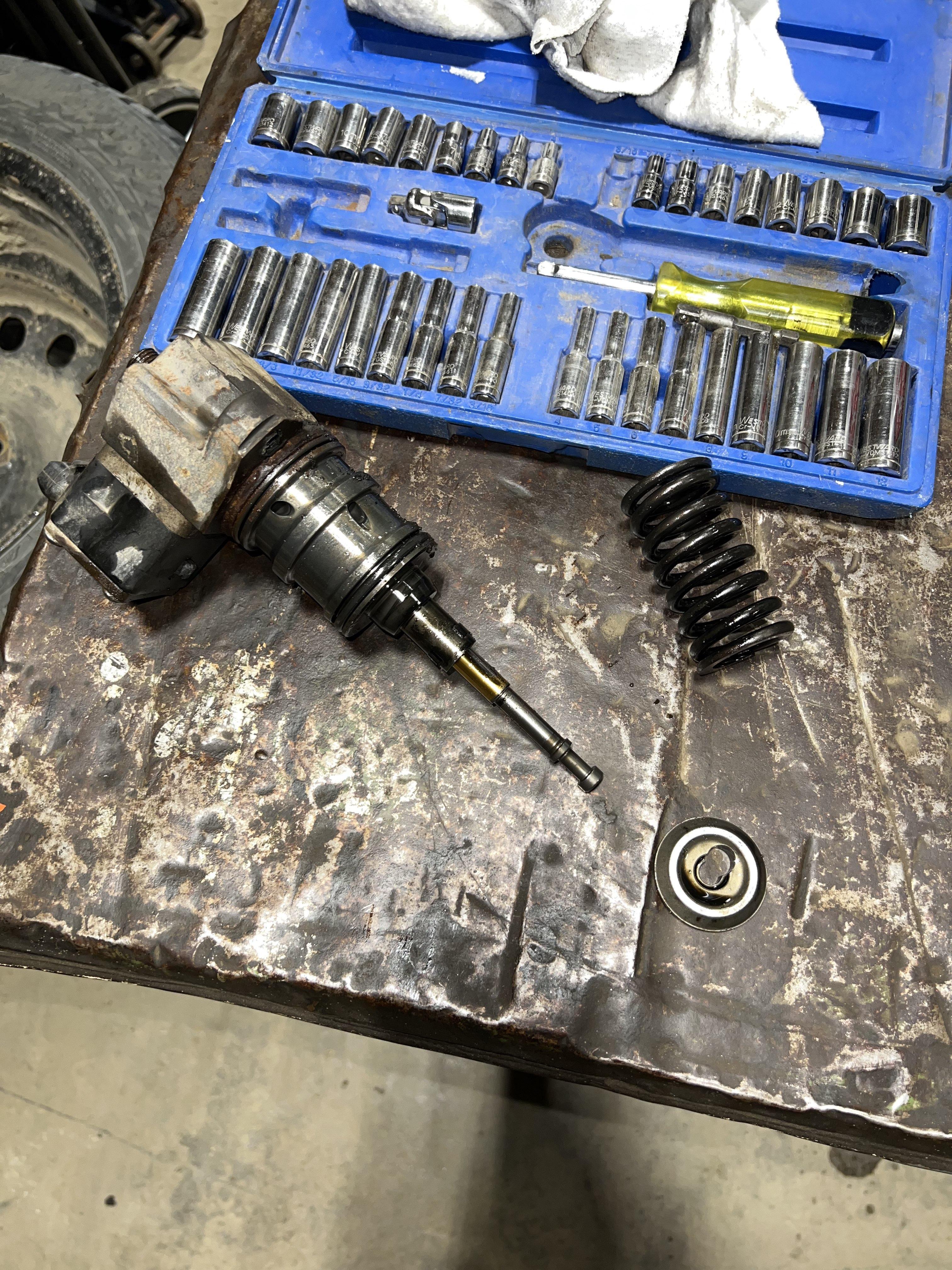

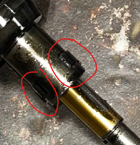

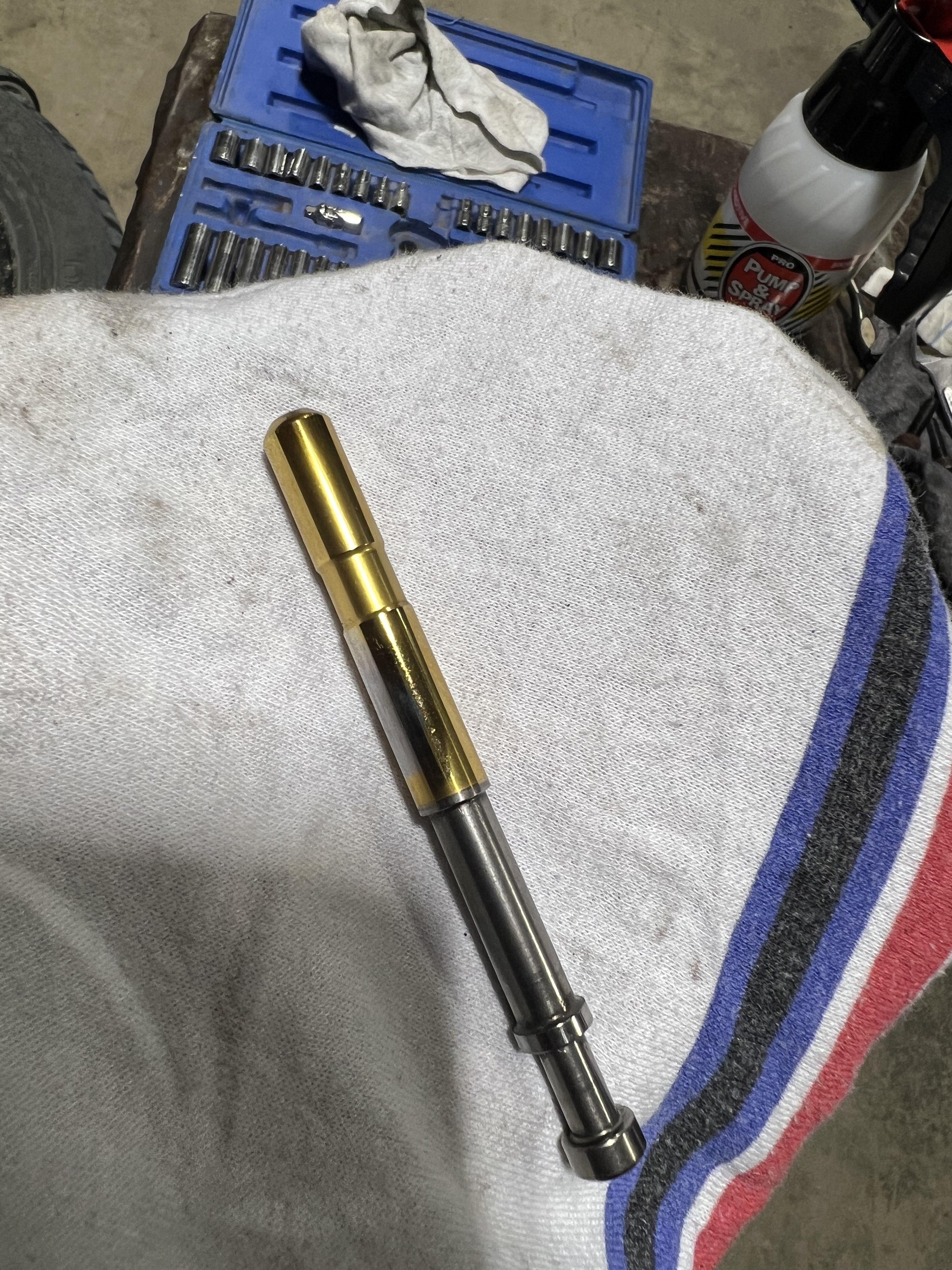

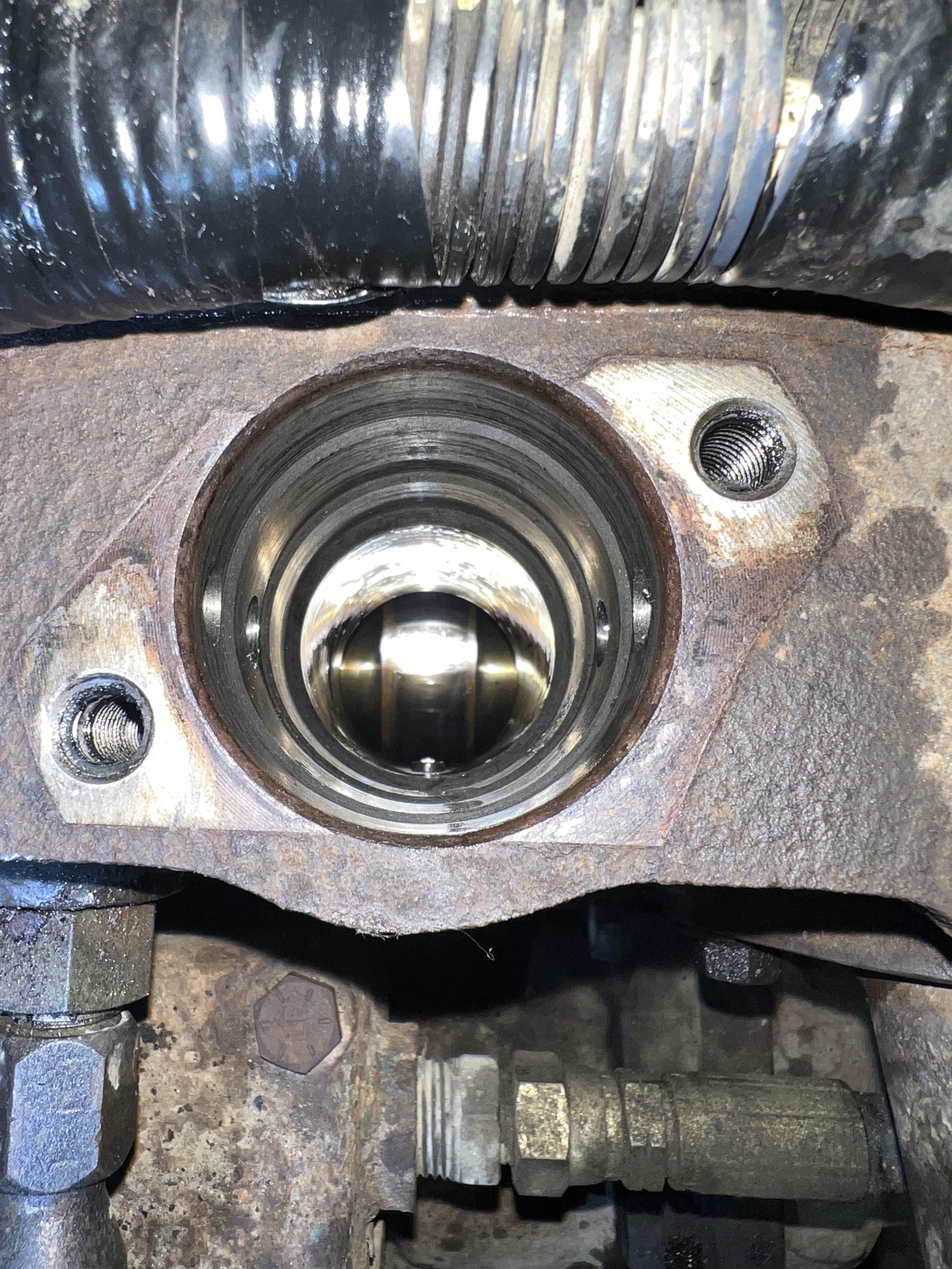

Well i got around to pulling the EUP and sweet baby Jesus was looking down upon me and extended a miracle, roller is in good shape cam is fine. The EUP on the other hand blew apart as you see in the photo when i popped it out of its hole, the gold plunger seems to have gotten past the retaining clip and was possibly sitting loose in the hole or maybe just not assembled properly? Im not sure if that was the cause of the issues or if that happened due to the sudden release of it being under the pressure of the spring that aloud the plunger to get past the retaining clip, there's also a wear mark in the golden coating as seen in the last photo. possibly a contributing factor to the infrequent 8-4 code.
I ordered a new EUP from https://mydieselpro.com/ the guy I talked to was very helpful and was under half the price Mack wanted for one. ill toss the new one in and hopefully that fixes that.
Where is the D-Clip that secures the piston.?  the Gold thingy...  The new EUP will be complete..But you dont need a hardened spring steel piece dancin around in there..

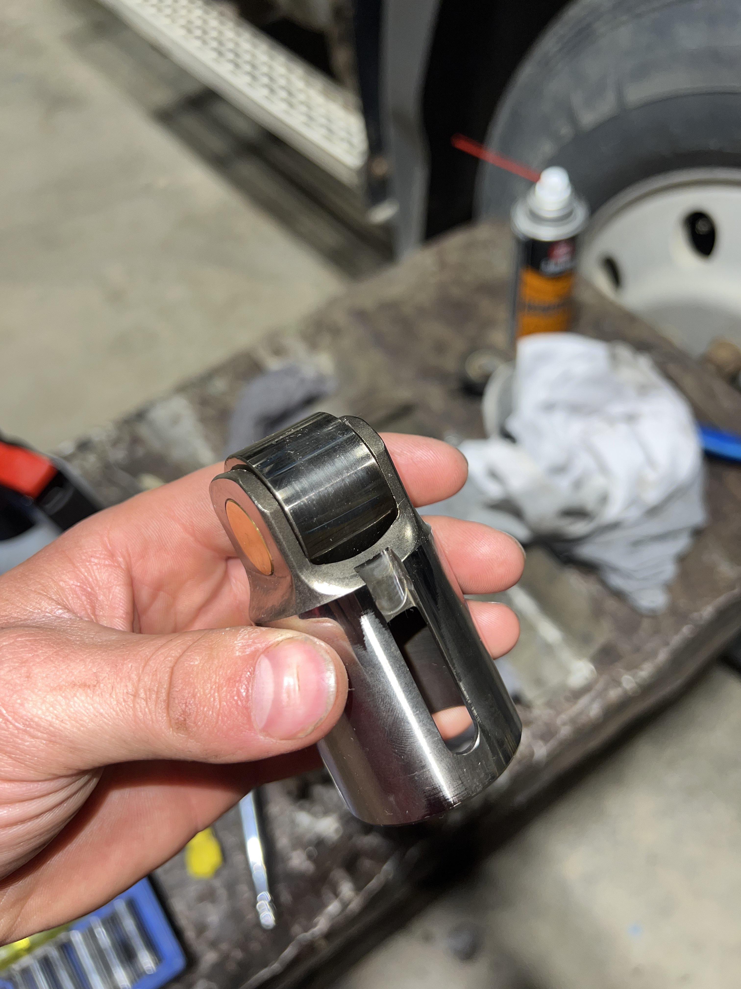

does the EUP roller have scratches that you can catch a finger nail on?  It looks scratched to me in the picture..  I'm not trying to be a Dick.. jojo

the D clip is still on the eup, it doesn't quite hold it in i was able to make it pop past even after i reassembled it. and no the roller is completely smooth its probley the lighting making it look scratched but ill pull it out again and double check just to be sure

this is the d clip right?

Ok,, I wanted to ask..  It can be hard to tell from a picture, and I Know these engines quite well, and wouldnt want to see a scratched roller put back in..  Keep on- keepin-on..  Jojo

Yes...thats the clip. it should not have allowed the piston to drop out..  anyway. you have a new EUP on the way, just inspect all the old parts for issues, to get an idea of what happened, then reassemble it for the 'core return'..  You seem to be doing a good job here..  :) be sure to clean the champher on the EUP bore, before you install the new EUP.  dont want to cut the oring..  New EUP cap screws torque down 25ish lbft,1st, set,,,,, then finish at 60 lbft..  jojo

If you ever do this job again, it is best to rotate the engine so the cam lobe it's not pushing on the eup spring. If the eup would have been good, it could have gotten damaged from flying out of that hole... Same for  procedure for installation.. and if by any chance you have ceramic eup rollers , don't drop them in and let them hit the cam.

im pretty sure it shot out because the retaining clip wasn't holding the piston in, ill know tomorrow when the new eup shows up. and the roller is all metal i believe
I bet It shot out, because you took both of the EUP bolts out, rather than using one of them to slowly raise the EUP. The thin metal clip doesn't hold the spring and plunger in place. The bottom cap does.  With the spring removed, the clip keeps the plunger in place.  The plunger is delicate, and is not to be held in bare hands..
Agreed..I usually back out the eup hold down bolts a couple turns.then pry on the corner of the eup to break the seat of the orings..if under pressure from the cam lobe , they eup will lift without much effort...then I rotate the engine to allow the spring to decompress..Joey you're correct..the plunger is made to precise tolerances.and should be removed from eup in a clean environment...when I took all my eups to get tested..the injection shop tech told me that the slightest spec of debris could cause the plunger to bind.

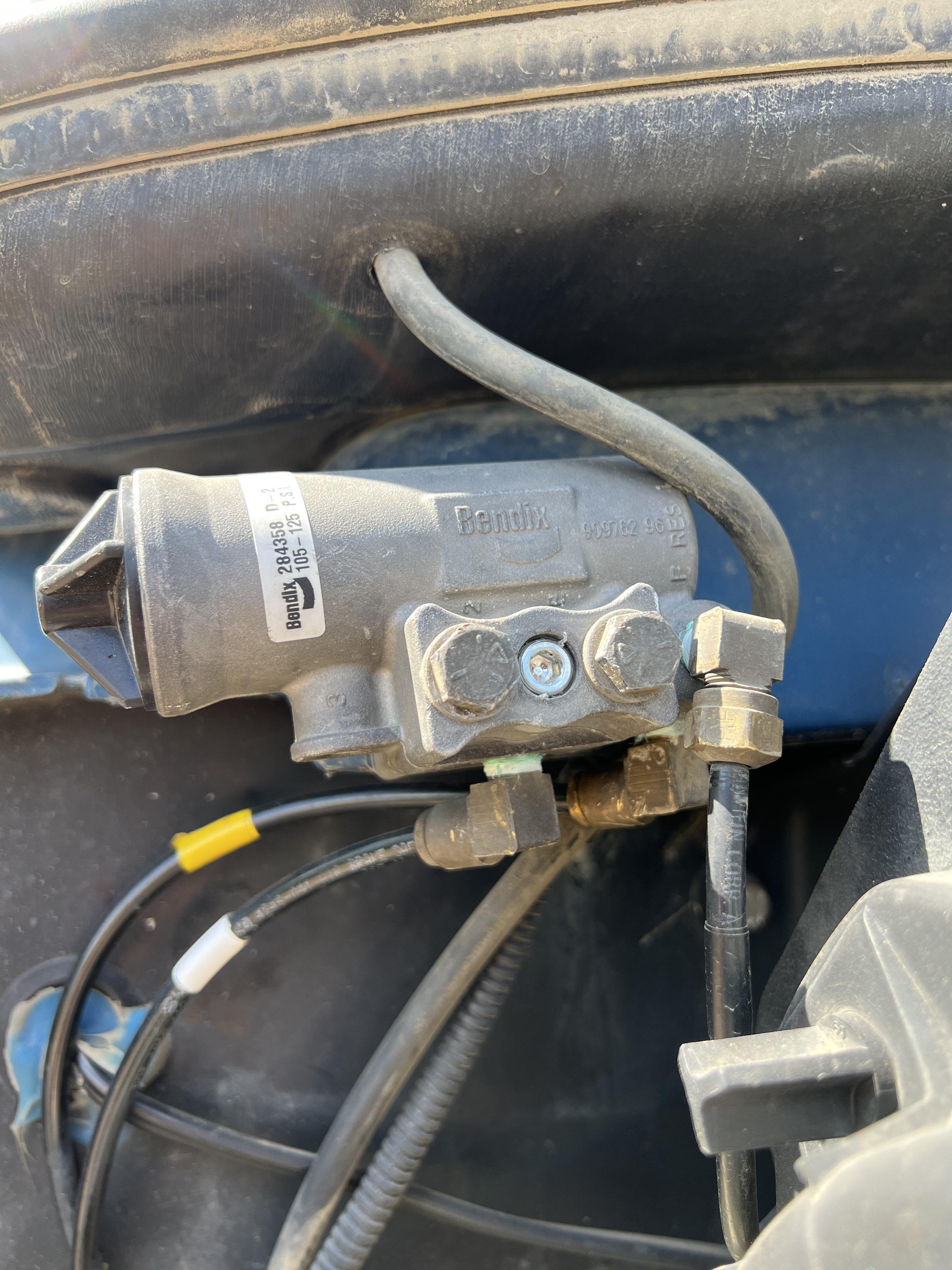

ive replaced the one valve right above the intake air filter as well i cant remember what its called, kinda like the brains i was told.
5 hours ago, Joey Mack said:
Was that valve the air governor(D-2)? It may be mounted near the air filter housing..

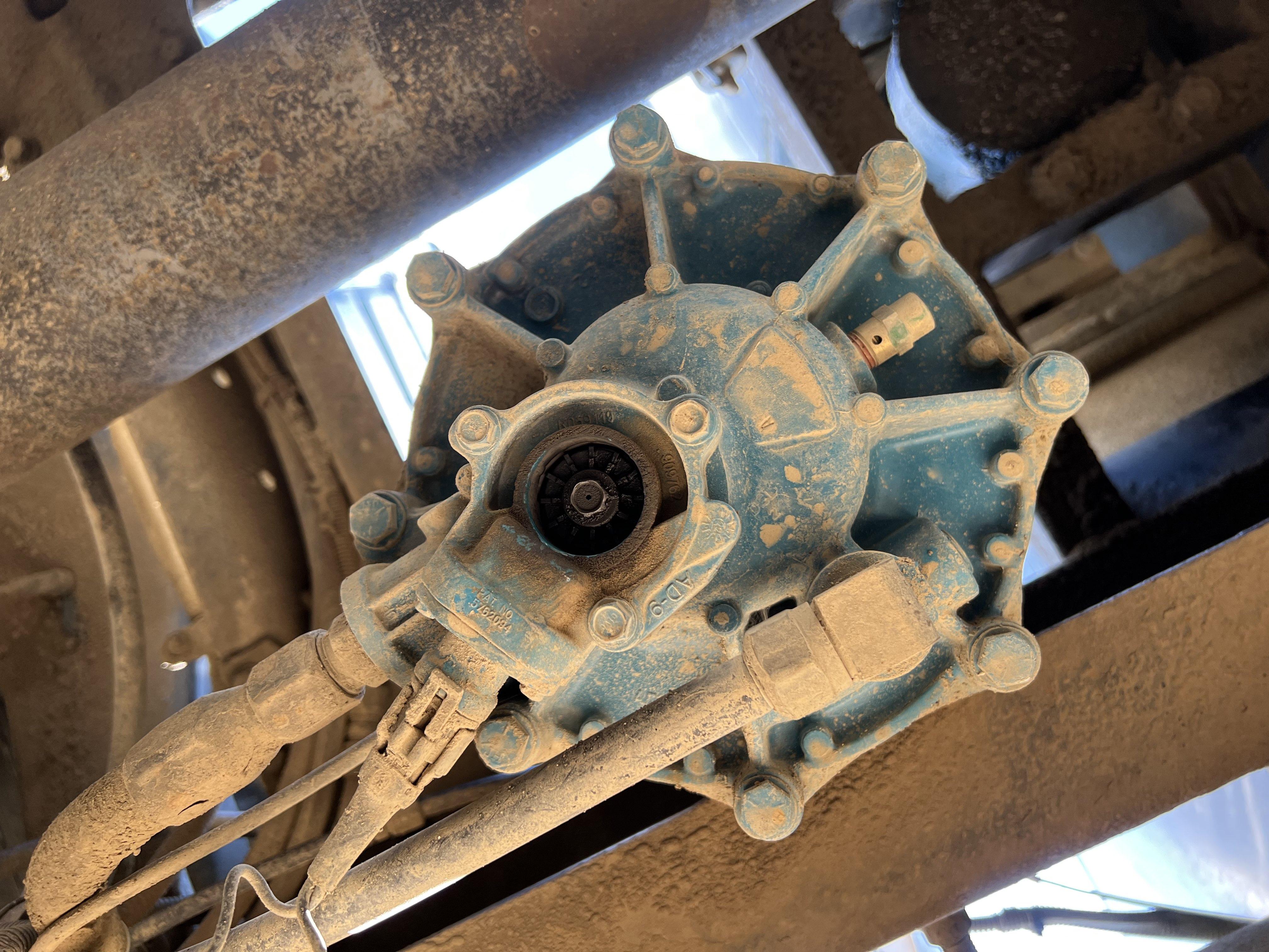

this is the part i replaced. and this is the air dryer. i only hear the air pissing when im speeding up and sometimes it purges and quits but other times it just keeps pissing, let go of the gas and it stops. i will try to get a video of it maybe here
you have a D-2 air governor and an AD-9 air dryer..  In my opinion, the best air regulating system..  what is the high air pressure reading on the gauge? the Gov. is adjustable.. if needed..
Ok, if you have large amounts of air coming out at idle that continues longer than normal, the check valve is accessible on the bottom of the AD-9. Remove the tube that enters the drier from the bottom, then remove the large brass nut and the check valve will come out with it.
 I would check the drier cartage, remove the ring of bolts and check to see the cartage is still firmly screwed into the base.
