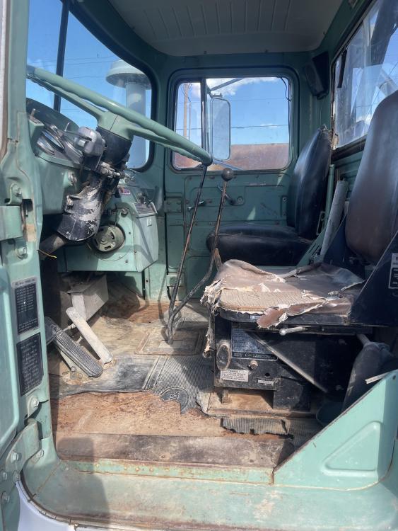

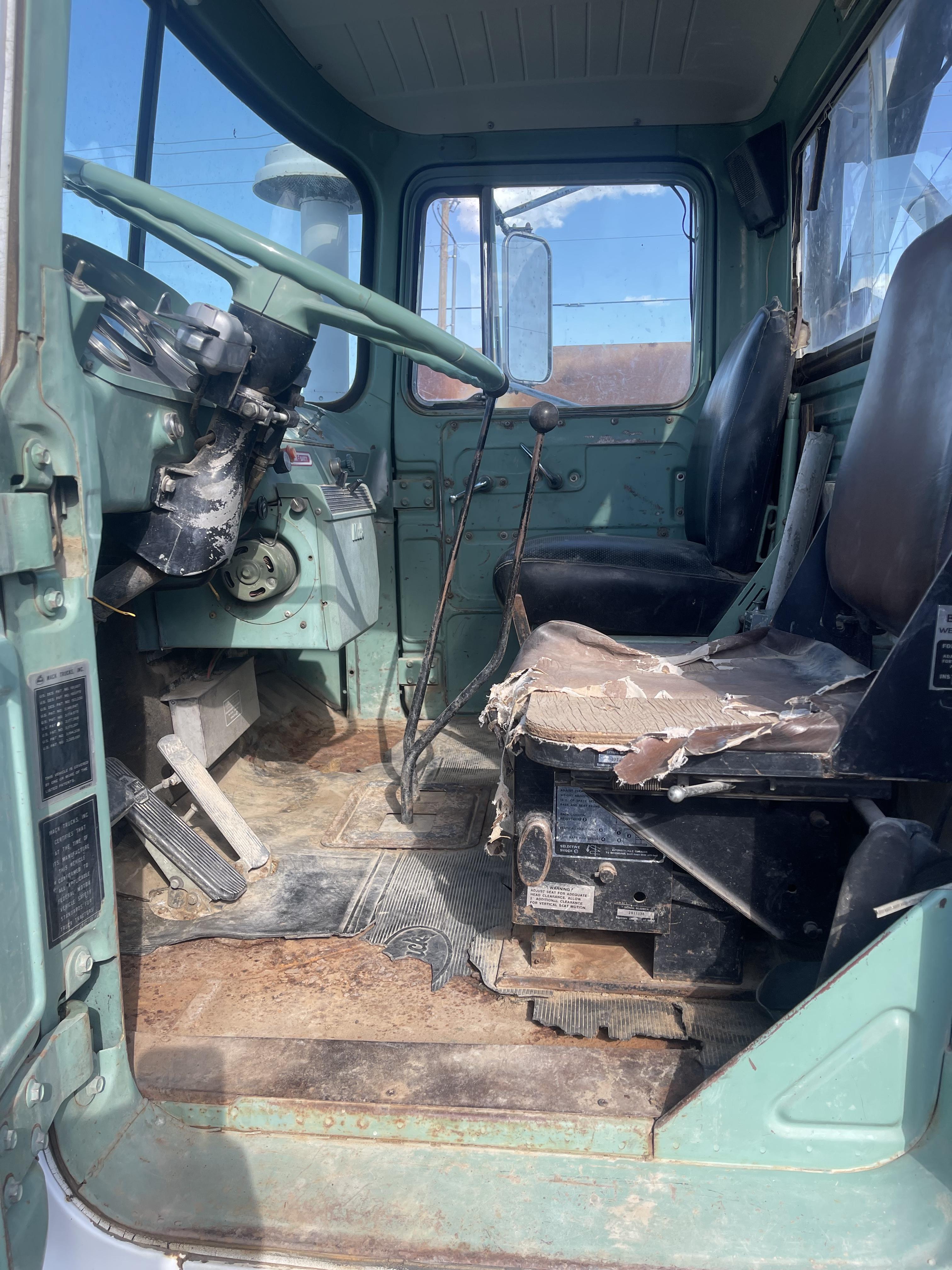

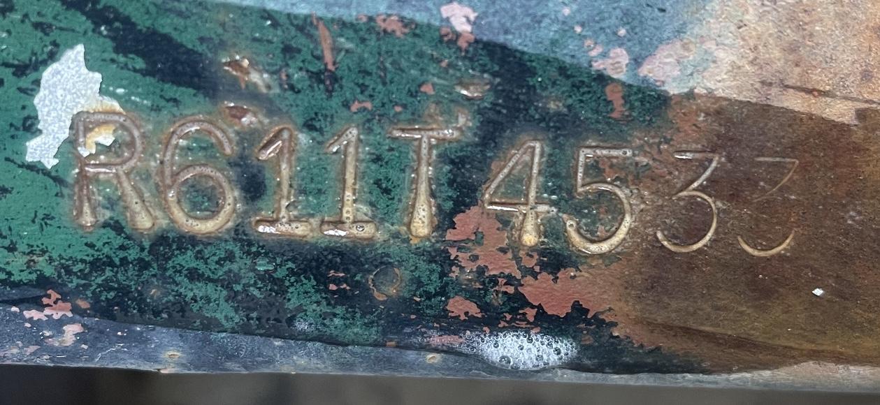

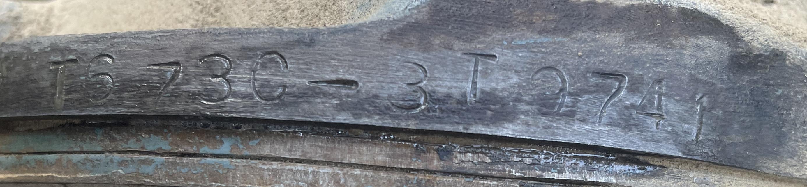

Today I had a couple of goals to work on. 1) get the chassis/vin number, engine number and transmission info. 2)send the needed info to the Mack museum 3)clean up the interior 4) lube up the doors so they actually open and close.

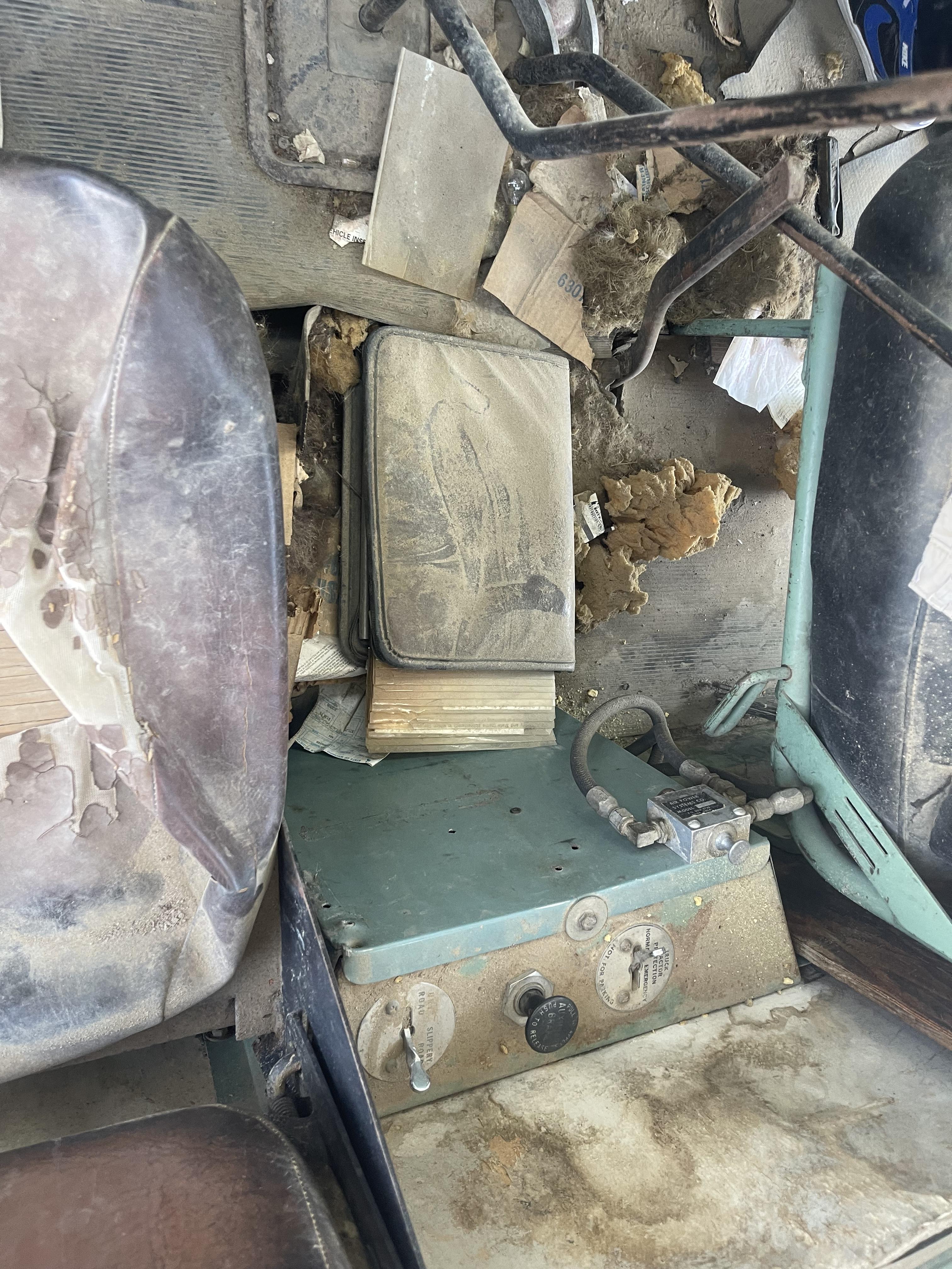

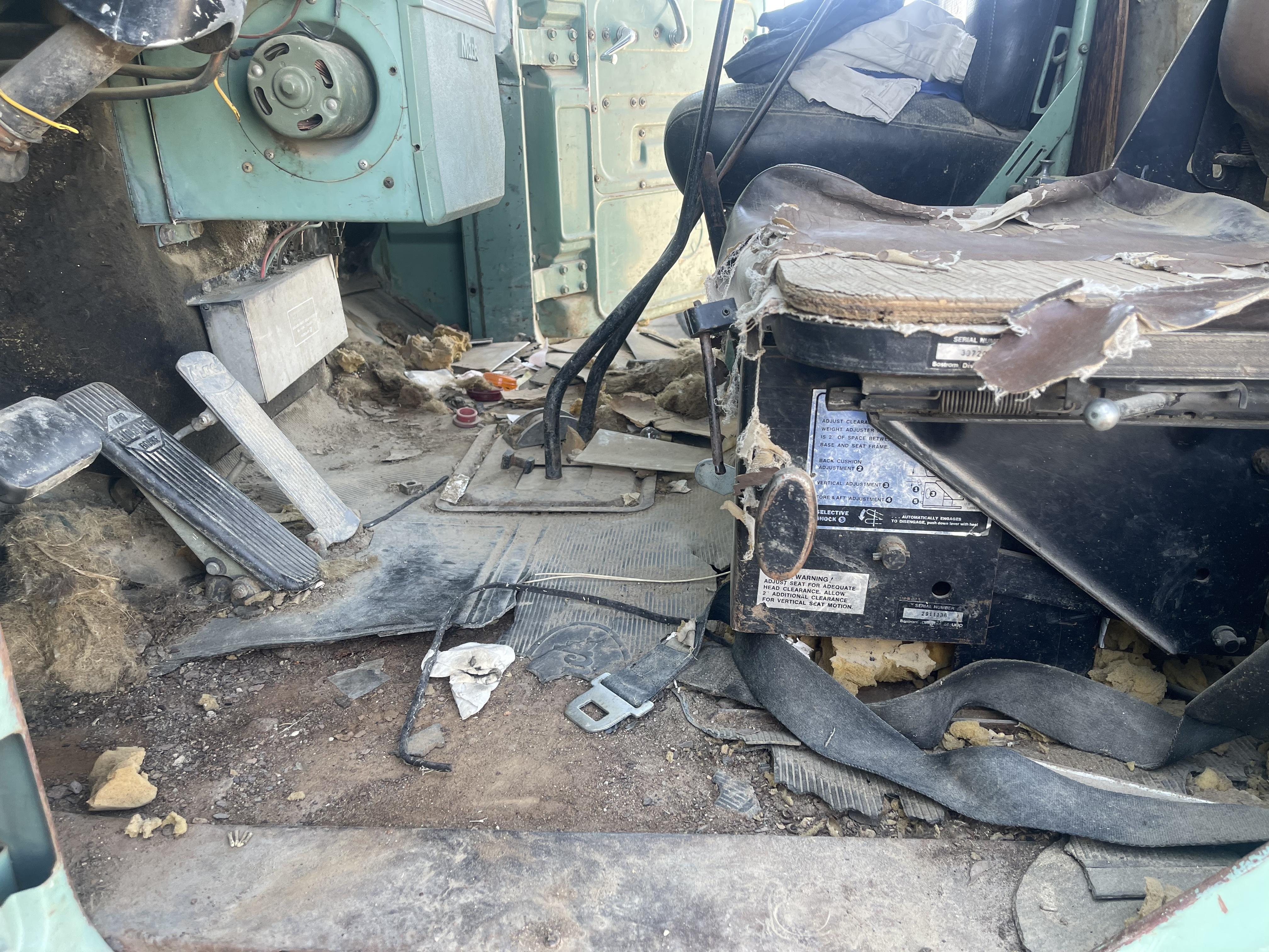

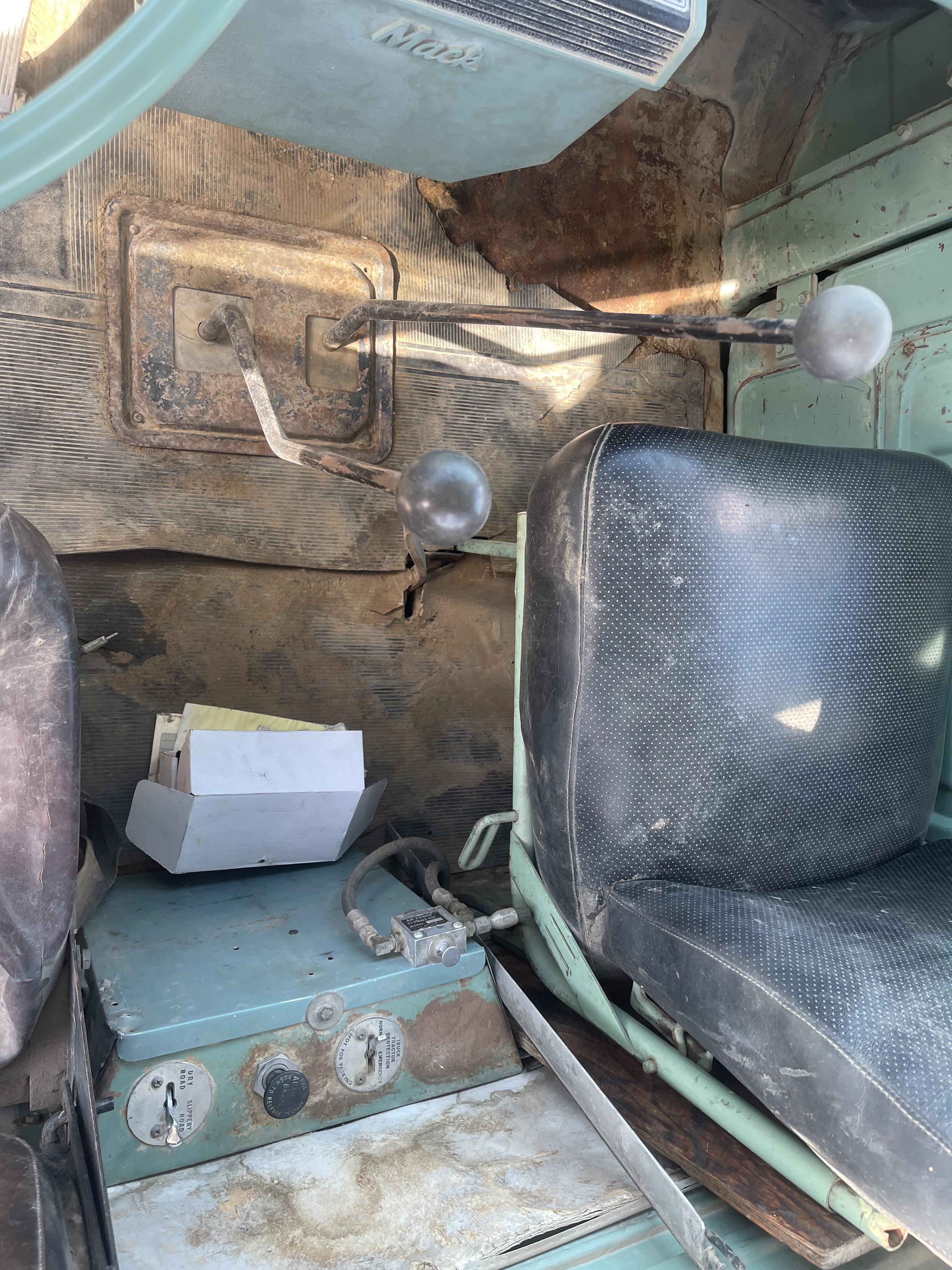

So the only thing I didn’t get done was finding the appropriate info to identify the transmission. I just ran out of time so I’ll have to cross that bridge later. But I did get the other info which is in the pics and you can also see in  the pics that the interior needs a few things. Surprisingly the floor is a lot more solid than it looks. When I originally found this truck it had two dead raccoons in it cause the window was cracked enough for them to get in. Today while cleaning the interior I found what was left of a third raccoon and baby raccoon remnants.

It looks a lot better.  I dont envy you cleaning out that mess.
Thanks! Yea it wasn’t fun but it needed to be done. Now I can move onto better things.
And, again, I am jealous!  Looking great!  And raccoon free!
I see there that you DO have the "C" version of the engine.  I have always liked that engine.  Pretty sure someone had to spec that as an option, because I think the "C" was not standard equipment.  But, I could be wrong.

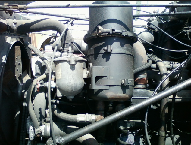

Your truck may have the big canister type oil filter on the left side of the engine.  That oil filter cartridge is still available (I got some from CarQuest), as is the diamond cross-section "O-Ring" that seals the 2-piece canister.  That is a WGB Oil Clarifier duplex oil filter, with a "full flow" and a "bypass" section in the same filter.  Mack number is 236GB311A, IIRC, which might cross over to a Wix 51233.  Seal might be Wix 15114.  But, I am not sure.  The correct seal has a diamond shape, not a round shape.

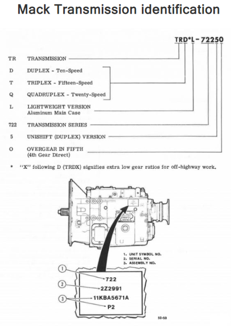

There should be a number stamped on the driver's side of the transmission (see below).  But, it can be pretty hard to see.  Pretty sure you will have the TRD-722, based on what you have already shown us.  If it is the "L" version, it should have an aluminum main case, which would be pretty easy to check with a magnet.
Thanks! I’m pretty stoked that this thing is mine. It sat for awhile before I got the title and then got busy with life and then winter. So now that it is all over and I get to actually do stuff to it, I’m just still in shock about it. I’ve always wanted an old truck and to find one like this is just really a dream come true, and on top of that one of my three sons is actually just as excited about it as I am and loves to come help out and tinker with it. He is really hoping we can take it to some car shows this summer.
The transmission has quite a bit of build up on it. I cleaned some of it off and found some numbers but judging by your pic I wasn’t quite in the right spot. So thanks for the reference, I’ll keep looking.

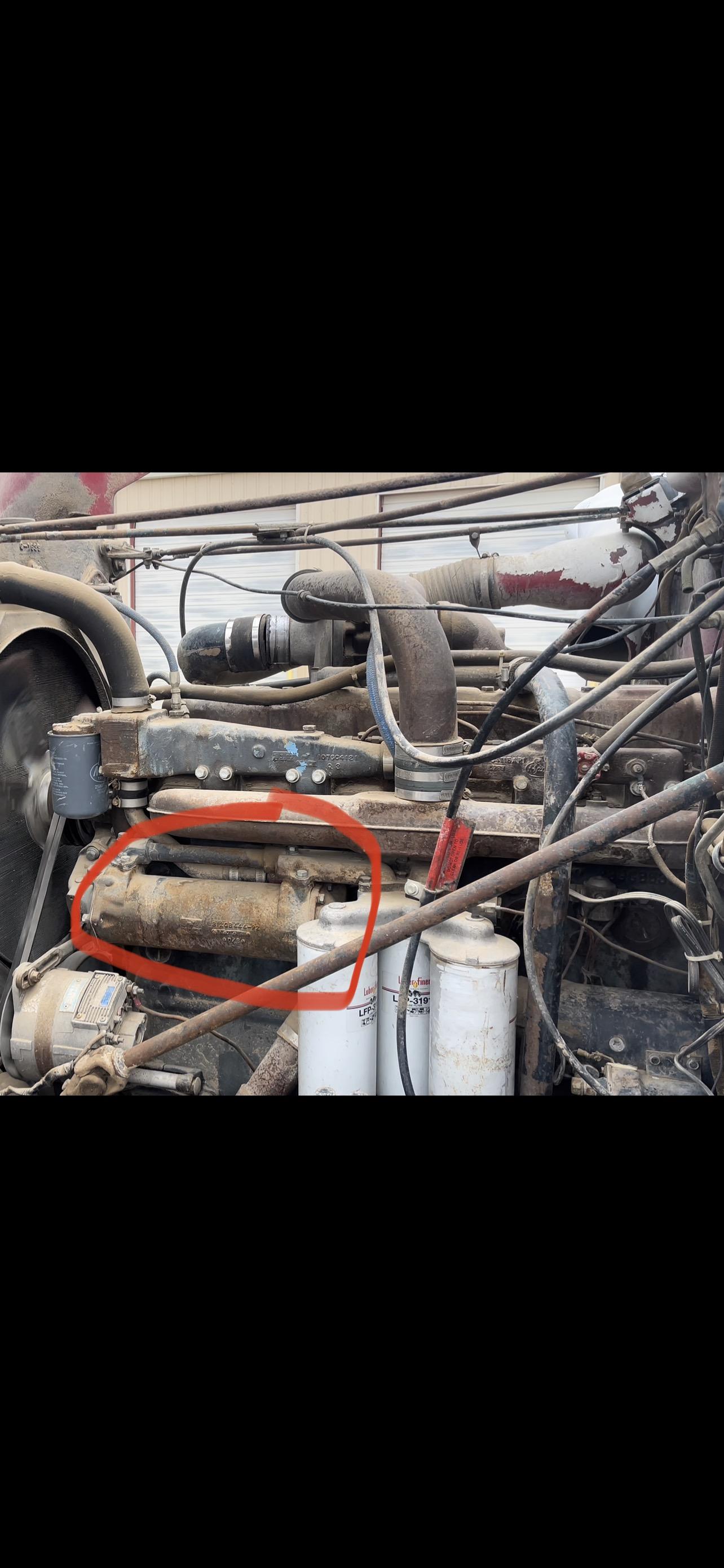

Below is a pic of the engine. Are you talking about the spot I circled? Is that a filter in there?
NO  that circled item is OIL COOLER.  you do NOT have the canister filter.. the three white spin-ons will be your oil filters. great job on the   round one clean up.with the eviction of raccoons ; strong suggestion would be to spray fuel/ brake pedals  making it easier for future operation. check roller under brake pedal and plunger . raccoon pee can rust out a lot of parts that should move

Thanks for the clarification on the filters. I knew the 3 spin ons were oil filters but I wasn’t sure if there was something I didn’t know about.

You are way ahead of the game in that the filters have already been set us as spin-on.  That is much easier to work on.  You've really got a nice starting point there.
That's what I was telling him about (like the one below).  Apparently, somebody has already swapped that one over to the later 3-filter spin-on setup.  Again, one more reason for me to be jealous!
