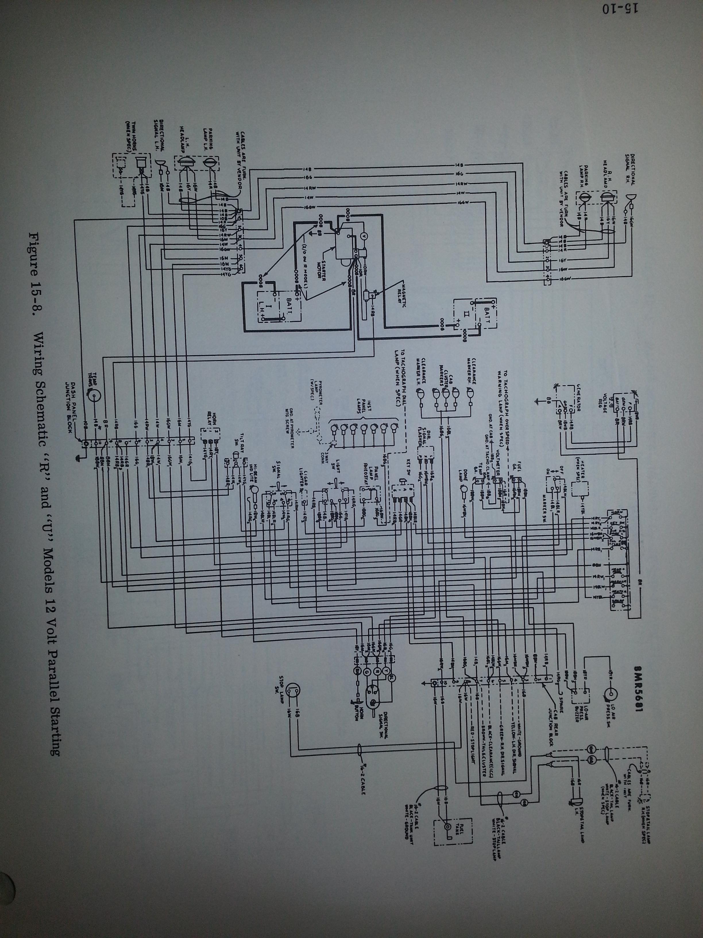

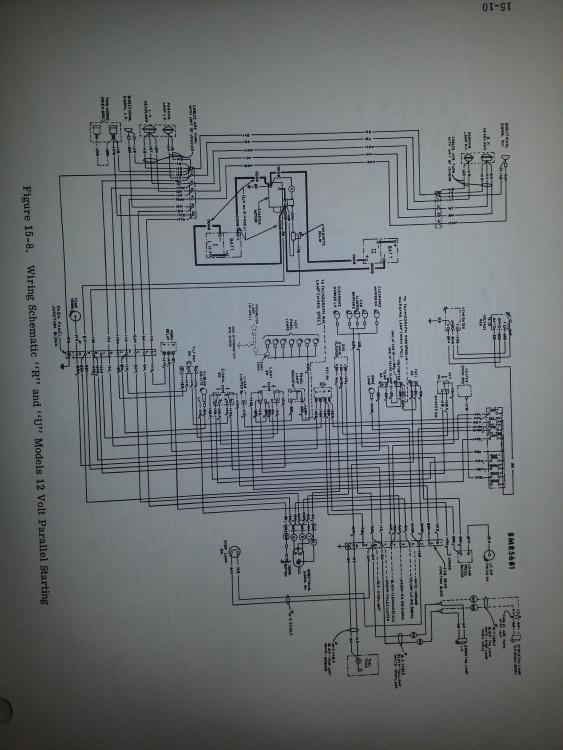

Kinda hard to see, but here is a typical wiring diagram for an R of that vintage...
That’s awesome thanks! Luckily my phone zooms in good enough to just make out most of it.
1 minute ago, Robo987 said:
I’ve been on the fence about changing it over to  negative ground. I was surprised to see it was a negative ground. Trying to keep it as original as possible.
i really like the light green, the dark green isn’t as appealing to the eyes IMO.
I’ve worked on a lot of stuff but old trucks and equipment are not things that you come across often in a day to day mechanics job. At least in what I do. So some of this stuff is foreign to me and I learn new things every time I work on it.
They are actually fairly easy to work on.  Very well designed beasts.
The biggest issue I saw when one was changed to negative ground was that some of the gauges would not work correctly.  For instance, I had to change the volt meter on mine, because it was not possible to reverse the gauge (single wire, ground through case).  Had to get a 2-terminal gauge so I could connect the wires to the terminals with the correct polarity.  Also, I think the fuel gauges did not like being reversed.  But, I am fuzzy on that one.  Light bulbs do not care.
Nothin at all wrong with positive ground.  Just have to isolate any add-ons that you have (like radios or phone chargers).

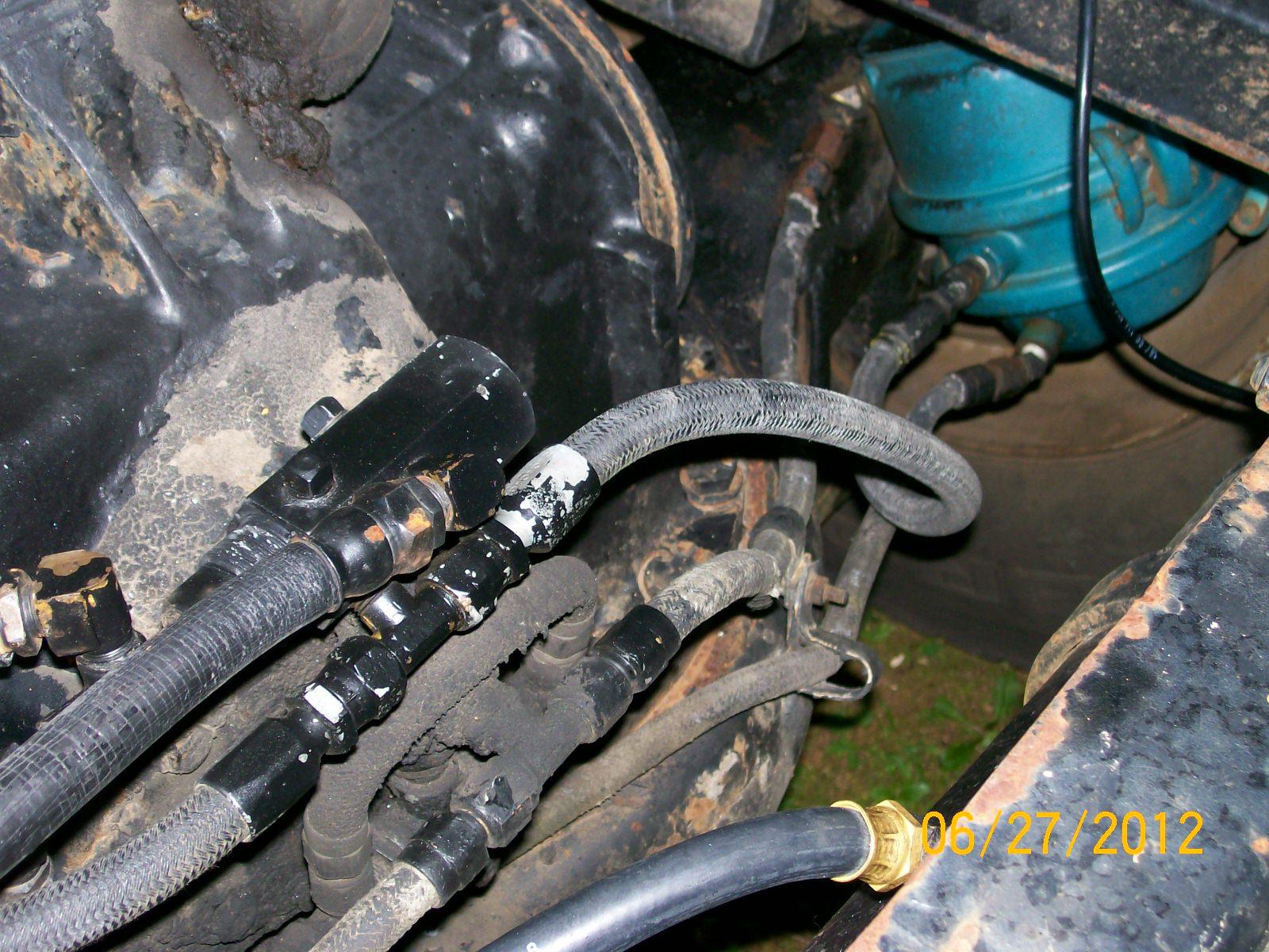

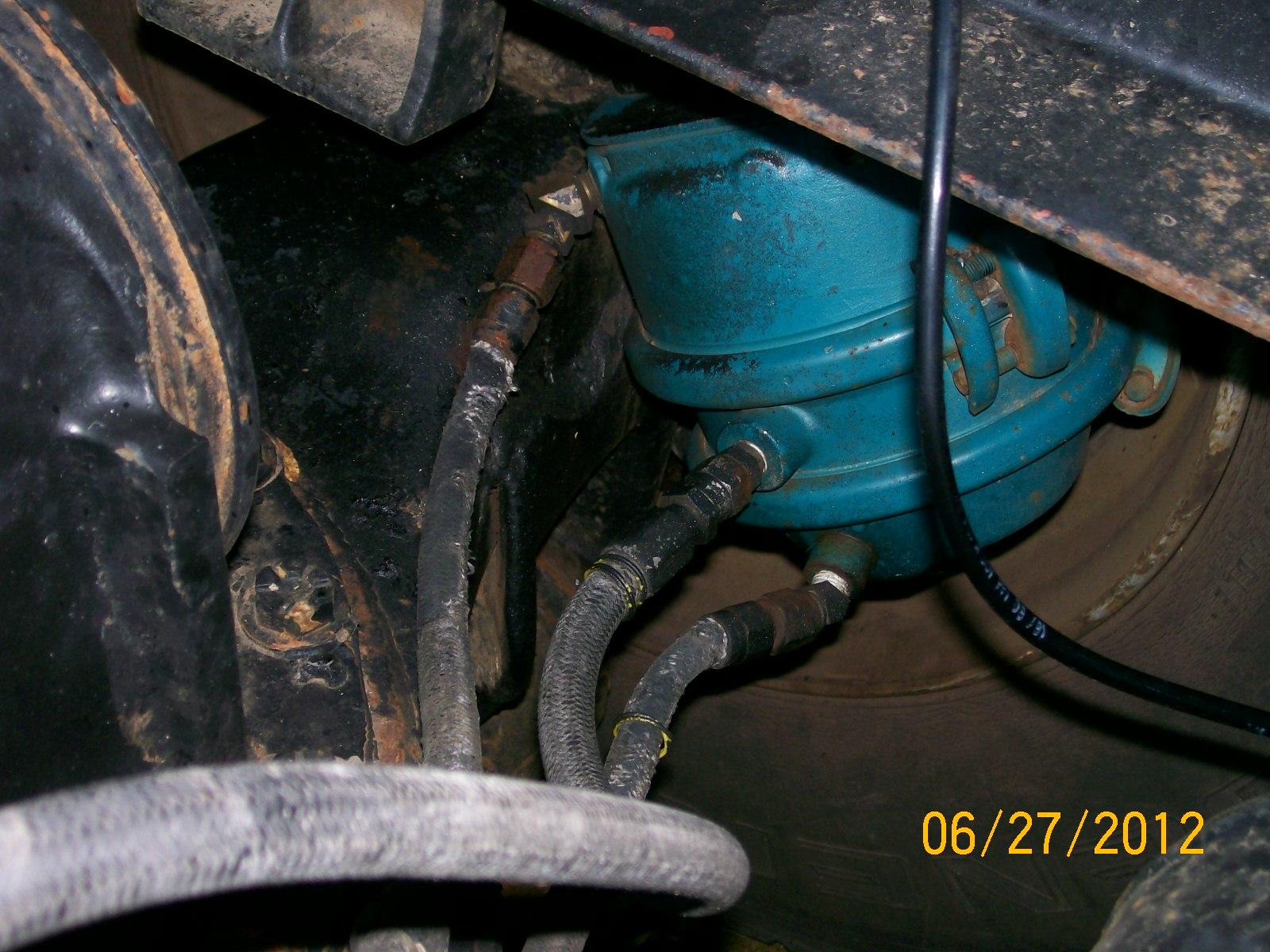

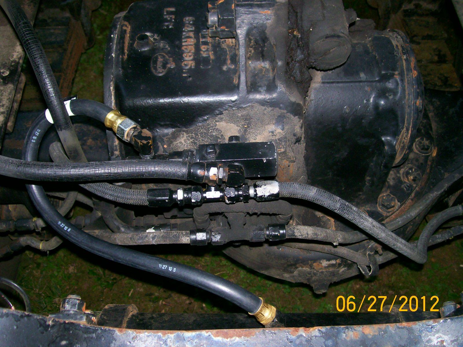

I have airline schematics, too.  Not sure what kind of parking brake setup you have on there.  Mine came with DD3 brake units.  Very complicated system with extra air tank and an "inversion valve" (see pictures).  I swapped it over to regular spring brake chambers, which was very easy.  It also eliminated a bunch of hoses and stuff.  Worked better, too.
100_5637.thumb.JPG.eec0135ad18c496ce633ff3593bbdaf0.JPG100_5636.thumb.JPG.bcf5c83ad9d797987cf88cde67e39189.JPG100_5638.thumb.JPG.f56d96a30e8df0573b08ecc30e9a694b.JPG
I’ll take whatever info and schematics you have. The more the merrier. I’ll get pics of the brakes chambers when I get a chance, I haven’t really looked at those yet. The brakes worked so I moved on to more pressing matters.

First thing I did on mine was replace every air line on it, the slack adjusters, and the brake chambers.  Got rid of the rotten hoses on the frame and replaced with DOT air line tubing.  After that, I felt a lot more comfortable driving it!
