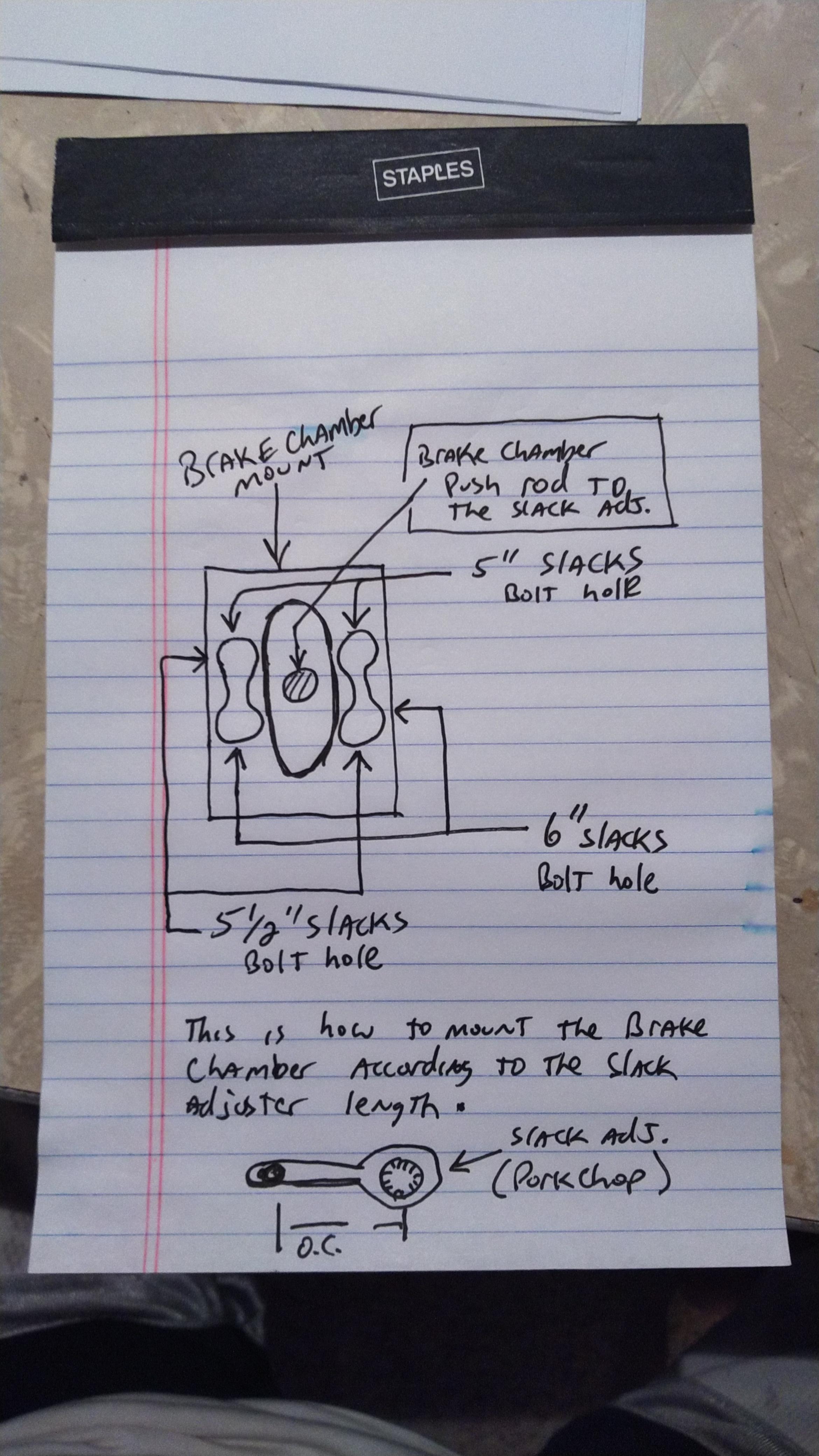

Here is my little diagram of how slack adjusters are mounted on your truck..  I hope others add to this tutorial..  I suggest you re-read the posts from Mechohaulic and MrsMackPaul, and MarkT...  Jojo

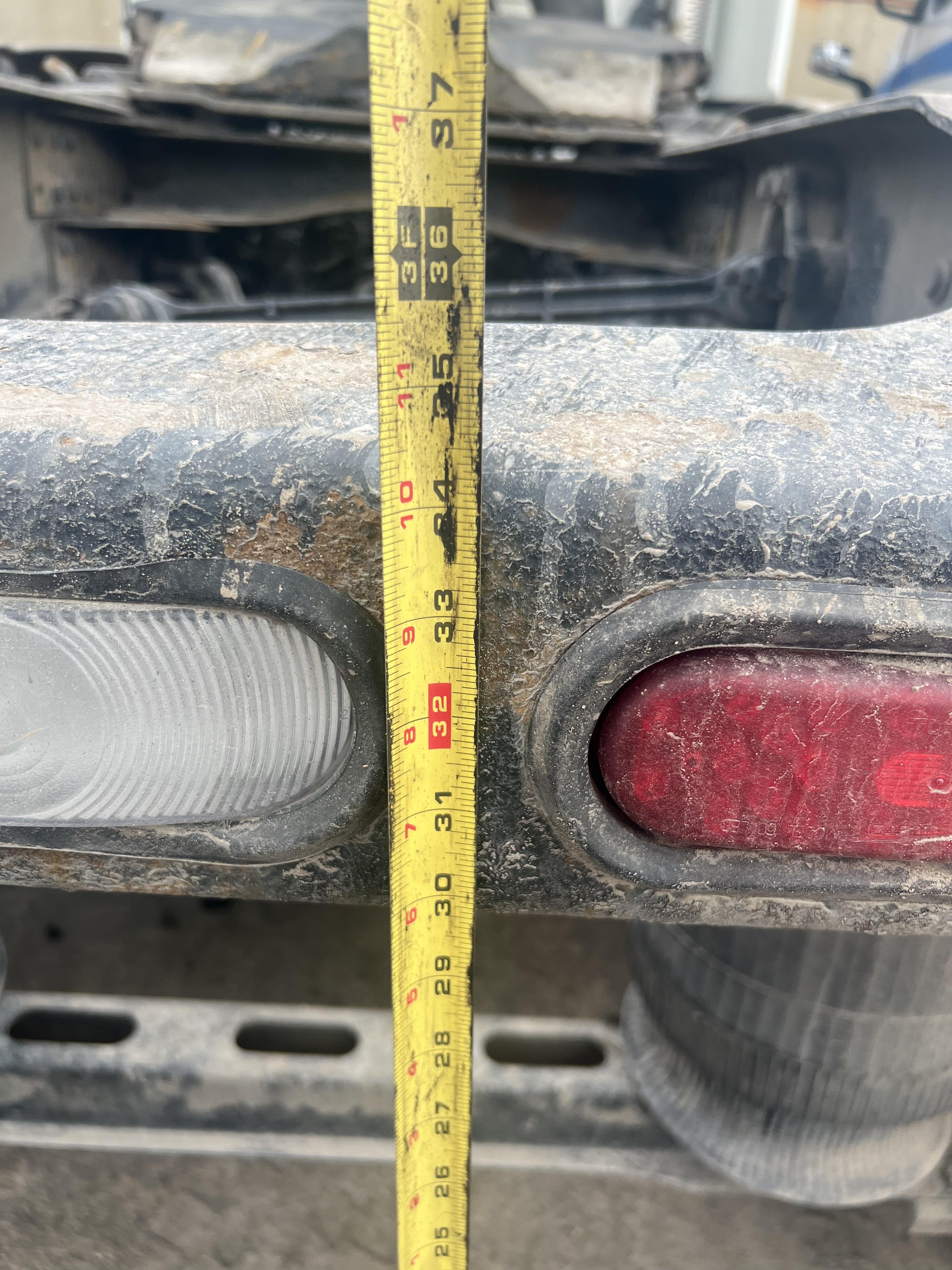

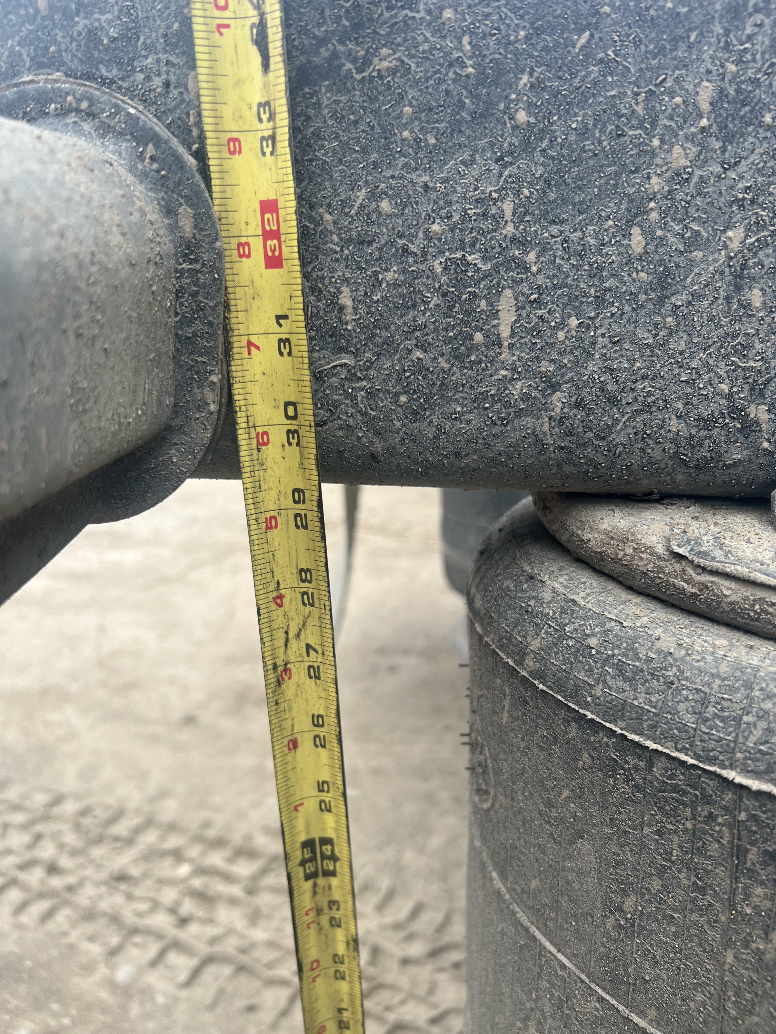

Is it me, or does the frame look twisted in the second picture?  Maybe do like Mechohaulic said and swap the brakes and drums to see if the issue follows .. this test is free. Buying brakes and drums gets expensive quick.
now that's what I call expert  observations of mechanical nature terms of twisted frame picture two. focus on tape measure till looking toward fifth wheel , cross member looks straight can't be camera angle. my vote also cast for twist some where.
