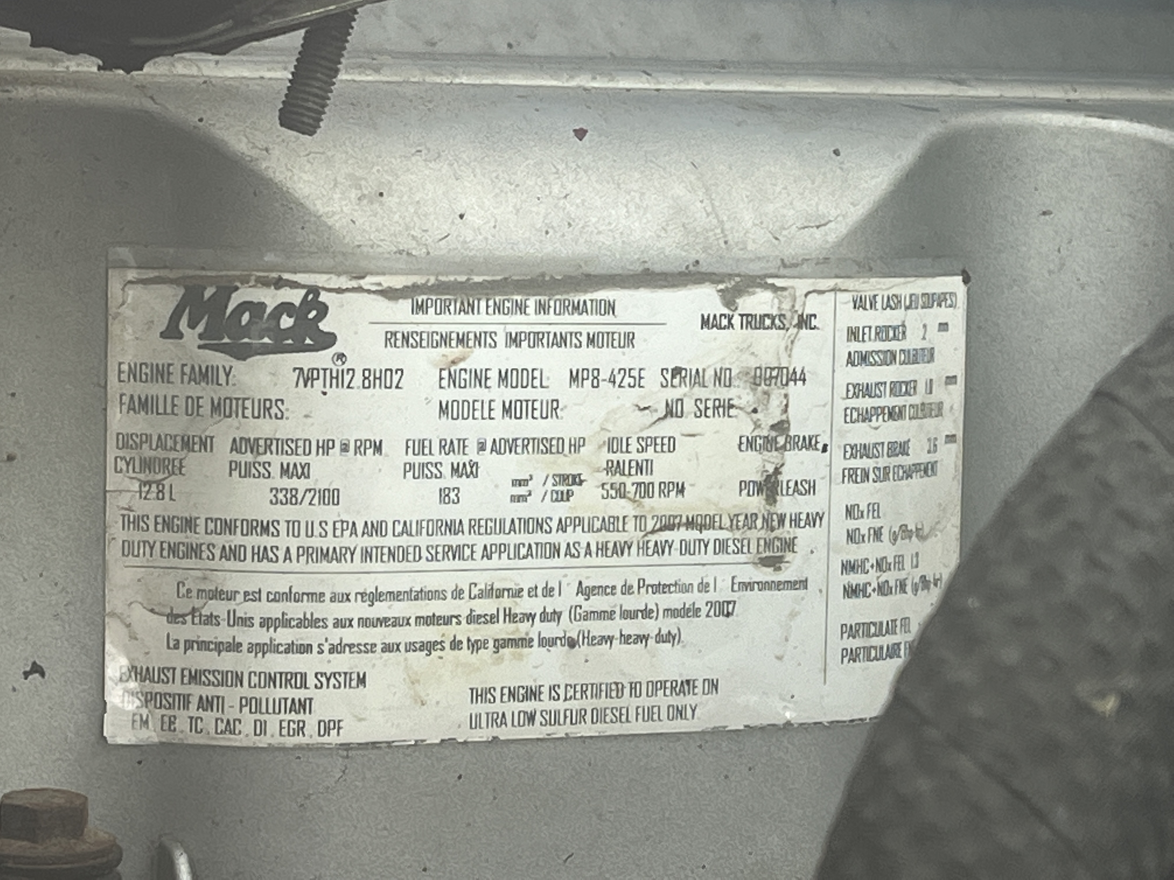

I'm sure my title attracts some smartass comments. Maybe not. I'm new on this forum and the truck industry. I depend a lot on trust right now. I've got 2 conflicting stories from 2 different people. I truly respect both people and their opinions. The Mack is a 2008 CHU.
There seems to be a really loud noise from the engine/transmission area. I was told that the loud noise was loose valves and it may have started from the camshaft? There is already a valve/camshaft kit out there for about 4,000.00 because of that ongoing issue????? The motor is a MP8.
The other valued opinion is that the valve/engine noise is perfectly okay with the engine. They all make that noise and the problem is a throw-out bearing. That's why it doesn't go away when you press the clutch or put a little bind on it. It has a T313 transmission.
Other than taking to a shop, has anyone had this type of issue?

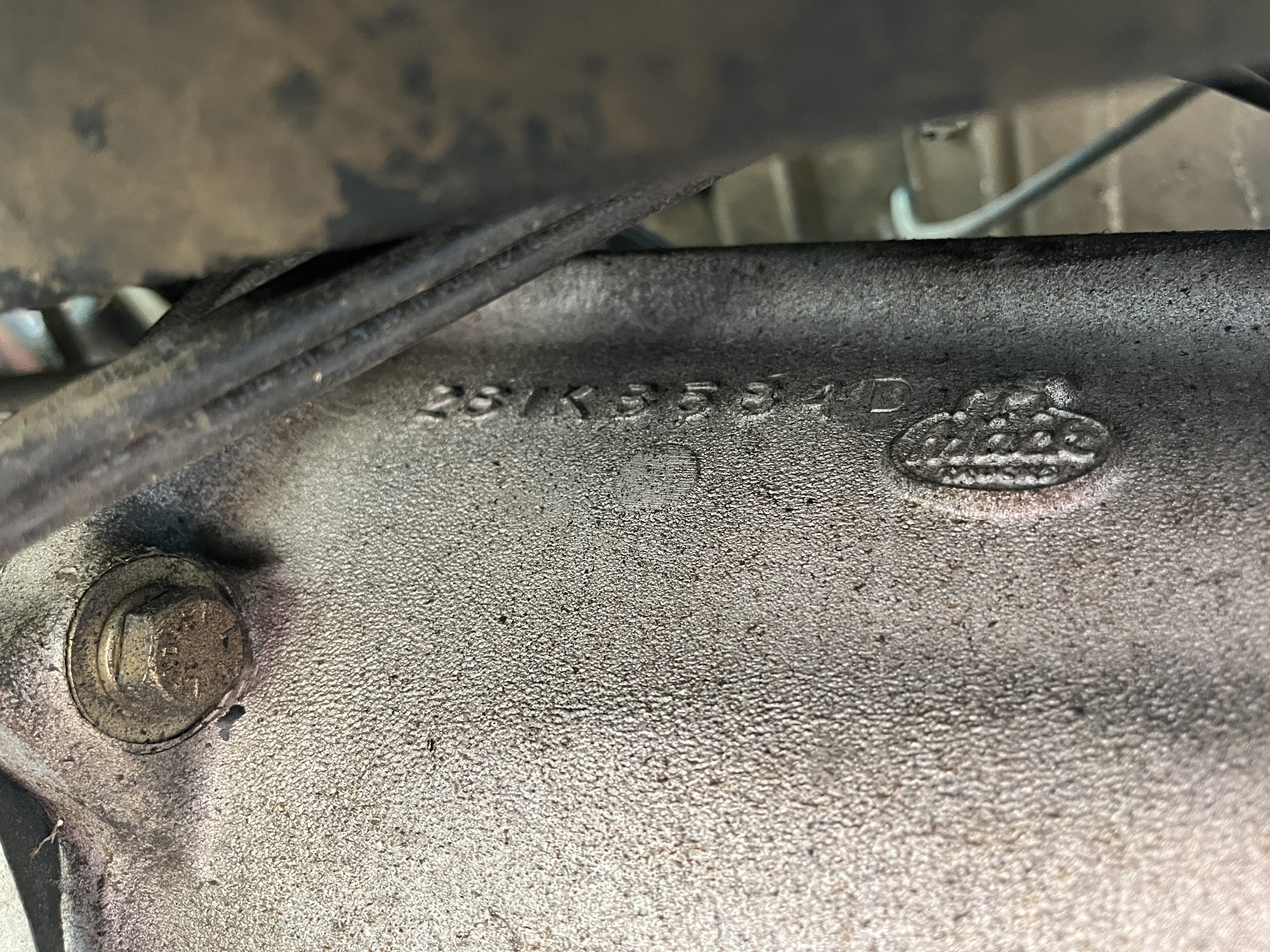

I have a Mp8-425e and the Mack dealer told me I had a T313 transmission. I don't see any numbers on the transmission other than 281K35343 that tell me it's a 313. The dealer can't do anything with it for SEVERAL weeks out. I have nothing but the desire to get it to a dealer or legit shop. I just got it home 3 days ago. Spending the time to clean top to bottom. This helps me to look over every part (well not EVERY) on the truck. Hopefully it may give me the ability in some way to identify, at least, what my issue may be? Now that I have it in the driveway, I have more of an ability to look, check and learn. Nowhere on my wish list of "Shit to do" is a line item that says, "Take transmission out of a Mack and use it as an orbital instrument to strengthen fellowship and unity with fellow man as we journey to rebuild it!" My skin is respectfully tough and their is no opinion that I would not want to hear. Ultimately it is my choice to take or dismiss anyone's advice. I'm ALWAYS appreciative and thankful. Don't get on FB much and I don't drink, HOWEVER I may consider going to the local bar before it's all said and done!

the numbers should be stamped into the tranny housing, on the left side, in-line with the clutch arm cross shaft,  2 inches from the seam where the rear case and front case meet..  You will have to pull the tranny to fix this leak,  then you willl see if its the oil seal and /or the oil pump line/system , shown in the picture.  jojo

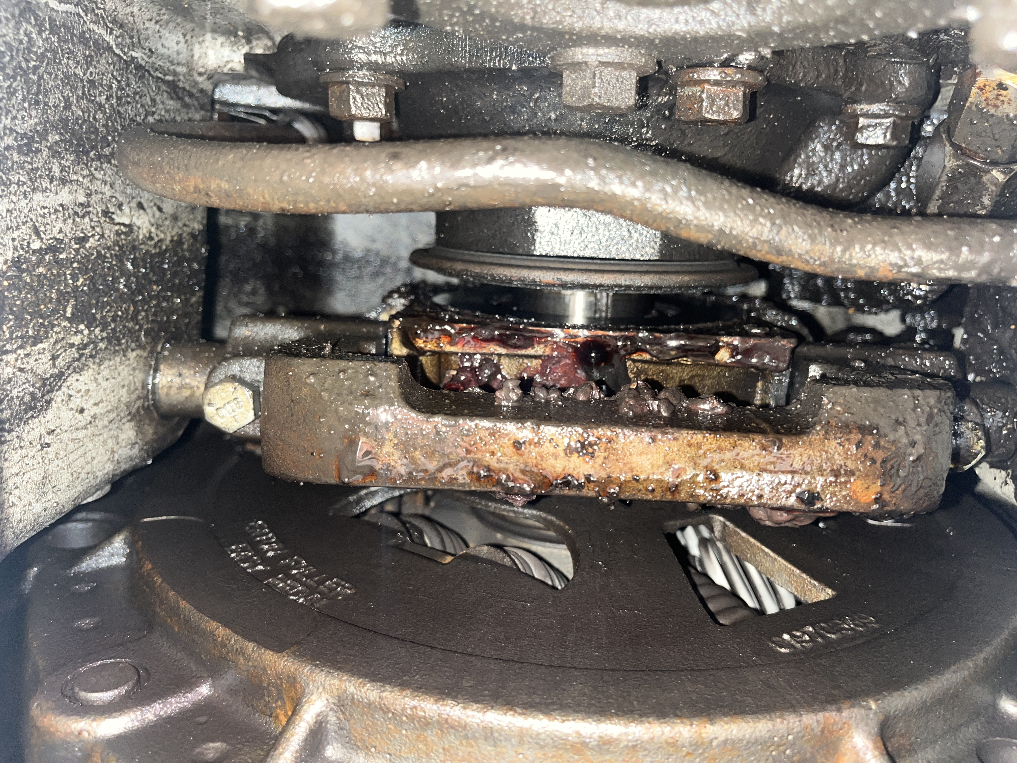

HERE WE GO!! I had it trailered to a certified shop. I was told that he didn't do Macks BUT upon looking it over, he gave the final diagnosis.....
It's the rear gear train that's making all the noise and the gears are eat up. I don't know if those metal shavings have access to the internal part of the engine? And the compressor motor won't come out! With the motor having 400k on it, is that the time to do an overhaul or is that an entirely different animal?

FJH. Now is that time of which you speak! Gather round all ye curious souls. Tis I who can lay down the demise (or solution) of the broken Walking Backwards! As Willie gifted us in 1967, "The Party Is Over," I will end this thread with the same vision! I have not only uploaded Willie Nelson's video (please enjoy and I hope I don't get fussed at) but I have also uploaded my entire service ticket below. I refer to that as "pulling my dress up" and typically don't like doing that. As FJH properly suggested, maybe my internal and monetary "wake of death and destruction" may help another on this forum.  Whether it was the right/wrong, better/worst or expensive/economical decision, A DECISION WAS  MADE! And that, my friends, was the true problem; MAKING A DECISION. At the end of the day that is the gift that this site offers to us all. This is a platform that collects an unbelievable amount of great people with good advice and a sincere want to help others. It's just too bad this platform (site) isn't what we walk out of our doors to mix with anymore! I appreciate every person that has taken the time to give me ideas, advice or just a straight up smartass comment! Merry Christmas! A sincere thanks to all and to all a good night!
