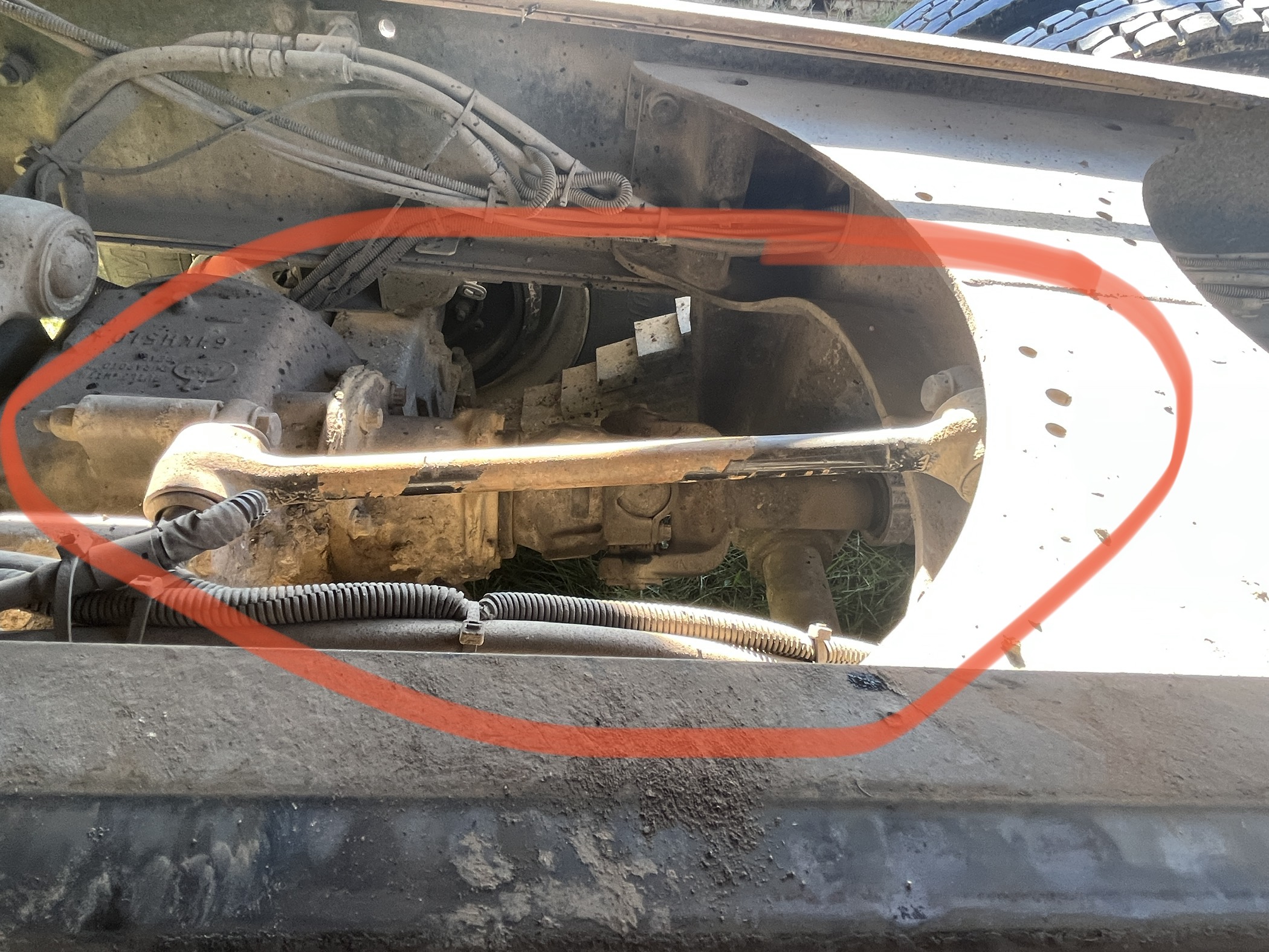

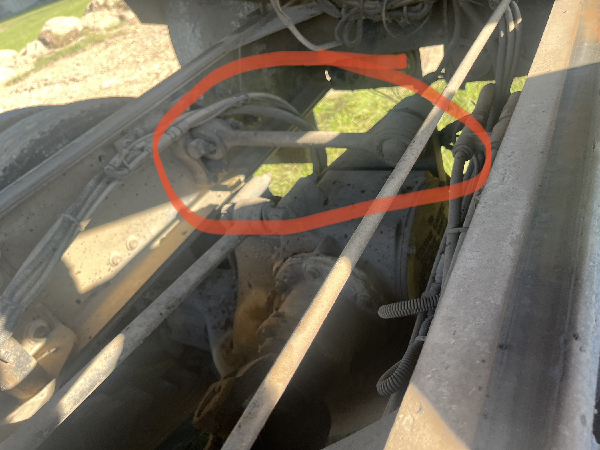

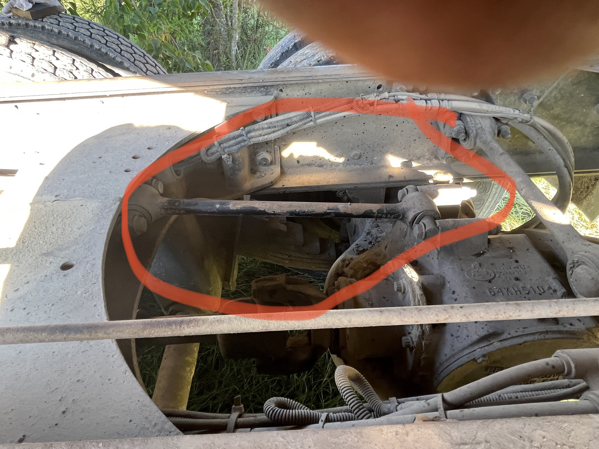

  5. Can't find part #'s and I don't have a manual. I tried measuring center to center, 24 in., 21 in., and 18 in. These measurements are doing NOTHING for any parts house open on Sat. Then again, I'm sure I'm not much help to any parts house no matter what day they are open! Can someone help me know more than I do right now???
