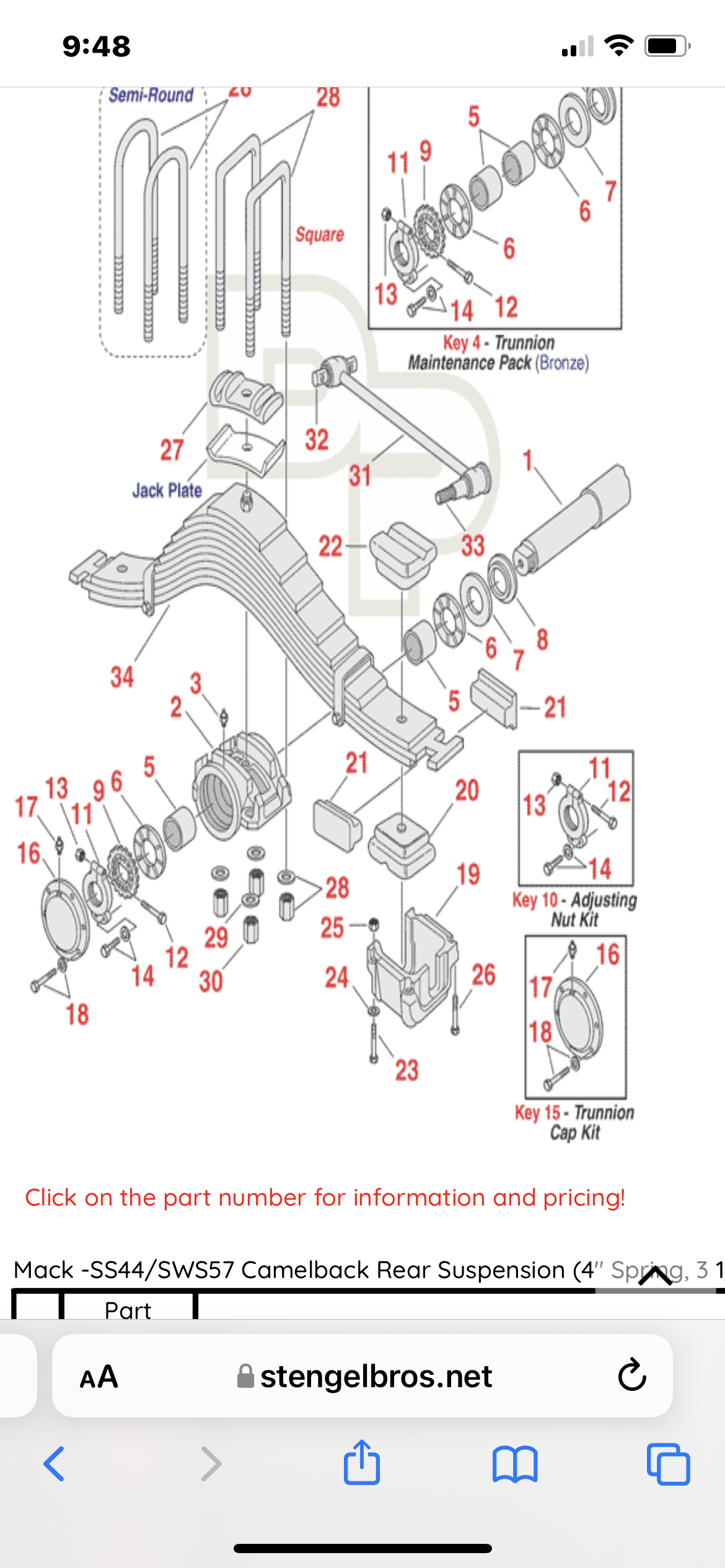

When I purchased this rd I knew the Trunnion needed replaced. I read where a lot of people had replaced their Trunnion with polyurethane. I was able to reach out to ATRO to see what was available for my truck. Jay at ATRO said they didn’t have a replacement for the bronze bushings and as far as he knew I would need to go with them. Has anybody here changed out bronze to polyurethane and if so what company did you use. Rear suspension is 44,000

There is no such thing as polyurethane bushings to replace bronze,you have that confused with the pads,just a heads up if your bronze bushings are completely worn thru,u will most likely need to replace the bar and the saddles or it won’t be 100 percent,big expensive job,are u thinking of doing this yourself,I would not advise it..
I second what MACKs says about the trunnion bushings, if it is bronze and really walking out, trunnion tube is probably gone too!    terry:MackLogo:

Yes that’s correct,only bronze,once u get it apart and inspect the bushings if there worn all the way thru then the bar and the saddle will have wear since they were contacting each other,new saddles come with the bushings already pressed in,you might want to check out Stengel bros on line and u can price every thing out,I think they have the best prices ..

To check,back the truck up while turning hard one way and then the other look to see if the wheel are moving out of line,they should stay perfectly straight or you can jack it up under the trunnion bar on one side and get a big bar in between the spring and the frame rail and pry it outward to check for movement..

if he's unsure of the process ; couldn't  he just take off the end cap (which has to come off anyway at some point), remove nut and hardware  . clean off hopefully some grease and see the gap between bushing and tube ?

He could do that,I just think he should check the actual movement of the springs,see how much the rears are walking out,if it’s just slight he could just keep on hauling.

macks so I understand your process place jack under say drivers trunion. Jack up till both sets of tires are off the ground? Then wedge big bar between springs and frame and check for movement.

Yes but if your seeing the rears walking out bad no sense might as well rebuild it if u have the bucks to do it right..
So not to go against the grain here, but if you would like to do the job and you have a knowledgeable guy to help you I’d say go for it. Only if you don’t need a trunnion stand and If you plan on doing springs too. You can get the whole spring assembly already put together and u bolts already torqued. Basically slide it on and put the few pieces on the shaft.
I bet he can rattle the box rubbers by hand, and i like the idea of taking the end cap off, as well as jacking up on the trunnion bar.  it would be good to have a helper run the jack while you look at the end of the trunnion.  I have used a company call Carolina axle surgeons... I think you can just go to the 'web' and look up axle surgeons near you, and one will pop up.. the last one I had done was a few years ago, and it was $1500.00 parts and labor. all you have to do is remove the wheels and the springs and leave stands under the frame rails. they will cut ou the old bar and weld in a new one..  Of course if the 'A frame' is rusted through,  well that changes everything..  Good luck Ricky.... jojo
You sorta need to know what you're looking at to determine how extensive a repair would be needed. There's a lot that can be worn on the suspension and when it's all worn ?  then there's lots of movement . Replacing a trunion stand is a huge job on a dump truck, even for a regular spring shop. You need to find a place familiar with Macks who could be honest with you about what needs to be replaced.  (lol)  lots of guys like to think the rubber pads at the end of the springs cure everything. Maybe a new torque rod too,  cause they're the cheapest component.....it's usually not the rubber pads or as simple as a torque rod .  Just say'n.   Worst case the repair easily reach 5 figures on a dump truck.

That’s the truth,and the reason I say if in doubt go with all new parts but I forgot the trunnion bar is not removable like on the 58, that could be a real cost factor if it’s shot..

I have looked the springs over and not one is broke. Do they need replaced? If not then I’m going to assume everything from saddle back to cover gets replaced. On Insulators ATRO makes a kit that has all the bolts and pads. Should be good there.  I’m paying the guy helping me but he is also a friend. He will be out of pocket for a few weeks but we should get this down last week in March.

That would be the way to go if u got the bucks to throw at it, take it apart and see what the bar looks like,you’ll have to measure it and see if it’s within spec or at least close..
