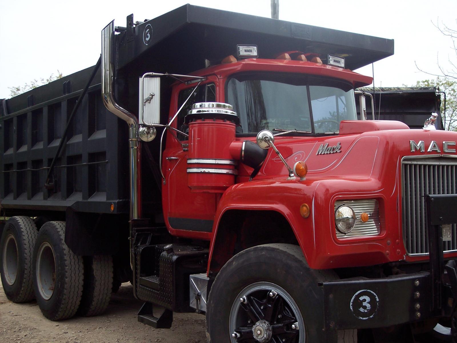

A little off topic but this thread has got me thinking,I sold this 83 RD about ten years ago for ten grand,could probably get 30 for it today,it was in amazing shape,even the rails looked almost new with zero rust..ok carry on..lol
  • 0
2 hours ago, MACKS said:
Same as any tranny with a side mount pto,the splitter or in this case the hi lo stick goes in neutral and the main box in fourth or fifth..
You're  such a tease 😍
