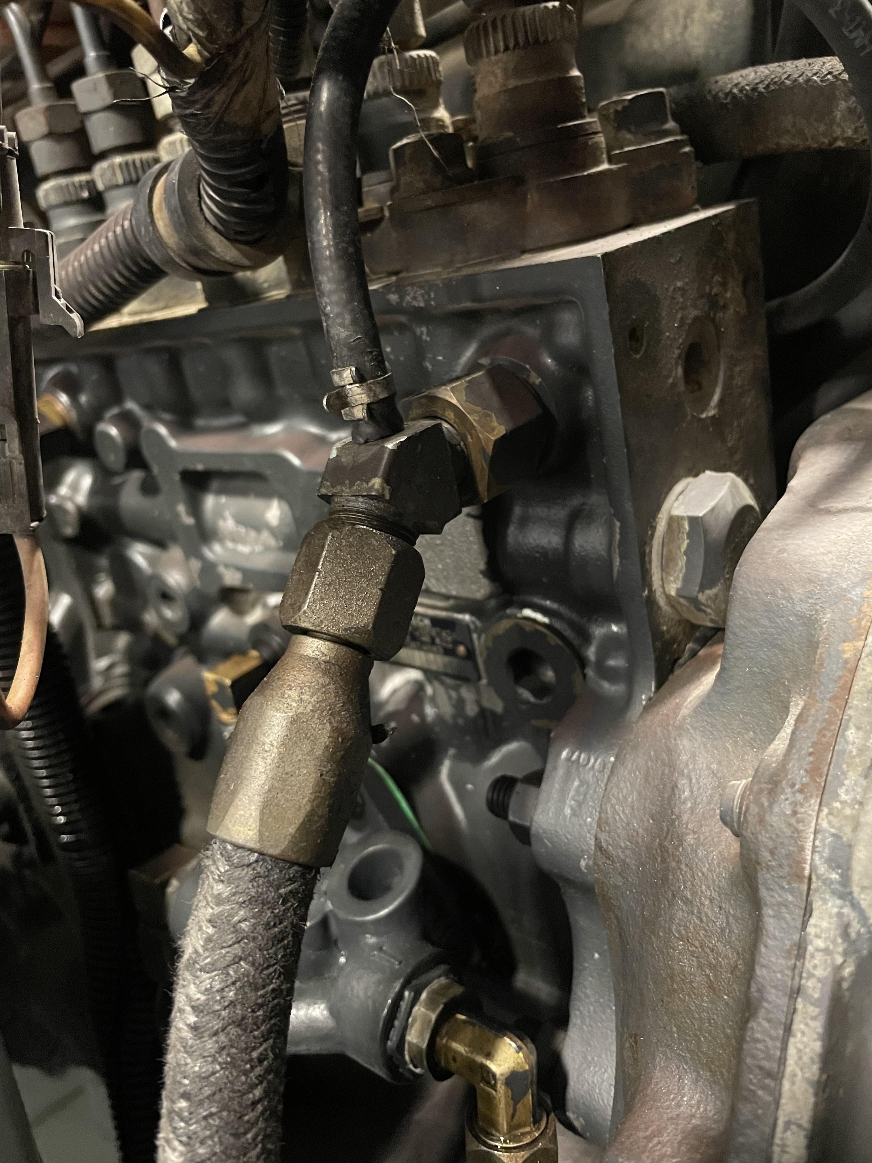

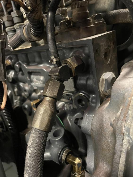

that is a manual pump and that drainback system is what was normally used on VMAC pumps how ever doesnt mean it can't be used on the manual pump! The T style is what I would think should have been on there!

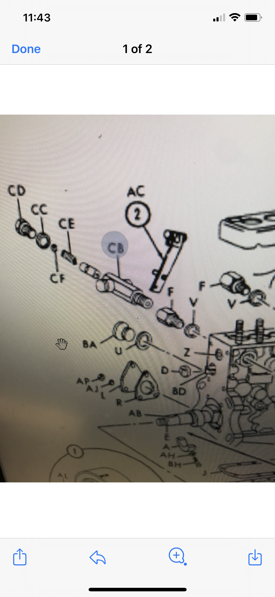

I called Mack earlier and asked them about the return side fittings. I could tell me and him were describing something different so I asked for a diagram of the pump. A transplant like you mentioned would make sense because according to my serial number it shows in the diagram it should have and overflow valve plumbed in coming out of the injection pump. I guess possibly someone removed it or this motor did not come in this truck and has a different return system on it. In the diagram (cb) is called an overflow valve. AA67BF8A-CC1D-4517-BAD3-621EF8F91DD7.thumb.png.72ed8248b1060389b58adabcd0624fde.png
What is the model and last 6 of the VIN, i will ck and see what it came out with.  If your only complaint is the lag, I seen truck with that fuel pressure give no problem if it dont go lower under a load.  If you want it to get rid of the lag, you need to ck the line and diaphgram I talked about in an earlier post.  If it is OK I  would pull the plug on top of the governor and you can adjust the pick up when you mash the pedal, it will get rid of the lag.   it will give the fuel faster, but will put out a little bit of smoke.
Vin# 037403…thanks
1 minute ago, br549 said:
Truck built 2/24/98 E-7350 Mechanical engine   1996 EPA
So, what’s there is possibly original it sounds like. I did notice the tag on valve cover said 1998.. I just removed that plastic line on intake that goes to diaphragm and sucked hard on it and it held a vacuum. Someone mentioned a different gauge so I guess I will check that too. That is a Matco gauge I’ve had for years but won’t hurt to eliminate that. Under load with boost pressure the fuel drops to almost 10 pounds according to the gauge I have on it. I just wonder why according to the diagram that Mack sent it appears to be missing that over flow valve?
By the picture it also shows it came out with to fitting with a small pin hole in it from factory, not the old style over flow valve in the picture the sent you.  We have also seen the plastic tubing that goes to the intake mainfold have a pin hole in it, we would pressure check the tube and diagphram together.  Like I said if TURBO LAG is the only problem pull the allen head plug on top of the governor and there is a cog wheel like a brake adjuster in there, I think you turn the cog wheel toward you from the side and you can get rid of the lag, we would turn the wheel a few cogs and test drive down the road and if not enough pull over and adjust more till we got what we wanted, just a small amount of smoke and quick pickup.  I will say no more.  Good Luck

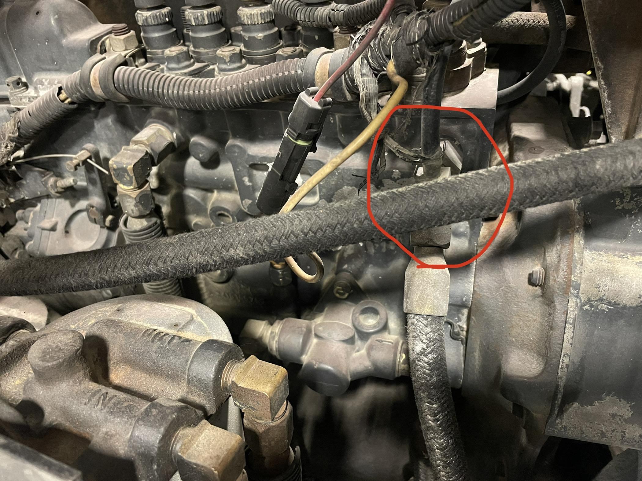

Got under truck this afternoon to try to find the marks on flywheel and pointer. The only think I saw was a part of bell housing that protrudes into the inspection hole. It would be a hole that possibly you look through but it had a metal plug in it and didn’t seem like it was going to come out very easily. But, maybe that’s not even the right thing?
