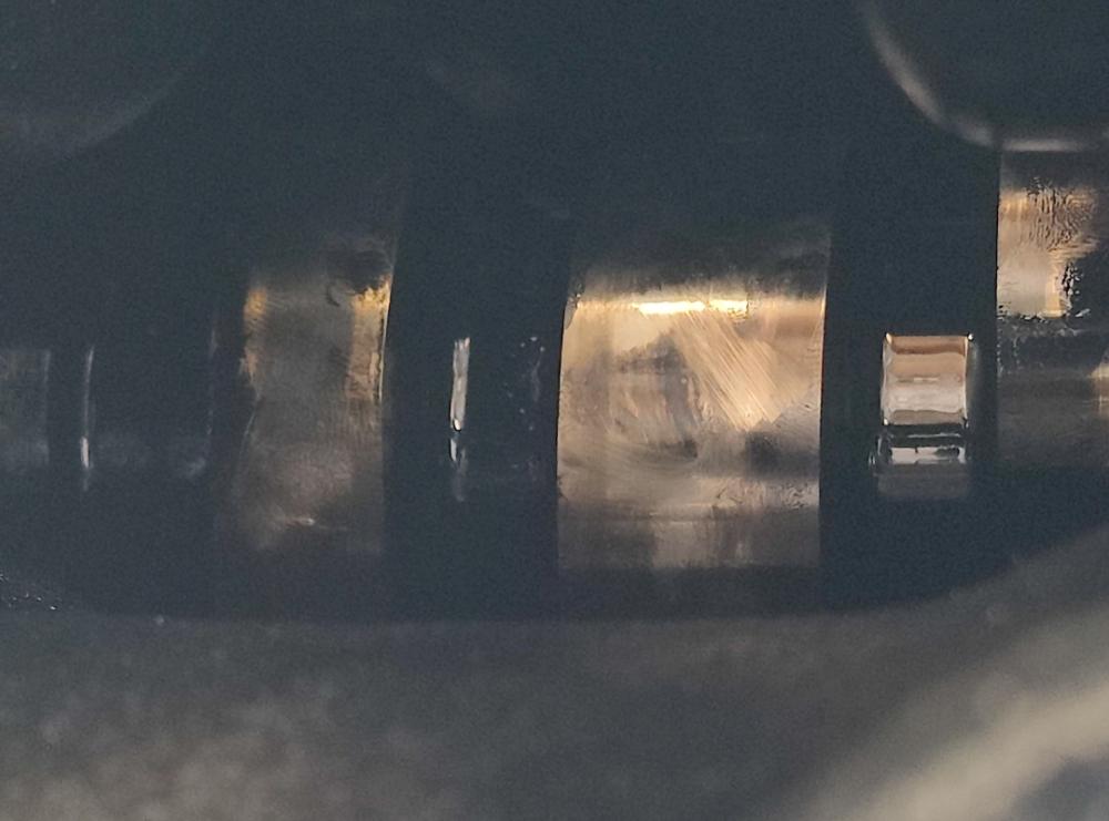

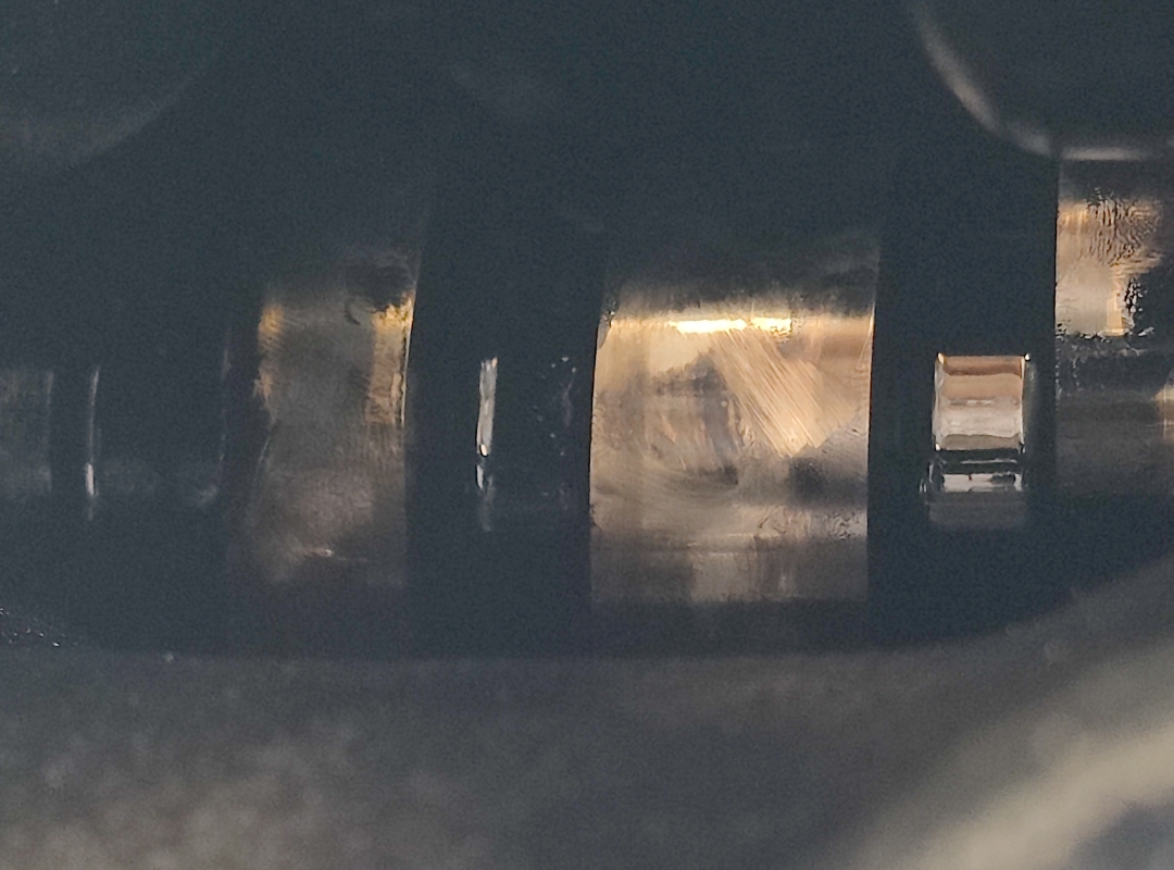

Okay, so I have the oil pan off right now as I'm typing this post. Camshaft lobe for the number four exhaust valve is good. I reached and felt the lifter roller and it is also good. Now I'm baffled because this valve is the only one that always needs to be adjusted. I will take a picture of the cam lobe and post it and see what you guys think.

I didn’t follow this thread how ever ! Came in at the end here To me that cam looks pretty hammered so I think it’s odvious having to set for the wear would account  for  the setting  if that’s what he did! I can remember doing these chasing ticks and mostly chirps   ! Doing a set only if I was asked to! These engines from what I saw held there set well if there was a gooffy valve setting especially on only one cyl something is likely going sideways down town.

Well this one is a real Head scratcher.no chunks on magnet or bottom of pan.my next step is to remove the pushrod and inspect it.i couldn't do it today because I don't have new rocker shaft bolts.didnt want to remove them and re use the old ones.. Joey I would never be insulted sir.im come to this site to learn and it would be foolish of me not to listen to learned people such as you , fjh,mackpro and many others that have given good advice over the years of me being a part of this forum.
With that said lol.i do know how to set valve lash .cam lobe looks great with no pitting or noticeable wear indentation...I removed the valve yoke so I could push lifter up and I rolled it with my finger and it's doesn't have a flat spot or broken..I figured as long as this issue has been ongoing something might have f-up already..I'll keep you all posted on the progress...as of now I don't see the point of throwing a cam at it before I figure it out .thanks to all for the help.

Steeler maybe on to it here With the bolt thing as mentioned above!  Years ago E6 era ran across a push rod wear issue on e6 wear the rocker gald and dried up wearing the push tube socket ! Causing similar symptoms to a lifter failure  maybe it is this kind of scenario!  cant rule out a crack in a rocker shaft either like Steeler mentioned ! again We have very few non brake engines here I personally worked on maybe 3 all were in MR Models ! So just speculation on My part the cam pic above kind of threw me as it doesn't look that great to me but if the lobe looks and feels ok then it likley is ! The other scenario I can think of is a displaced H ring and at time of set it was off by a bit and then its some how tracking OK by its self! Duno just speculating now!
