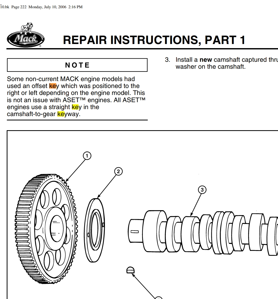

I figured as much .just wanted a second opinion.i have seen you mentioned Atl before and since then I've been checking out their website...only thing I need is the part number of the ac cam ..will be getting rid of the ami exhaust bump..is has been talked about in the "dead dog remediation"post but I haven't seen a concrete answer on the subject yet as to what part number...my buddy has a 2004 sfa ch with a AC 427hp rating..been thinking of using his vin to find cam that way too . please advice.
Why steel lifters over the ceramic?
as far as lifter's.. its just my opinion..  I really dont have a good answer..  I just like steel over ceramic, but I have seen ceramic run for a long time. the one I am currently building is 11 years old and the ceramic lifters did not fail..  truth is, with ceramic lifters, I dont like loading the cam in the block, in chassis.  I would rather have it on a rotating stand so i can tip it upside down..  :) i think using the other VIN is a good idea..  make sure you know what cam key is used. it may be straight but ,,, be sure...  white side out for the 427/460hp.. if its offset..   jojo
