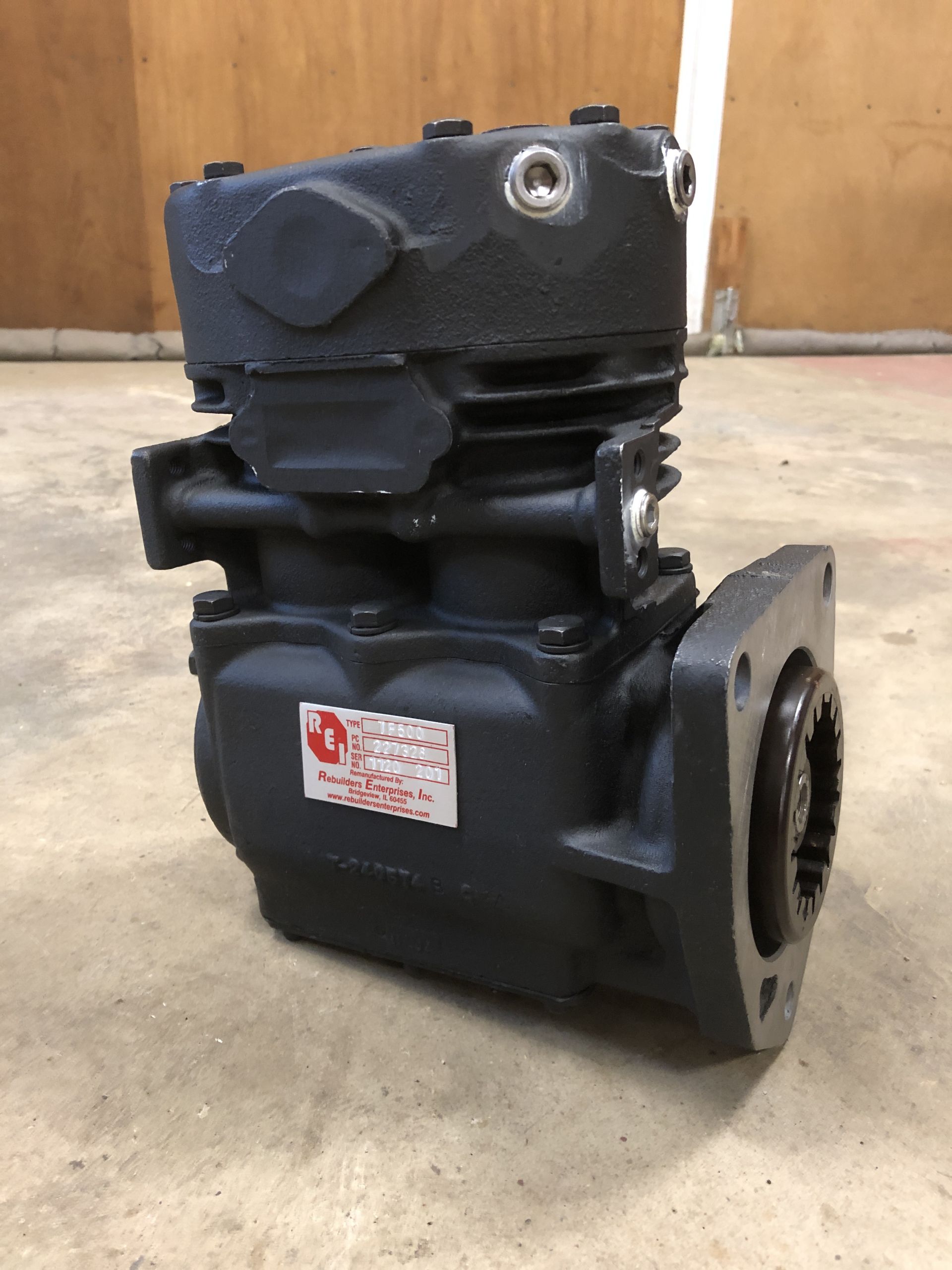

My truck has a Tu-Flo 500, I googled the part number (227326) from the tag and found highwayandheavyparts.com had one reman for $480 plus core charge so I bought it. I found one at a Mack dealer also, believe it's a new one but they wanted $1,000 for it. I got the gaskets from Barry and a water pump from John Chalmers.
