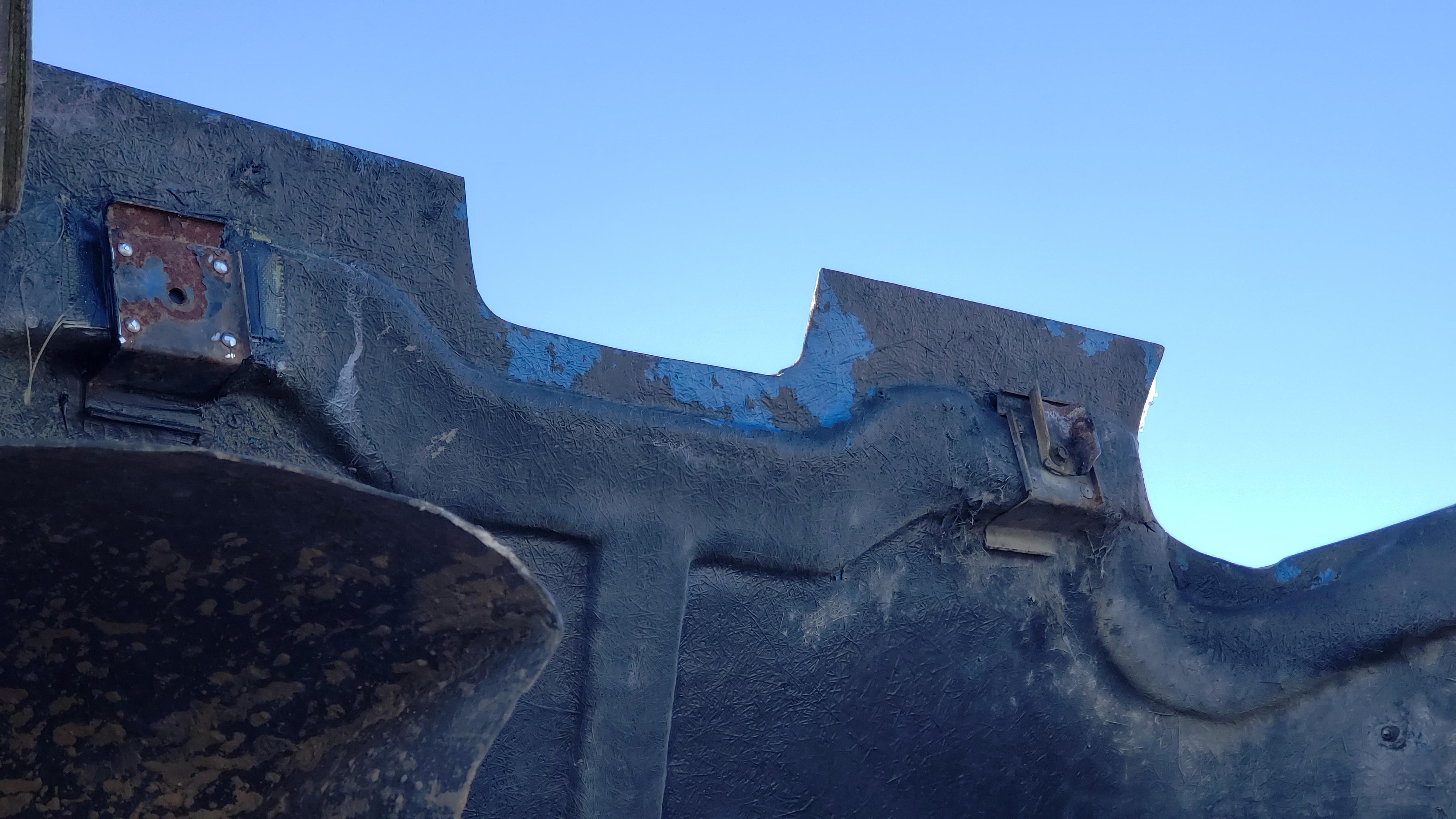

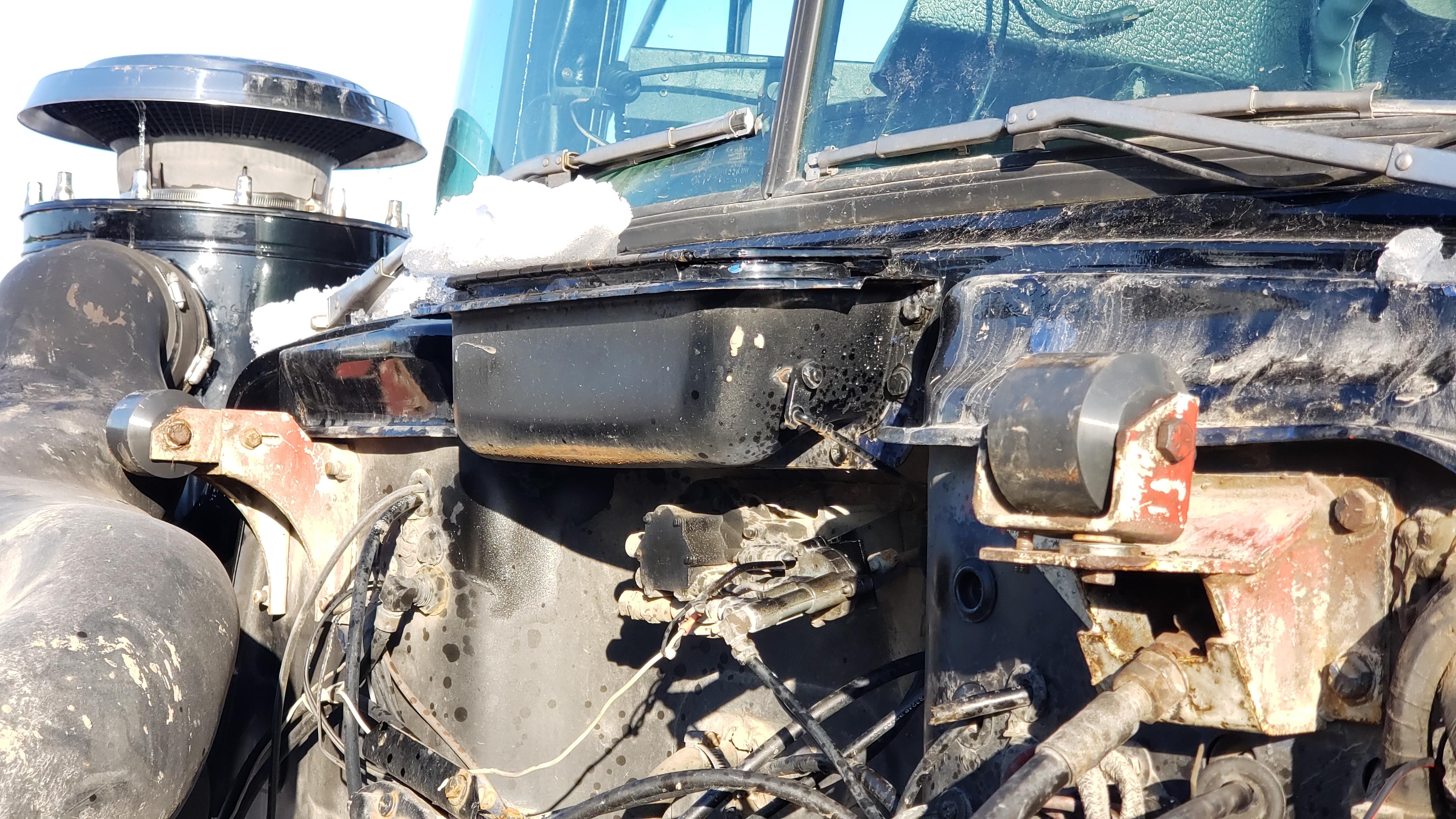

Years ago I put a superliner cab air suspension on my truck. during the upgrade i also put R model hood rollers on the cowl. the issue is the driver side of the hood does not make contact with the roller. I raised the rollers 1/2", moved them forward but its still resting the cowl. im wondering if i am missing a part?
anyone have a pic of a western mack with the hood / roller assembly?

I don't have a photo Trent but the pads that mount on the underside of the hood are different for the rollers to bear against with air ride.
This is two pieces the first piece bolts to the hood through the center of the bracket you have, I think the bolt is 3/8" fine tread, then the channel shaped piece attaches to it with two screws and nuts
The parts are NLA trough Mack but it looks like PAI now has them

(driverside) I have the plate that bolts to the hood but not that channel.  where can i find a current Pai catalog. i thought i need to be a distributor to access their online parts. thats what i was told years ago.

The plate you have is the one that is riveted to the hood. Make shore the rivets are good and use the correct ones if you have to replace them. McMaster Carr has the rivets for the fiberglass
You just need to register on the PAI website and you will get an email with your password and then you can log in and view/print the catalog pages
yep i ordered new rollers last week and fitted them yesterday hopeful it would fix the hood rest issues but I suspect i need that channel attached to the plate. previously that plate had a large rubber puck bolted to it. i removed the puck thinking the new rollers would make contact on the plate but they dont.
That explains why your hood looks like it is setup for the fixed cab
The passenger side channel is for the fixed cab, I actually need one of those
You will need two of the channels and two spacers

got a assembly on Ebay tonight. need to source one more.. i also got set up on pai... great to see so many aftermarket parts available since Volvo is of little help these days
Thanks to everyone for the help with this. I also need to give thanks to Josh Yoos as he explained how he converted many of his trucks to Air ride cab.
For those who are looking to do this conversion here is what worked for me.
I unbolted the old solid mount hood rests from the fire wall and replaced with R model hood Roller brackets that bolted right up to the same location on the firewall. I then installed these parts on the Hood. they were direct bolt on after the old solid mount pads were removed.
Hood Roller #55MX26
Hood Bracket #140QM213
Hood plate #140QM212
