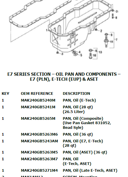

Would anyone know of a place I could get a deal on an aftermarket or OEM replacement oil Pan. Bottom of pan is completely rusting out, very porous, to thin to weld and will only keep getting worse. Are these pans from dealer really about $2000.00?. Dealer won't give out part number so if anyone has access to that would be appreciated.

Fjh,
MAK240GB5271M4 would this be the part number for the oil pan I'm looking for?
Thanks for all the advice gents!
Really need to know the capacity of the current oil pan. There are several available.

2 hours ago, Tim Modine said:
Fjh,
Believe so! ! 38 litre pan! BRO  if your pan has a dipstick on the side Be sure to ask If their new pan is equipped! if your ordering!
