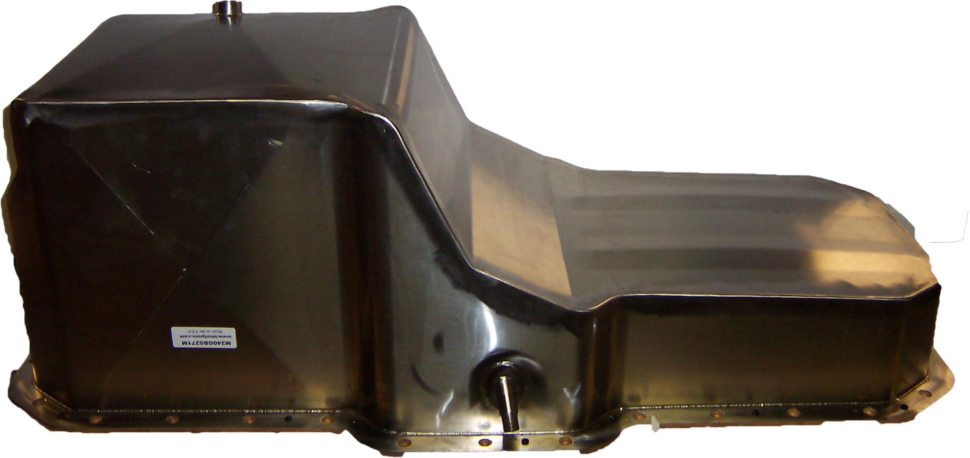

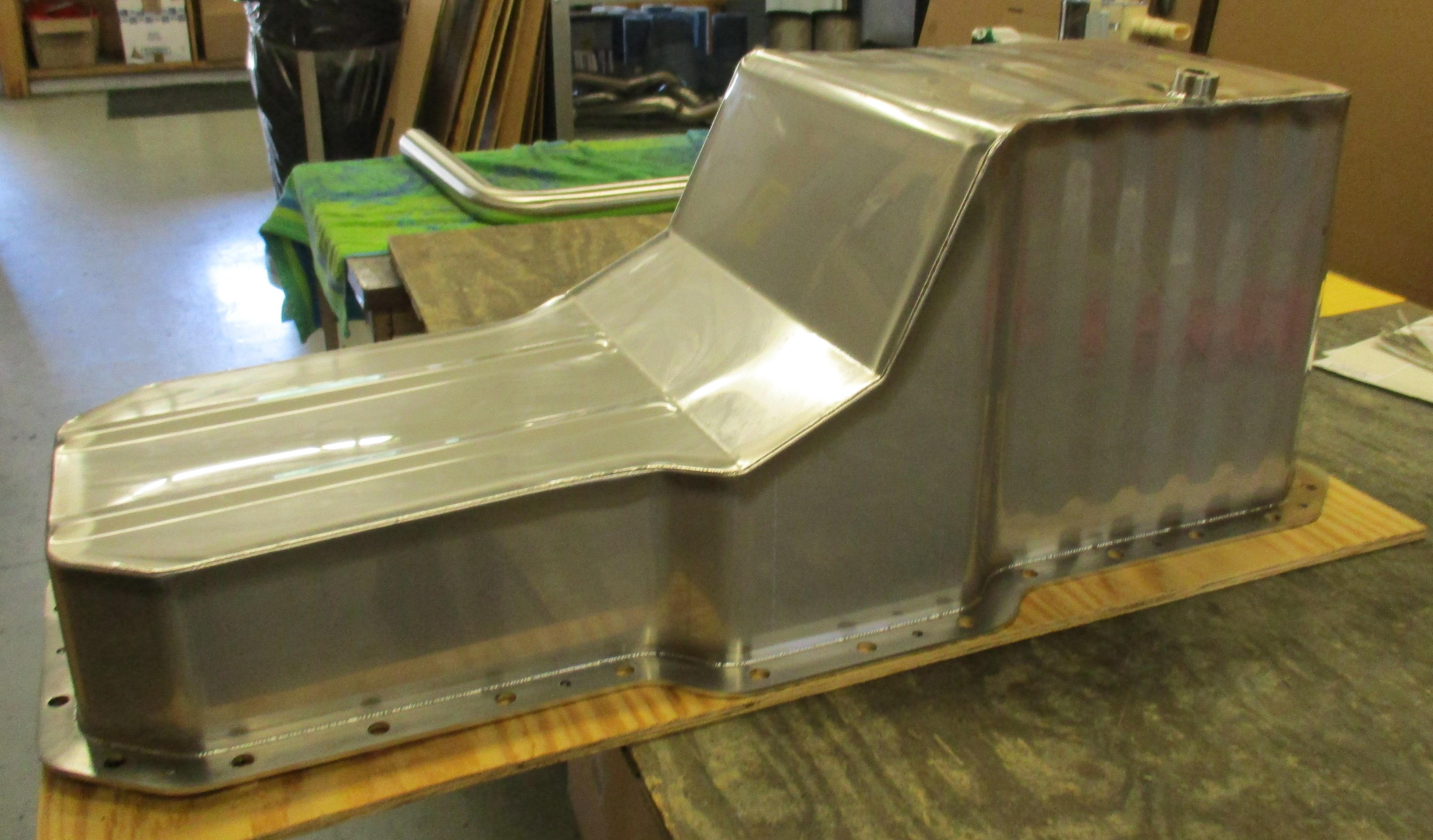

  6. Ordered a pan from BH Oil pans. Should have the end of this week, under $1600 shipped 304 stainless,14 gauge sides and bottom and 3/16 flanges with with all mounting hardware and gasket. I'll post pics and a short review once received .
  7. I had my dealer check the oil capacity of my original OEM pan and they said 55 quarts. Exactly what the BH oil pan is rated for to replace my factory OEM rusted out junk. I’m ordering through them since they are closer to me logistically. I’m in NY they’re in PA.
  8. Another place that fabricates them for same price and same materials is snodepot in Madison SD. I’ll post pics of real thing once received. Thanks again for everyone’s input!
  9. I’m going to order one. They have none in stock. Takes a week to build and ship. As son as I get pics from them or mine gets to me. I’ll post pics on how they ship em finished before I install. They also said any heating probes or sensor holes they will put holes in no charge.
  10. 3/16 flanges and 14 gauge 304 ss sides and bottom from bh oil pans. I asked them to send pics of a finished one before shipping to see quality
  11. BH oil pans in PA for my replacement oil pan using oem part # quoted me $1600 for a pan and all mounting hardware made out of 304 stainless.
  12. Fjh my oem part # is 240GB5271M2. I think it’s 55 qts

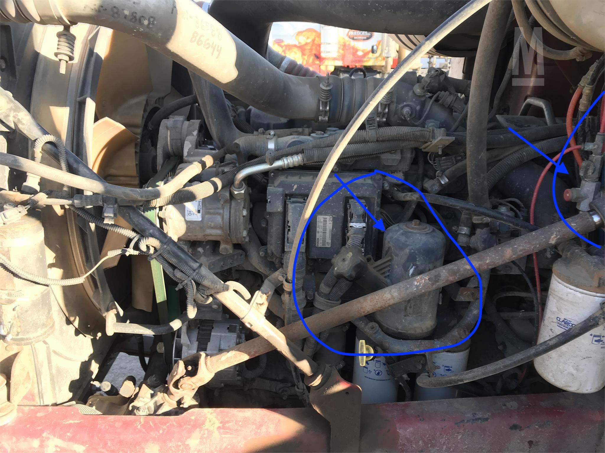

  18. Pic of canister where eng oil goes in and where i get like an impeller winding noise on shutdown. Other pic is of a valve that goes to the coalescing filter, and does anyone know what the purpose of the valve is for? Image isn't my engine, its just used to reference for questions. Thanks again if anyone has some information Tim Modine
