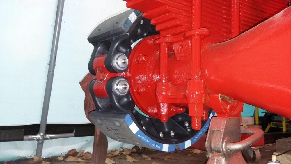

Hi Dave, Did you try Air Brake in Moosic on RT.11 by RT.502? They have been a great help on my B67 project. They did a nice job on my rear brake reline. Told me when the time came to do the clutch they could take care of that also. Can you give me the name of the man who helped you at Diesel Power? I'm having a problem with the V8 in my R795 lurching badly if your not completely on the fuel or totally off the fuel. There's no in between. Had a guy at the Harford show tell me it sounded like a governor problem?

Tom out to that injection place there is a woman at the counter and I think just the one guy I never got his name. If you call at about 4:30 I got the guy and he was good to talk to he didn't talk down to me. the phone number is 800-326-9785. I have bought parts off airbrake in the past but them and heavy duty parts always slip my memory. I see in you picture the shoes are bolt on back in the day I got pad kits from McGeorge's and you had to bolt them on the bolts were brass bolts.
