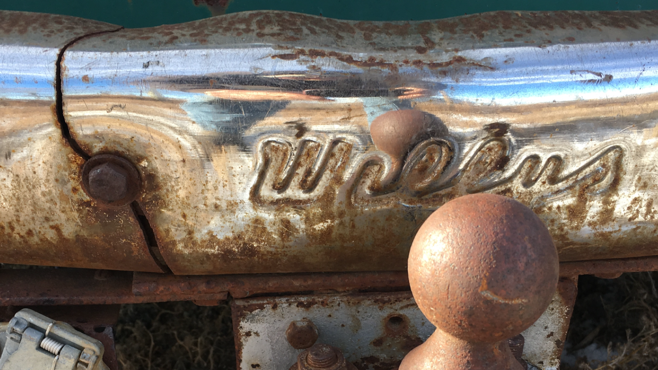

That's one of the videos I watched. I'm guessing there is no way to get around actually rechroming something other than actually rechroming it. That willys wagon has a really cool chrome 3 piece rear bumper that has willys stamped in it but it's broken. I can weld it but it would look bad missing the patina chrome on it.
Weld it with Stainless rod or wire, you can pretty much blend it in when you file it down and work up the sand paper grit to about 400.
If I welded it should I grind back some of the chrome when cleaning it up to weld or just weld over the chrome?
If you use stainless rod or wire you can leave the chrome alone, just clean the rust edges and a slight Vee the back and do a segmented weld in 1/2 inch runs with low heat generation and allow to cool completely between welds. Weld from each end on the front first. Than flip and run a stitch weld on the back on the back. The weld wire and rod are both high Chromium content so will bled with the chrome plate well.
Stick rod use  308L 16 for AC welder   308L 15 for DC welder (better results)       expensive  per rod cost if you don't shop around
MIG use ER309 SL .035 wire  with minimum of 25/75 gas.
Crown Wire makes a 2lb spool for under $25.00
