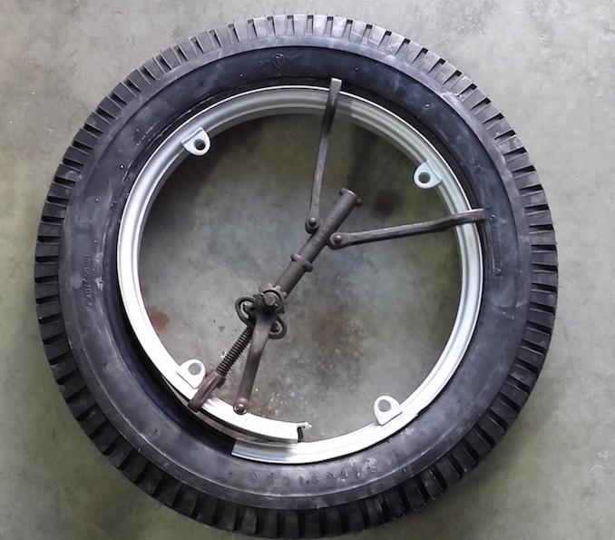

Mack wheel rims on a 31 Peter Pirsch ?
The Waukesha (WI) Fire Dept. was given a pumper that  was sold back in the 70s.  The dept. bought
a set of tires for it assuming that a local tire dealer could install them on the cast iron rims.  Not kosher to assume.
The tire store has struck out.  I will try to forward a detailed picture of the Peter Pirsch taken in the early 1950s.
If the rims are in fact Mack, instructions would be appreciated.  If they are not Mack, instructions would still
be appreciated.

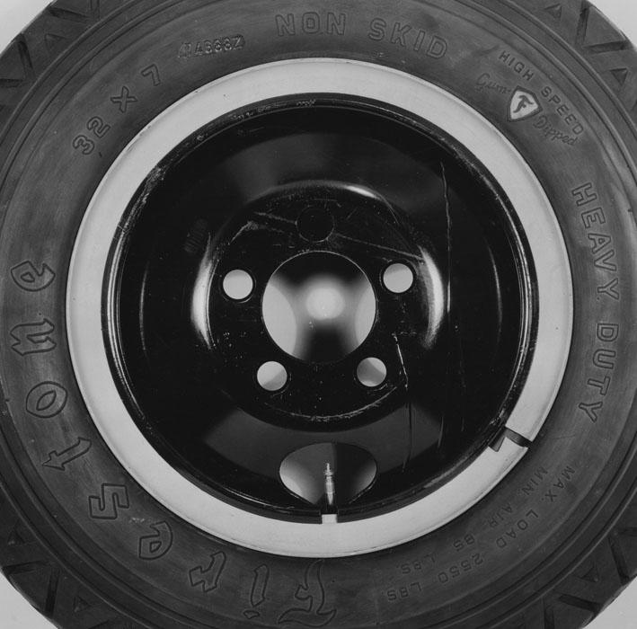

The rims are Sterling from about 1928 or so. Pirsch used Sterling and International for some parts around 1930 and later.    A better close up photo of the rim would help.  Paul

At that time the rims and spiders could have been manufactured by Good Year, Budd or a few others. The early ones a extremely dangerous and WILL easily kill or maim you if you don't  1) have the knowledge and 2) the proper tools. They don't call those rims Widow Makers for nothing.

They are the 1930's style split rims with the wheel split for valve stem / tube and a lock ring  or the other Firestone style with a split rim you need to "latch" in the tire  Not the modern split rims.
