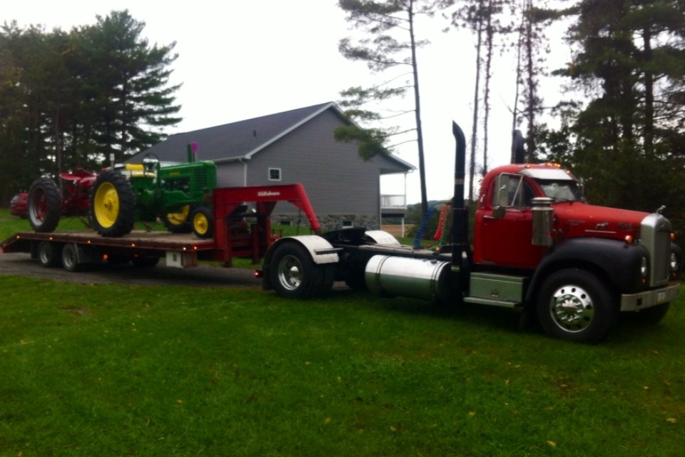

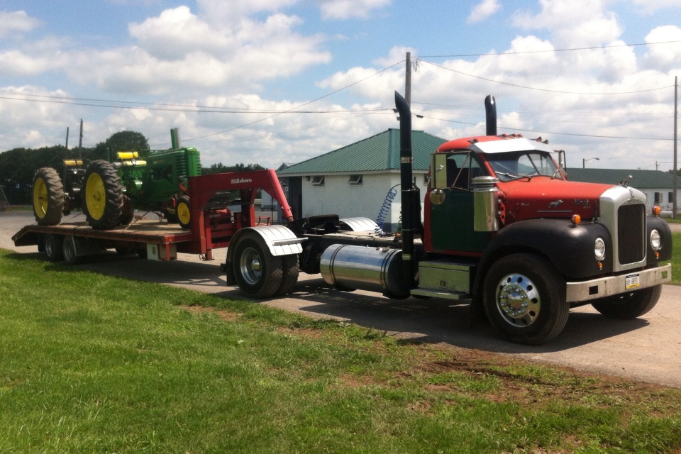

image.jpg.326cad073eb9da8ebc019664febad9e5.jpgimage.jpg.dd730fe02e7ac0f4401b953a0a924037.jpgI do the same thing.  Mine started out as a b-67 short wheelbase single axle.  I cut everything off the back and left about 4' of bare frame.  Then slid a set of freightliner frame rails with a single axle air ride setup right over it.   I drilled and bolted through 3cross members,   fuel tank brackets, and a toolbox mount.    The truck drives and rides very nice.   It handles the weight much better then my pickup, but in all reality my gass job pickup will out pull it on a hill load for load hands down.  Our one show is basically all flat but everywhere else I go is hills and it does slow down and I get a lot of shifting practice.  Mine still has the original non turbo 673 a 237 upgrade with the extra hp and torque would be a big plus!
The end result is, if possible for me (i have 2 kids) the mack goes over the pickup  just for the "cool factor".   Lots of heads turning, thumbs up, & cell phone pictures as we drive by.  Way cooler then my 2004 chevy!
There is a post on here of what I did.  I think it's called "finally time to assemble".   Or some thing close to that.      Good luck
