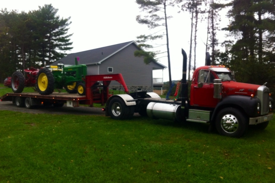

Hobert62
Nice is correct for that load.   Found its best to let my JD A ride facing forward because it seems that a high speeds when facing backwards the air going into the air stack pushed the oil out of the breather into places it shouldn't be.
Remember if it's got a hood it's no good!
