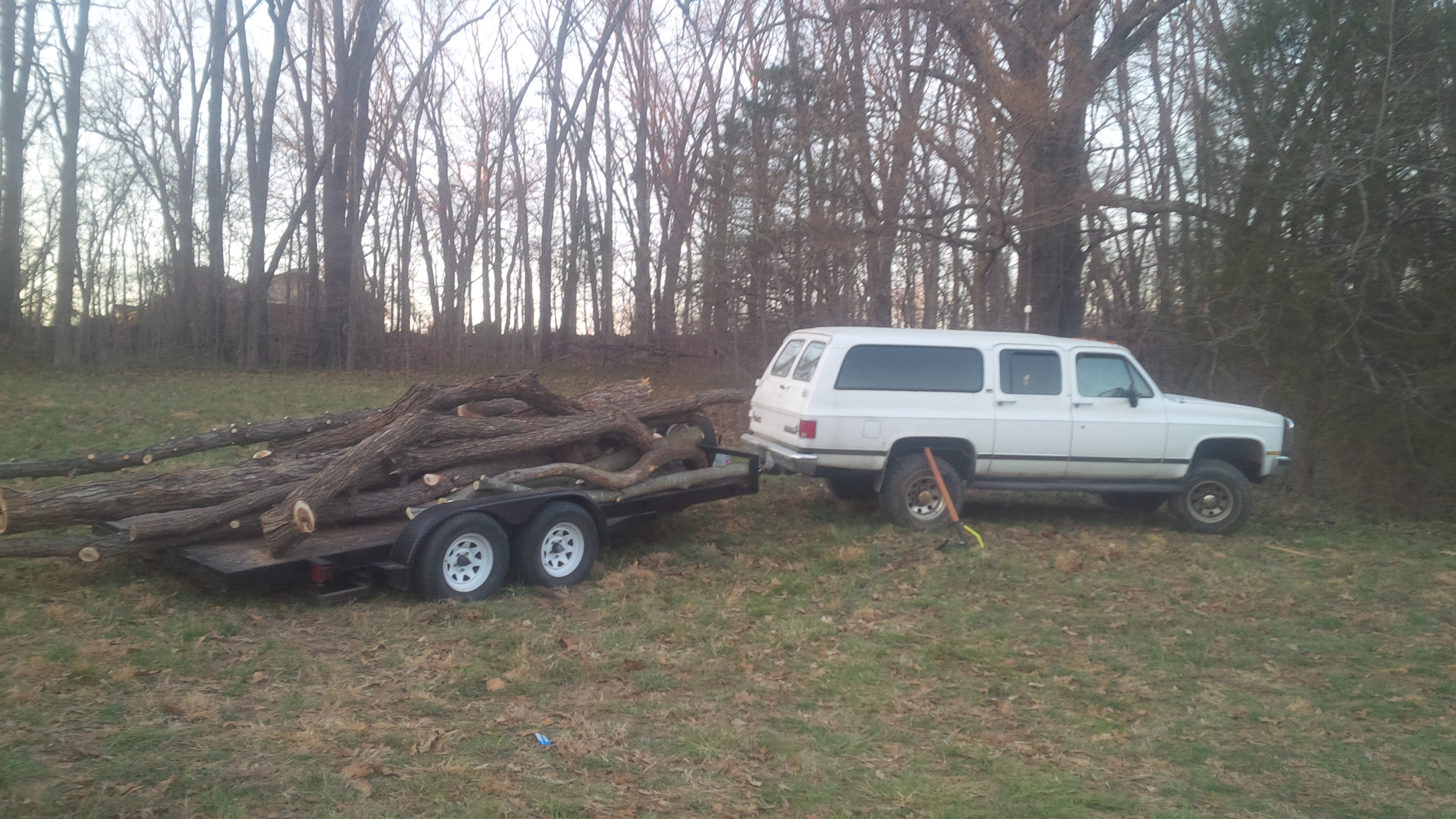

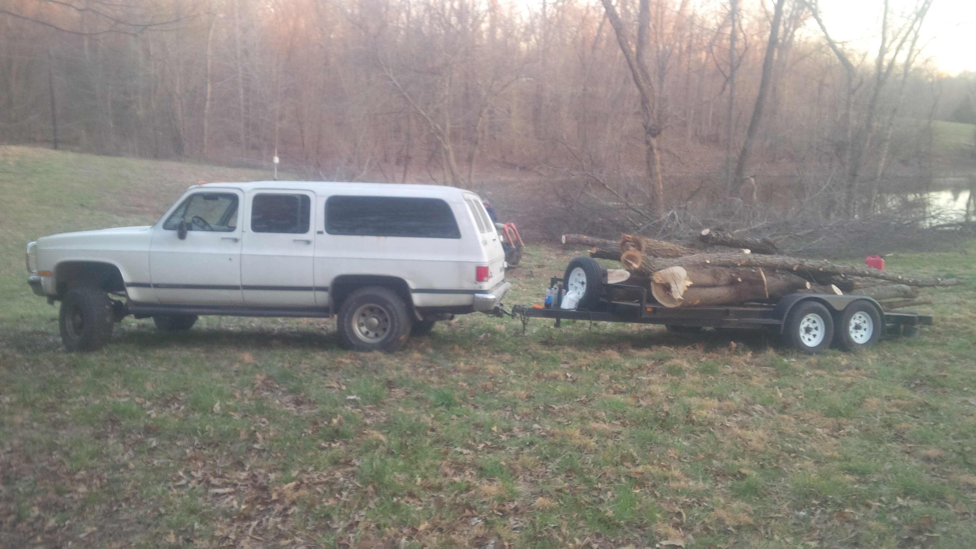

Ok, so day 2 had it out at the farm. On the way there I discovered that if you're sitting at a red light idling, then go straight to WOT, it stumbles pretty hard & ALMOST stalled...long enough for me to think "#?*@"...but when I let up on the throttle, it fired back off again, romp on it again and STILL beat the fool who was 3 cars back and had changed lanes into the open lane next to me through the intersection. It is MUCH quicker than it used to be...still a bit of a dog below about 2000-2500...but then it takes off. I have 2 shift programs in there..."economy" shifts at about 4K @ WOT, and "towing" is set for 5K. When it hits 2nd in the towing program, it hits hard and leaves that car that THOUGHT it was keeping up with you in the dust.
Yeah, I was beating the snot out of it yesterday, finding out what it would do, and trying to find any potential issues before the wife starts using it again as her daily driver. First 87 miles on the tank were with the old TBI, which was only getting us 6 mpg. I drove it around for another 123 miles with a very heavy foot, including some time on the farm delimbing some trees that had been cut, bucking them up into manageable size logs, loading them on a trailer, and taking them over to one of the barns to be cut to length and split for firewood. There's a small, gravel hill getting up to that barn, and I stopped. Started easing into the throttle and around 1625 rpm it started rolling forward. Got into it a little more, and at 1850 rpm it started spinning the tires. Hell, on Dec 17 (when the ignition module left us stuck on the side of the interstate in an ice storm),
Damn. Dallas/Boston saw a fight not 2 seconds after the puck dropped...
Anyway, as I was saying...back on the 17th of December, it didn't even want to spin the tires ON ICE! So, I'm pretty stoked about it spinning the tires on gravel with a tongue-heavy loaded trailer behind it.
But anyway, fueled up on my way home...210 miles on the tank and it took a hair over 29 gallons, which is about 7.25 mpg. Considering the first almost half of the miles were at about 6, and the second part were extremely heavy footed, I'd be surprised if we're not back into the 10's driving like we normally would. I was hoping for 12-14, and once we know exactly where we're at, I'll have a chat with the chip guy to see how we can tweak the programming. I don't like it hesitating and stumbling on a quick take-off, and has always been slow to return to idle when you rev it up in neutral. I just want to have a good idea on where it's at and what it needs before I have him tweak it.
Still can't wait until the wife and I have a day off together and we can hook the horse trailer up and load a couple horses to go for a ride off the farm...that'll be the real test. Right now, I'm happy though. It can hit 65-70 mph by the end of an up hill merge ramp from a stop at the bottom of the ramp. Used to be, we'd be on the interstate and have to crest the hill before it'd see 70.

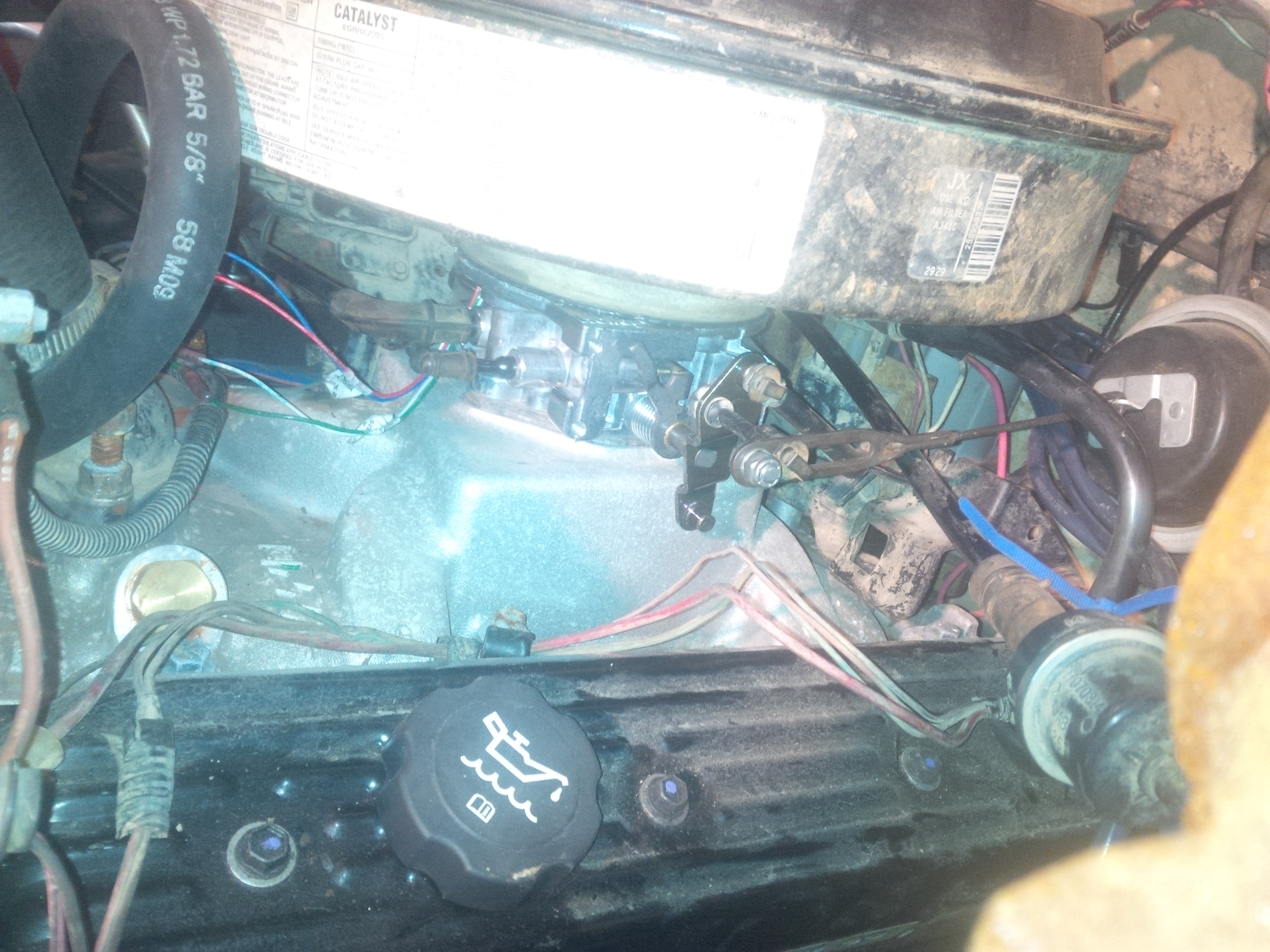

Well, starting to put together a list to place another order...Edelbrock Performer dual plane intake manifold, still a toss-up on the carburetor (leaning toward a Jet remanned 800 cfm stage 2 Quadrajet for light trucks), but also need a TPS to run the transmission controller. US Shift has some listed on their site, but none say they are specifically for the Quadrajet.  Then there's the distributor...thinking a Proform (officially licensed by GM) with mechanical and vacuum advance ought to do the trick...hoping to find one compatible with the hydraulic roller cam I have or at least uses the same size drive gear that I already have so I can just swap it over.
That right there ought to get it running a little better.  Also going to yank those silly long tube headers off and go back to OEM exhaust manifolds.  Thought about putting shorties on there, but from what I'm reading there isn't enough gain in power to justify paying twice as much as the OEM replacement manifolds.  Why? Because I want to get another Y-pipe (had to cut the one I bought into 100 pieces and weld it back together...and it's got a few leaks as a result).  Having a one-piece Y-pipe will eliminate 99% of the exhaust leaks on the truck.
Last up is fixing the driver's side window.  Probably going to order new glass, wing window, track, etc...got to be able to roll the window up and down without it jumping out of the track or getting stuck...otherwise, it'll be a very uncomfortable trip to Texas in a few months.
I'm really hoping these changes will get us up into the 12-14 mpg range I was hoping for with the new motor, because we WERE at 11.25 mpg before the swap to the Vortec heads.  Sitting at 7.75 mpg right now, and the sad thing is I can get that all day long out of the 460 in the F250 pulling the 4-horse gooseneck around.

Problem now is it's running stupid rich (so much so that it will occasionally continue running for a few seconds after you shut off the key), wasting a bunch of fuel.  That and the little 2bbl primative EFI isn't up to the task with the Vortec heads and free-flowing exhaust...so even if it wasn't running so rich, it is sucking air in through a straw and not living up to it's potential in the power dept.  800 cfm carburetor can be tuned...idle adjusted, needles and jets adjusted...not to mention having the ability to control the spark advance (which I think is set rather conservatively, because I told the chip maker I wanted to run the cheap gas...NOT the premium he "recommended".  To have that chip reprogrammed to fix the over-fueling/spark advance issues involves pulling the chip, mailing it to him, he takes another stab at it, mails it back to me, and 2 or 3 weeks later I get to see if it is a good change or not...and if not, repeat.  Who has time for that?  Carburetors and distributors can be tinkered with whenever I've got a few spare moments.  Once it's dialed in, it'll run better...like I said, the old worn out & inefficient 190 hp engine was giving us 11.25 mpg.  This one (with 1996-2000 intake) is rated 60-100 hp higher.  More power is usually more efficient, because you spend less time and effort getting going.  I was honestly expecting 12-14 mpg.  Dad had a '97 Chevy Express van, same engine (minus the cam), same transmission, 4.11 rears instead of the 3.73's, and 235/85R16 tires instead of the 285/75R16's we've got...and he was getting 14 mpg with that, so I know it CAN be done...just got to get it tuned right.

Got a big 'ol pile of parts sitting in the office waiting for tomorrow. Spent last weekend under the truck reworking the exhaust...ditched the long tube headers and put manifolds on...and the Y-pipe that was SUPPOSED to fit, didn't.  Couple cuts, couple welds, and we're good to go...not near as extreme as the modifications I needed to make to that pipe with the headers.  This weekend's job? Pull the manifold and replace with the Edelbrock dual plane, mount the Stage 2 Quadrajet (which I almost didn't get...Jegs is "vendor ship" and the vendor wasn't going to have any ready 'til the middle of next month.  Summit had 'em in stock, though, so cancelled the order w/ Jegs and placed it w/ Summit), and insert the new distributor.  I've got the adapter to go from the 3/8" ORB fuel supply line to the regulator, but won't have the 5/16" ORB adapter until the middle of next week.  Only other thing I'm missing is the pigtail for the electric choke...also on order.  By next weekend, it should be back up and running...hopefully with a little better fuel mileage and a lot more power.
Edited by RowdyRebel
Well, just finished the exhaust.  Had 3 welds on the Y-pipe to finish it up, as well as bending a piece of 1/2" rebar and welding it on for a hanger...then trim the remaining bit of old Y-pipe off the front of the catalytic converter so I could weld in a straight 3" piece to connect to the new Y.  Used a ball flange connector between the Y and the cat, so instead of the entire exhaust being 1 piece from the headers back to the tailpipe, I can disconnect it half way.  Anyway, this new set-up looks MUCH better...less bends, a ton less welds (even though I had to modify the Y-pipe...again...it isn't as severe as the old one).  Lots of zigs and zags are gone.  Both sides of the Y are approximately the same length, too...about 6" longer on the passenger side...and it gets to a single 3" about 2' closer to the engine and from there, it's a straight shot back through the cat & muffler.  Tailpipe bends over the axle and out the side, still.  Kind of funny, though.  Everything BEFORE the cat is brand new.  Most people put "cat back" systems on if they do any exhaust modifications.  Then again, when you're starting with a 3" Magnaflow cat and 3" 70 series Flowmaster muffler and Flowmaster's 3" tailpipe kit already on the vehicle, you don't really have to modify that, so perhaps I'm not as strange as it sounds...
Anyway, time to take it for a test drive to see if my Redneck Engineering fix solved the issue with the cruise control not working.  If it did and the cruise doesn't work after I swap in the carburetor, I'll know that without the computer, I won't have cruise.  If I DON'T find out if it's working before tearing into it, I'll always be wondering if I CAN fix it.  Not having it isn't really THAT big of a deal...but it'll be great if it works and STILL works after I get done.
